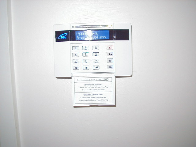

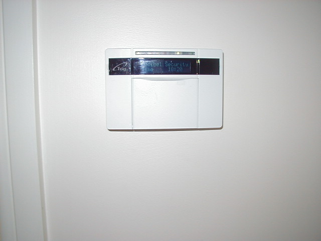

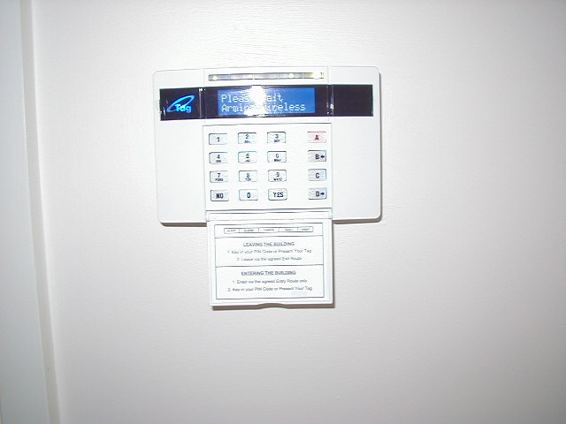

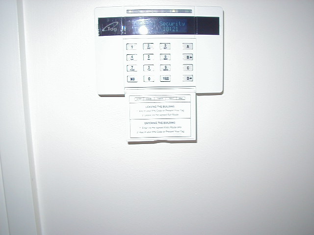

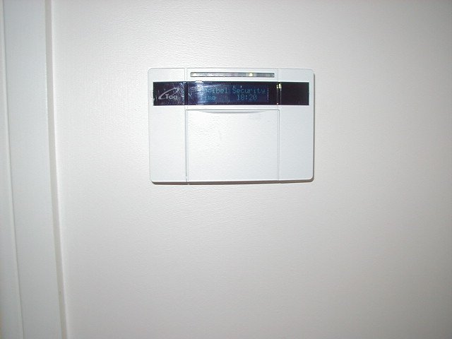

Just moved in and there's a existing alarm - I think Pyronix though no manufacturer name on the unit. Seller left me some tags, which work to turn it on/off, together with a note of the code and installer code.
I have no wifi yet, so should it still set off the external alarm?
If I want to change the code, is it possible and where do I find instructions?
You will need to ascertain the model so that you can find a user guide

Control panel could be pyronix 46s or Enforcer with remote keypad.
Changing code is same function for both models
You need to confirm if system has wifi connection as both panels can work without.

It looks like the 46s so thanks for IDing that.
