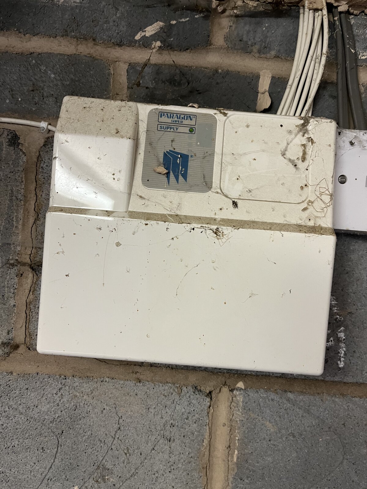

I have recently bought a house that I am renovating to move into. There is a Pyronix Paragon Super alarm system installed.
I do not have any codes, and cannot contact the seller for them.
I have downloaded the annual and have tried using the standard user code (5678), master code (1234) and engineer code (9999) but none of them seem to register on the alarm, so I assume they were changed at some point.
Does anyone have any advice as to how I can reset the alarm codes back to the factory ones?
As I do not know any of the codes, if I open the RKP pad or the alarm box the whole internal and external alarm system goes off for a while as it thinks it’s being ‘tampered with’. I can’t stop this manually without knowing the codes. (It’s now flashing alarm and tamper too in red since I set it off).

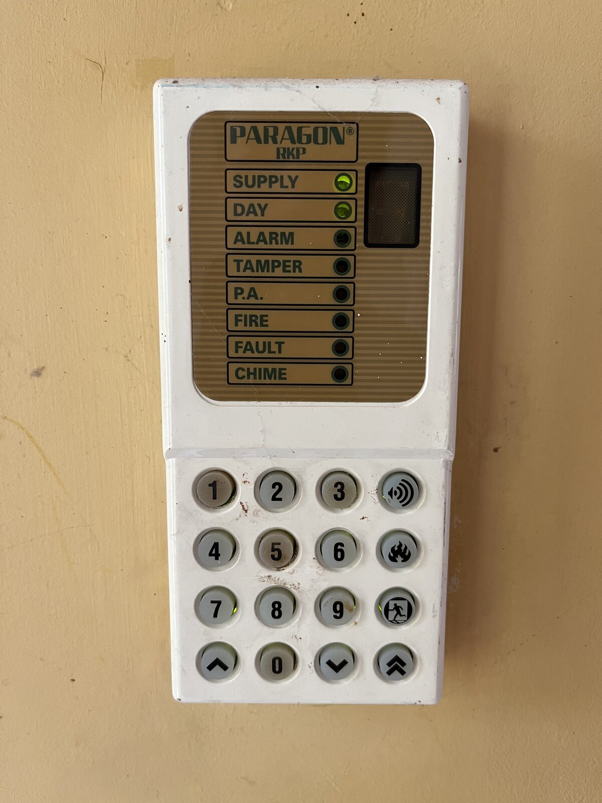

I’ve added some pictures in the hope someone can help!
You can see on the keypad that the numbers 1,3,5,0 are dirtier so I assume the code is made up of these digits… but who knows!

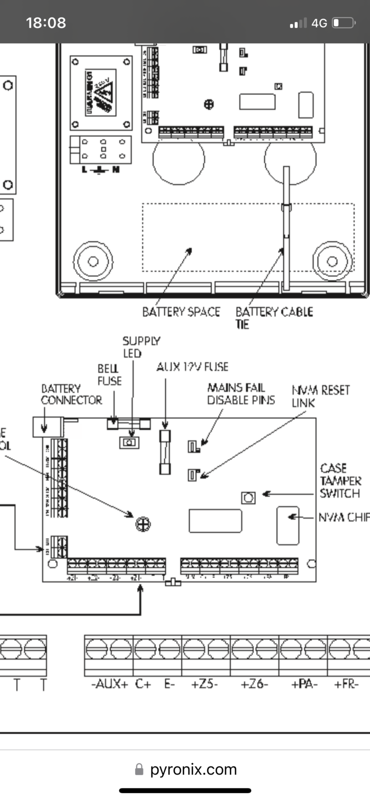

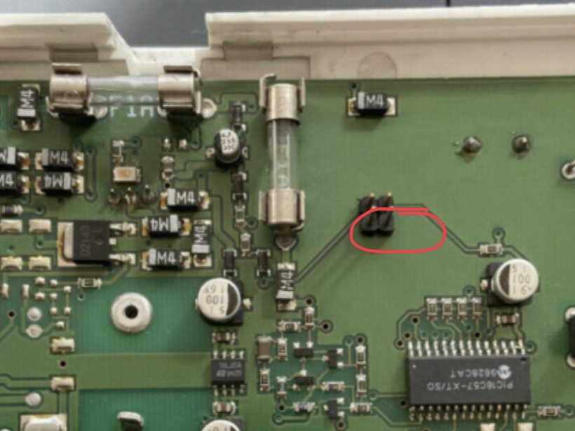

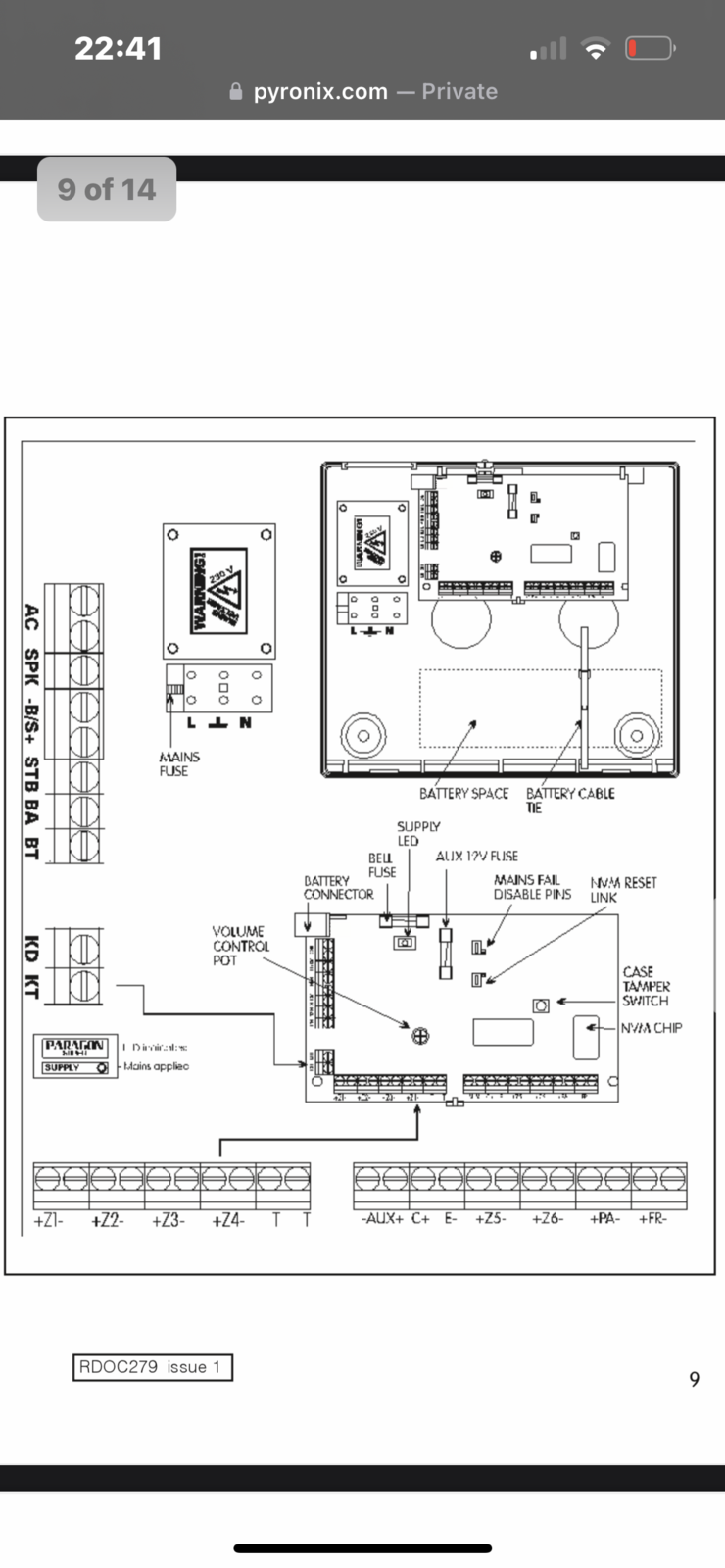

Where are the NVM pins on this pcb? The manual diagram shows separate mains fail disable pins and nvm reset link, but on the circuit board I can only see 4 pins these could relate to?
Which are the NVM pins that I need to short together on restart to set the system back to factory settings?

Bottom two ? If not try top two ….
Was thinking that as the obvious, but not sure of the risks associated with shorting the wrong parts of the PCB? As I don’t have the jumper supplied with the board, what alternative can I use? Was thinking of some copper cable or a screwdriver?
The diagram is spot on with the location of the other components, so seems strange that it’s a bit out for these? Maybe that’s just me?
none as the other set ( if shorted continually) stops you setting it in a mains fail situation…..a small screwdriver flat blade will normally do the trick !
