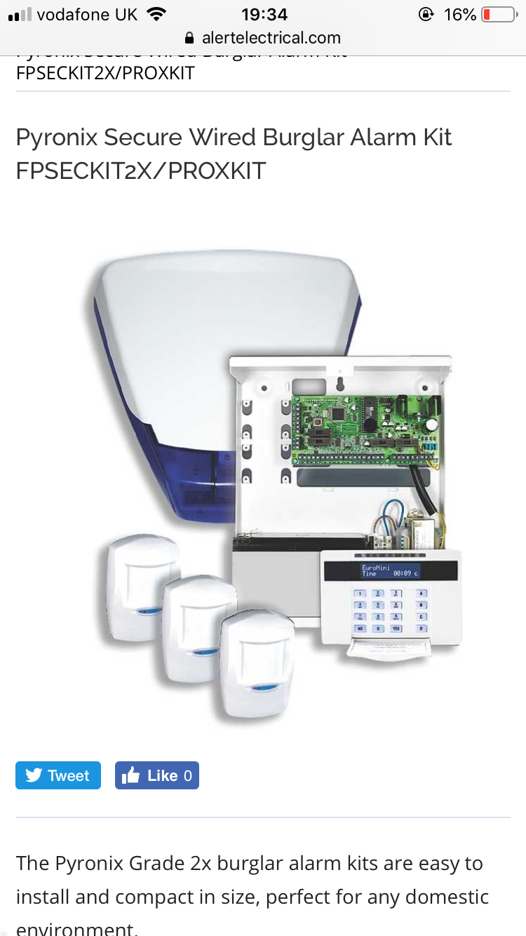

Hi everyone,
I’m confident about wiring and programming most of the system myself.
Were I am not sure is the external and internal sounder, its an output I’m sure
so how many output types will this have ? There seem to be multiple output types (16,14 etc) on my brothers alarm?
One of these
Euromini ...connections are straight forward ...bell, strobe and loudspeaker all shown on pcb
How many outputs do you need ?
Euromini ...connections are straight forward ...bell, strobe and loudspeaker all shown on pcb ..
Yes wiring is ok,
Looking at the programming, engineers menu, outputs , bell and then do you only pick one input ( for example 14 -siran any) like you do with a pir?
Speaker ...16-32ohms or pyronix twin alert if you want a higher internal alarm all in one unit ...
Yes I will connect it to the bell of the outside box so I wouldn’t need to programe that either , would that be correct?
