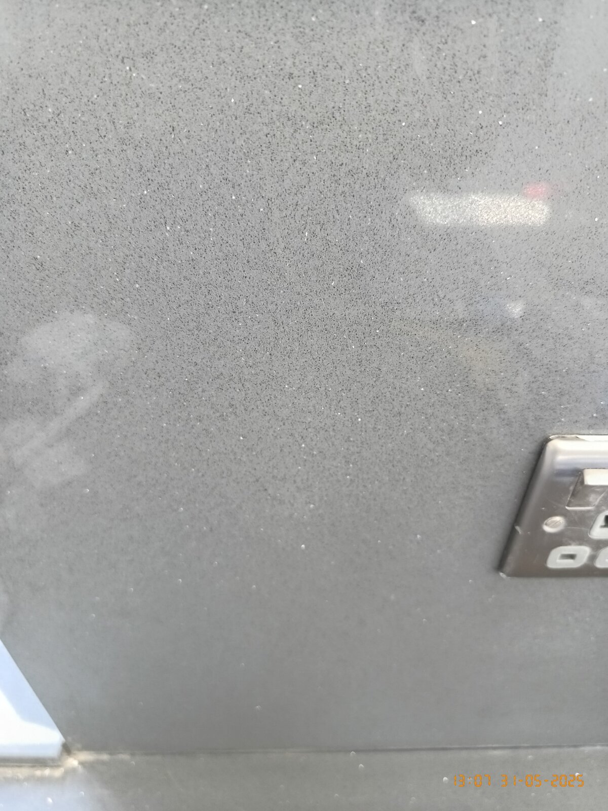

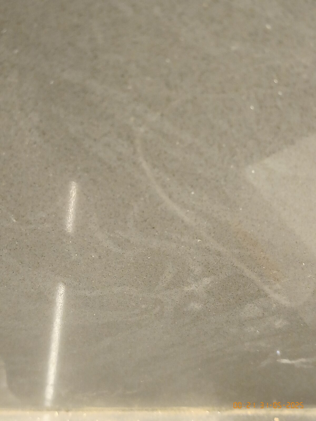

Quartz worktop protection film marks
You could be lucky - they might just be adhesive residue from the protective film. You might want to try a variety of solvents on the glued side of a piece of the film to see if the glue can be dissolved. I'd try:
1. White spirits
2. Lighter fluid (petroleum)
3. Methylated spirits
4. Turpentine
5. Acetone (nail varnish remover)
and in that order to find one that works. Once you have a solvent which works you can try it out on a very limited area of the top to ascertain if it will also remove the coating. If it doesn't, happy days. If none of those work there are some more 'heavy duty' solvents you can try, but the more commonly found ones are the ones I listed and they'll generally lift adhesives

Lighter fuel tends to remove most adhesives.
Have white quartz worktop, supplier said only two things damage it, heat and bleach .
