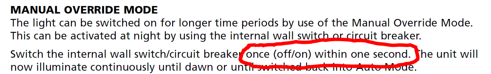

Most PIR floods like yours do not need to be switched off & on twice to put them into manual mode, the common procedure is to switch off for about a second and then back on (only once). To revert to PIR mode, switch off for about 30 seconds and then back on.
Thanks I have never tried that but the instructions are quite clear that its off and on twice in 2 seconds. Yes, I would like it to be a manual light only.
Must have been printed in error and later instructions edited then, because the PDF for the model number you gave says..

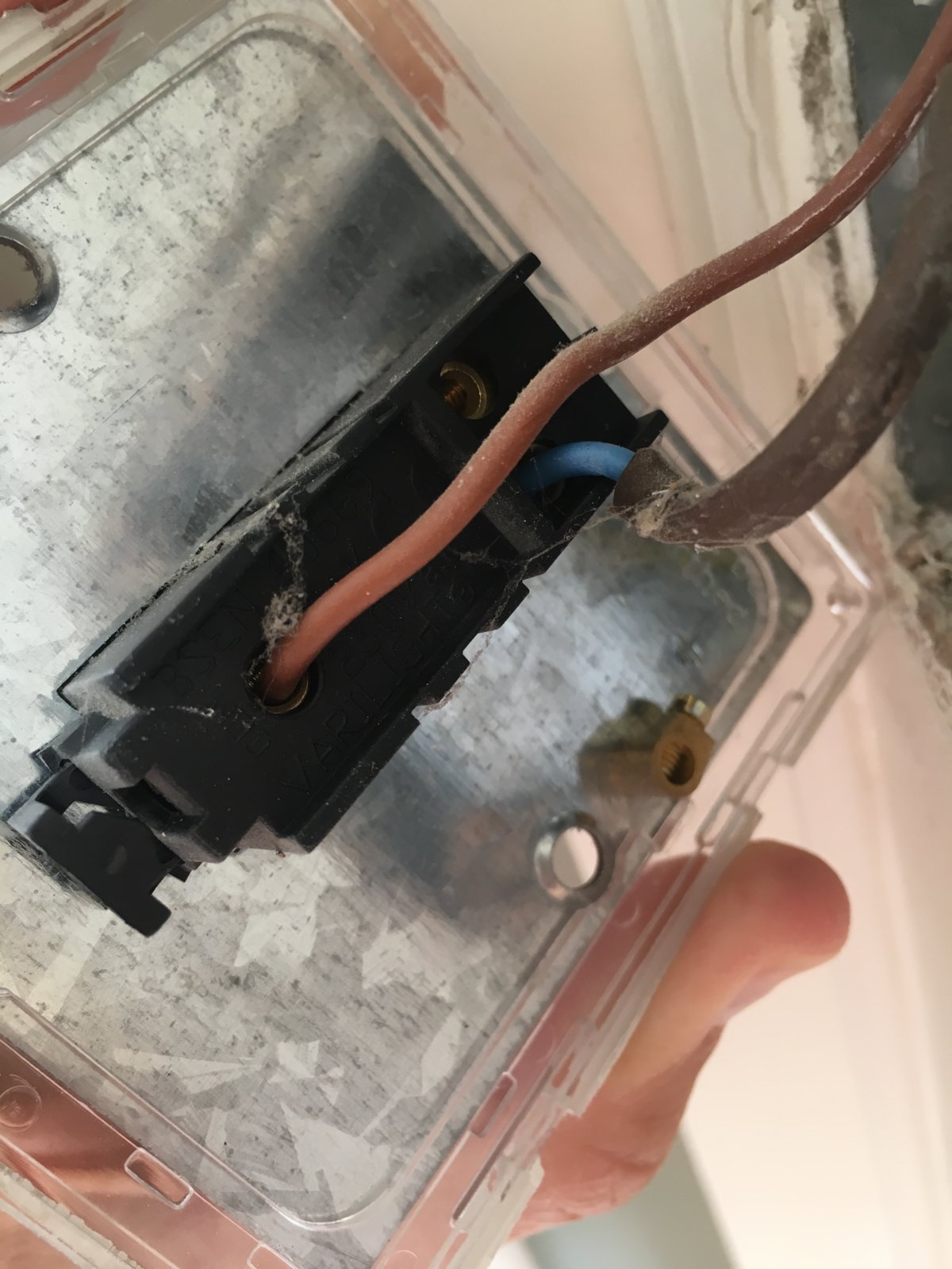

Right don’t want to take any risks here, below is a photo of the back of the light, Live is going into COM, cannot see where it says L1 or L2.
Would it be a case of moving the brown live wire from COM to the spare L, see photo
Your switch does not have an earth conductor in its earth terminal. Have you disconnected it to take the photo ?
