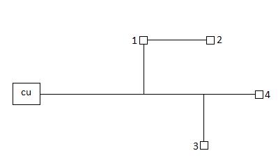

As part of my studies, I need some help with a question I have regarding volt drop. I have a copy of Electrician's Guide 17th Edition BS 7671: 2011. I understand everything covered in the volt drop section, but it doesn't appear to mention how volt drop is calculated in a circuit in consideration to spurs. I'm hoping it's not a silly question. I've only had the book a few days and still learning. So I thought it would be easier to put up a diagram.
In the radial circuit shown, the cable running from the consumer unit runs directly to socket 4 whereas all the other sockets are spurs. If i was to calculate volt drop for the load at socket 4, would I have to calculate the length of cables used for the spurs also or don't i need to??

Are they?
What if #2 had been the first one installed, and then #4 and then #3 and finally #1?
What would make 1, 2 & 3 spurs?
At what stage would #2 change from "directly connected" to "spur"?
Does any of the current for the load at socket 4 flow along any of the other cables?

As BAS has implied, we don't talk about 'spurs' of radial circuits, not the least becasue it is sometimes impossible to define which is a spur [consider a supply going to socket 1 and from that socket separately to skts 2 and 3 - is the main circuit 1&2, with 3 as a 'spur', or is the main circuit 1&3, with 2 as a 'spur']. We therefore normally just call them 'branches'.
As BAS has also implied, in order to determine the voltage drop for any socket, you have to consider what route the current takes between CU and that socket, and then determine voltage drop just for that route (total length of cable between CU and the socket in question). From the point of view of circuit design and regulations, you need to know the greatest voltage drop at any of the sockets, so you would have to work out, or discover, which involved the greatest length of cable back to the CU. If the circuit involves cables of different sizes (CSAs), it obviously gets a little more complicated (the longest cable run is then not necessarily the one with the graetest voltage drop), but the principle remains the same.

Having seen Eric's reply, I would point out that the responses from BAS and myself assumed that you wanted to know the voltage drop at socket 4 when there were no loads on any of the other sockets. As Eric says, if that is not the case, the whole situation becomes much more complicated, and there is not necessarily a single answer. Although none of the current going to socket 4 goes along any of the branches, currents from all the other sockets (1, 2 & 3) go along parts of the route between socket 4 and CU, introducing additional voltage drops in the path between CU and socket 4. Determining the voltage drop at socket 4 in that situation therefore requires knowledge of, or assumptions about, the currents being drawn at each of the sockets in the circuit, and also detailed knowledge of the various cable lengths concerned. Even determining the 'greatest possible' voltage drop at socket 4 would not be a trivial exercise, and might need some trial and error, consdiering different patterns of loading of the other sockets (with, as Eric says, the total limited to the rating of the fuse/MCB protecting the circuit).

If you know the current in each socket-outlet, and you know the length of each 'leg' of the circuit, it's not difficult. Just write the currents on the diagram, add them up for each leg, and use Ohm's Law.
