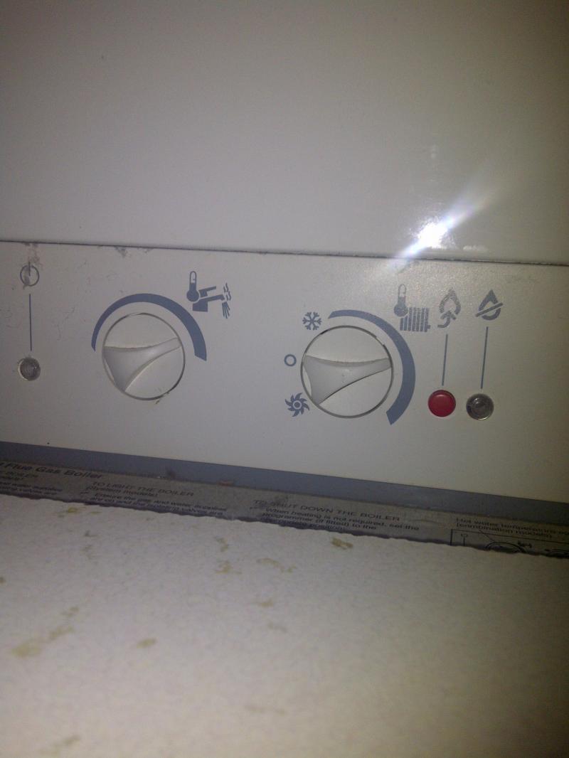

hi guys I've been having trouble with my heating for a while basically when the hot waters on the boiler fires up when I use the room control/thermostat it wasn't firing up. My landlord sent round his "plumber" who basically said he's left the boiler constantly in the on position and it will be controlled byy the room stat. So I think ok fine but now ehn I use the stat after a while the flame goe out but the boilers still making noise. Is this normal? Is my heating still going to work? Does it mean its running off the emersion heater?..I went in my loft and didn't see a water tank but my place is a house conversion so I'm not sure maybe downstairs have one and its connected?

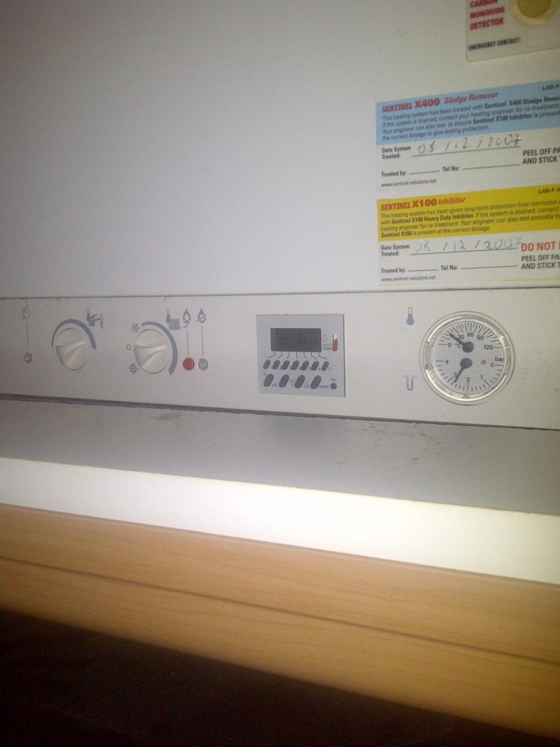

Can you post some pics of the system?
It sounds as if you have a combi boiler.

its an "ideal" not sure on model
That's OK. It clear from the pics that you have a combi boiler and it looks like the Mini model.

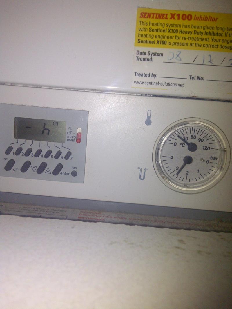

Hope your landlord sends someone out soon as the pressure is looking a bit on the high side ;)
The tennant has probably been fiddling with the filling loop and does not read the FAQ to see how to set and control the pressure.

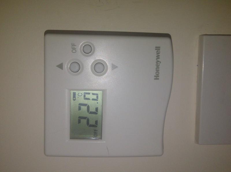

Which stat do you have? (A pic would help.)
If it's an old mechanical type, they do lose their accuracy after a time. Also check that there are three wires connected (not counting a wire to the earth terminal).
The flame goes out when the flow temperature reaches the set valve and the minimum power output is too high.
Almost certainly the boiler output has not been set to match the heating needs and the gas valve is probably not correctly adjusted.

he coming tonight to change the stat. Some one did come round before but not to service it just to cert its safe. Would changing the stat solve this? It is an electrical stat will try to get a pic
