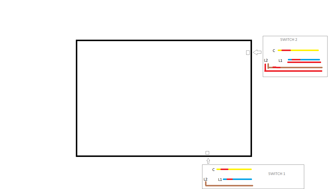

Hi all, looking for some advise please. In our master bedroom we have two light switches controlling the ceiling light, (very rough) diagram attached. I want to remove Switch 2 and blank it off, can someone please point me in the right direction with what to do with the wiring at both switch locations? Planning to use the 3-way Wago connectors where required.
Thank you!

Thanks EFLI, appreciated. The wires at Switch 2, I was planning on using Wago connectors to join or isolate per recommendations then leave them in the existing backbox... we're putting some cladding on the wall and the 'old' (current) Switch 2 location will be behind the edge of one of the panels.

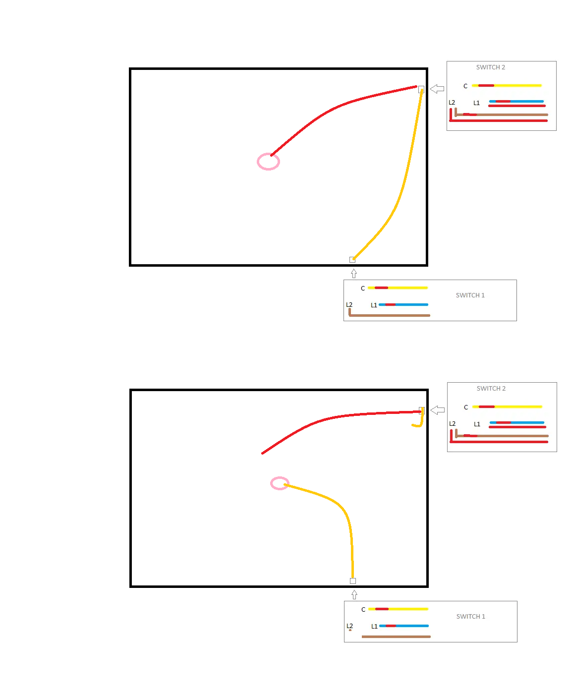

If there is a loft above, you could perhaps pull the wires up and put them in a junction box.
Then the bedroom wall need not be spoiled.
or cut and join if plastered in, even better would be if the 3C&E can be rerouted to the light fitting.
Example:
