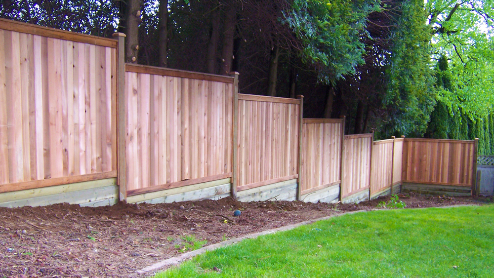

Planning to embark on a small fencing project ( about 9 metres in length, 4.5m in height ) using closeboard panels with concrete posts and gravel boards. Never done it before, so I'm researching like mad.
Couple of questions on the above: firstly, the garden has a slight incline, so where should I take my level from? Top of the post, top of the fence panel or the gravel board? Or is there another way?
Secondly, what's the best method for keeping the concrete posts upright and plumb whilst adding Postcrete to the post holes? I've seen some stuff about using pieces of wood to hold the post in place, but I'm hoping there's a more reliable method.

Is the 4.5m height a typo, I'm assuming so?
Is it this sort of result you're aiming for?
Yes, the 4.5 m thing was a sloppy mistake and thanks for the pic. My slope is far less severe than the above but obviously the principle will be the same.

I had my fence replaced last year, not panels though, it's hit & miss style. My garden has a very slight gradient so I asked them to keep the top level all the way across, then they contoured the bottom to follow the gradient. My lowest side is 6 foot, then it increases to around 7.5 foot other side due to gradient.

Just remember to get slightly longer posts if the slope is reasonable. Also, make sure there is no panels flapping around and that the posts support the panels and then step down.
Depending on the gradient you may need to use two gravel boards on top of each other. Otherwise the panels will be in contact with the soil and will rot.

Thanks once again. In all honesty it’s a fairly gentle slope, so the “step down” will be minimal. However, the other side of the garden also need new fencing and it’s longer—about 15m—so this shorter run should provide a useful template.
