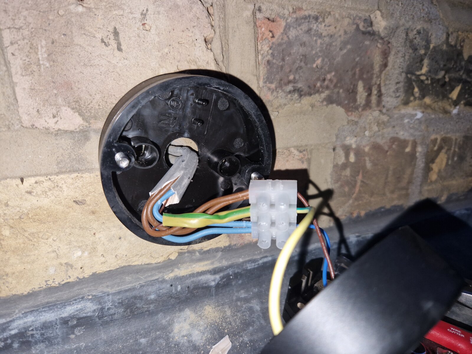

Hi Pete, I connected an outside light. The core of the wire was solid. I connected it with a screw-in terminal block.

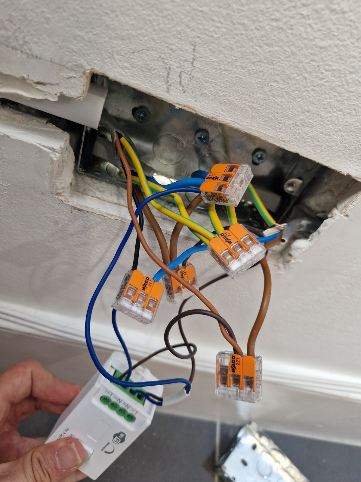

I also connected some inside lights and the core of all wires was solid apart from the wireless receiver, which had stranded wire. I connected it using Wagos.
See attached photos.

All your connections look ok to me no copper showing etc....I always do a tug test to be sure.
Not sure whats happening in the box though...was that a socket?
Thanks for the help. Yup, it was a socket. I removed the socket and connected two lights with a wireless receiver.
