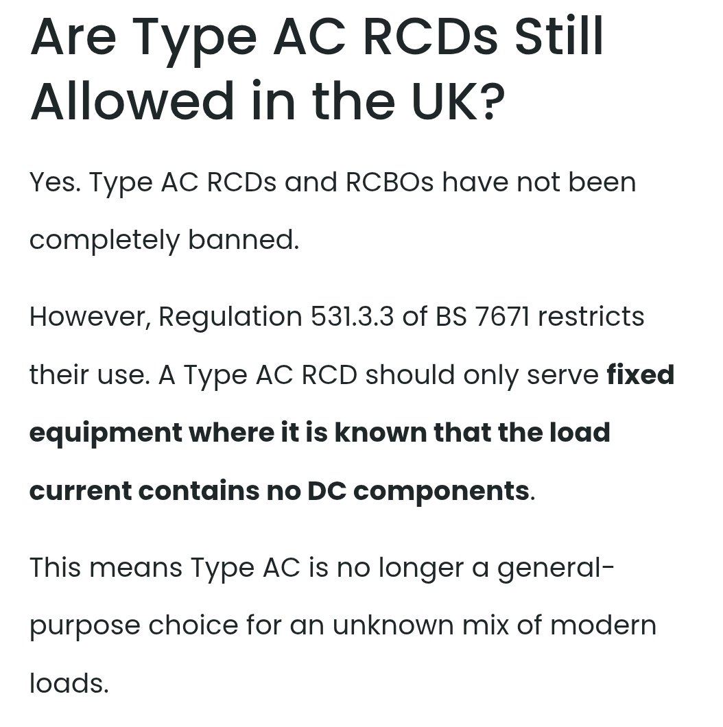

Most electronics have full wave rectifiers, so DC components under normal conditions should be negligible.
It clearly does.

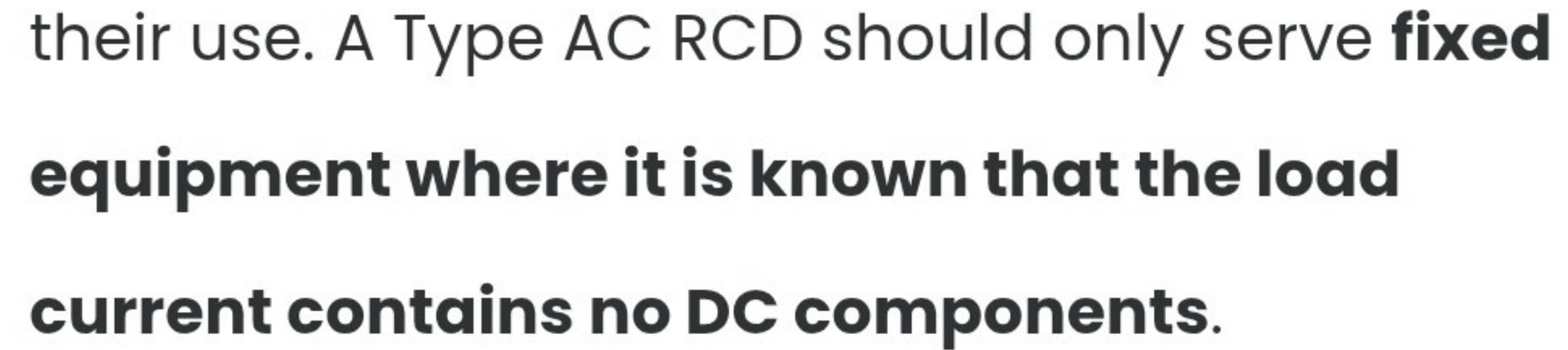

Please explain why equipment designed to be fastened to a support or otherwise secured in a specific location cannot be powered via a socket.
And then please explain why I have seen countless examples of such.
Therin lies the problem.
Often, in electrical terms, the term "fixed equipment" relates to someting electrically connected via a DP switch or an FCU to differentiate them something plugged into a socket outlet.
Yet there is nothing to prevent something that is physically fixed to a building from being connected/disconnected via a plug and socket.
You might have a boiler fixed to a wall but electrically fed from a plug and socket arrangement.
Whenever we use a word or a term we must strive to make it clear in what sense we actually mean by that word or term and in what sense we do not.
Commonly such words or terms can have two or more alternative meanings depending upon which context we are intending and if we are not carefull we end up comparing apples with oranges.
If we look at part 2 of our Wiring Regs we find some definitions, so we might reasonably expect electricians have such definitions in mind when talking to other electricians.
But, when talking to an ordinary person then we (including any of us that are electricians) should take that into account.
Spur and FCU versus spur a piece of wire or a train line and Ring final versus Ring main are just two examples.
Fixed could mean actually fastened to a wall but some might use it as an item connected exclusively to one piece of equipment and nothing else. The term fixed could also mean a piece of equipment drawing only a fixed amount current ( as part of its intended function) rather than to one drawing a variable amount of current.
