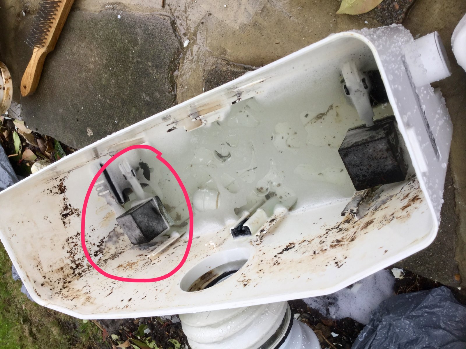

Hi
Ive had the enviable task of stripping down my Saniflo unit today. It's for the most part, cleaned up but I have a question on the shower inlet pipe. Should this be non return? When I first cleaned it, no water was running out from it but the float was wedged down with carp. No it's clean water is running out from it when Im cleaning the unit. I don't want to reassemble only to have to replace this if its faulty. Does anyone know?
Thanks in advance
It won`t close until enough water is inside the tank to raise the float and put pressure on the cap. Pull the valve out and check inside it for any muck. The other valve won`t come out until the blank cap is removed.
Thanks. Got it all back together after a good clean up and is working as if it was new :)
