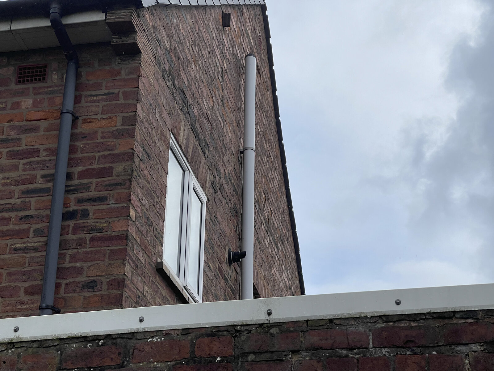

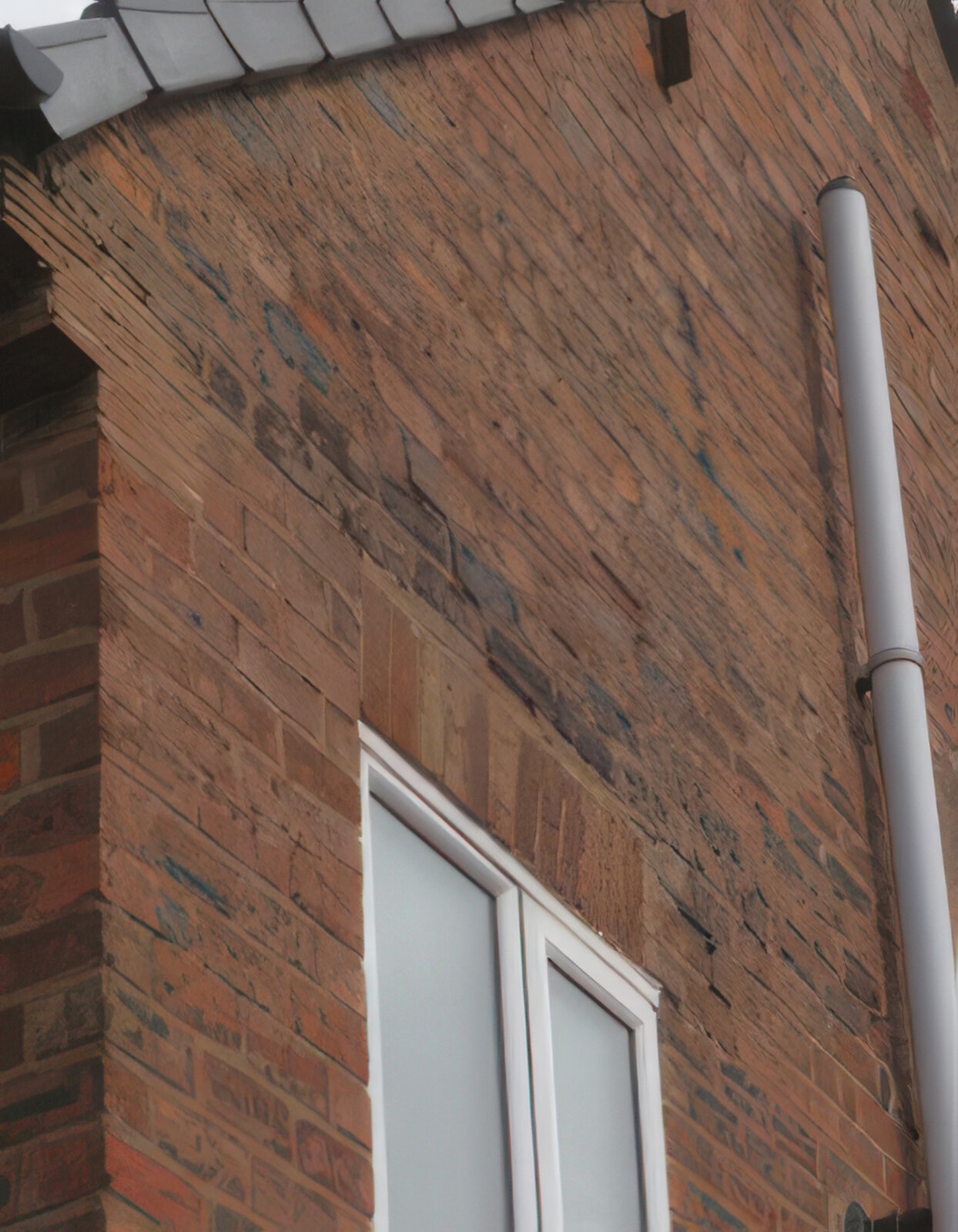

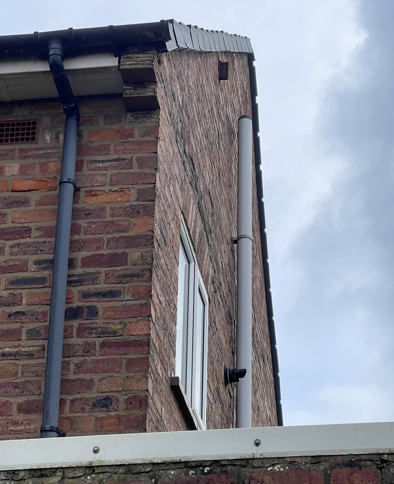

I have a problem with two windows in the gable end of my semi-detached property. The 1947 property does not have lintels and s such and uses upright "soldier" bricks above the window. The bricks in one of the windows are now bowing out slightly from the wall due to excessive pressure (more than likely due to a shoddy window installation before I purchased the property). See attached photo.
The quote I have received is as follows :
Pin and prop structure, remove deformed and cracked brickwork, insert new L9 lintel, rebuild brickwork and make good plasterwork, leave ready for decoration. Include
helical reinforcement bars to any remaining cracks as required.
Eachl lintel installation to cost £1950 excluding VAT so for 2 lintels that's a total of £4680 inc' VAT. This does not include the costs of scaffolding.
It seems expensive to me but I have no idea of the general costs of these things.
I know the building company is a good professional outfit and it has been so difficult to even get a builder to come and give a quote due to high demand.
Is this quote in the ball park?
Rob

Chances are a 1947 house will have cavity walls therefore it is probably only the outer leaf of brickwork that is deflecting. I would suspect the inner leaf has a perfectly good concrete lintel.
The only "L9" lintel I can see on Google is for a 9 inch solid wall and the fact they are quoting to make good plaster suggests that they think it is a solid wall and they intend to replace the entire lintel. You probably need to check how thick your wall is to make sure they have quoted for the right work.
Either way the price quoted is very expensive and I would expect it to be around half that cost. Also once the lintel is replaced the helical bars are completely pointless so that is a waste of money.

personally i cannot see what wrong with the brickwork, looks exactly like a lot of the chucked up post war houses. I suspect that was like that from the day it was made.
Admittedly it's not the best photo. It's raining and I
couldn't be bothered getting the ladders out. The area within the red boundary shows a large crack. This is a separate issue to the problem with the soldier bricks and is easily fixed. The soldier bricks (outlined in green) are angled outwards although it's hard to see in a photo. The entire repair costs for the wall fall in at £10,000!!!
