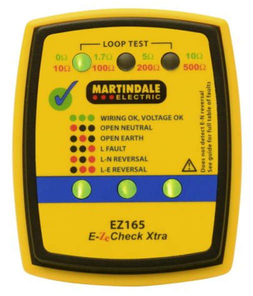

I've had a combination of lights on a socket tester that was not in the manufacturers instructions!
What I don't understand is why the socket tester showed a Live/Earth Reverse, Missing ground.
Those devices are ultra basic, and will show totally misleading results for plenty of faults.
They are best used as 'working / not working' rather than any kind of indication as to what the problem actually is.

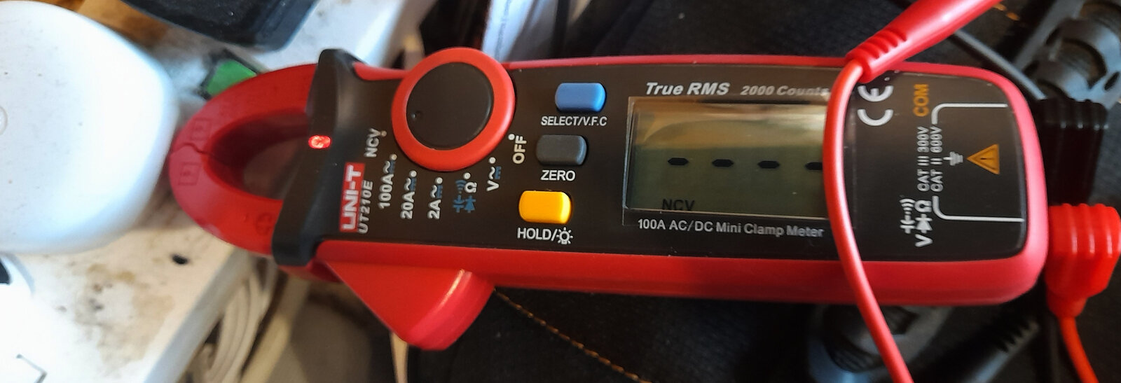

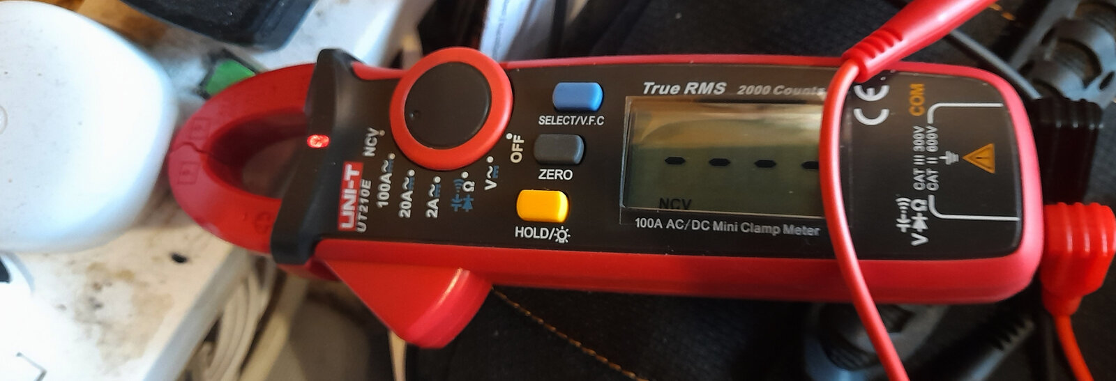

I do use testers other electricians seem to frown on. I still use my non contact tester Testing for live.jpg I love being able to see if there is a line supply without relying on the neutral and/or earth being sound, hard wire testing needs two intact wires, the ---- shown shows line, also a buzzer, however I see electrician and electrician saying these testers should be thrown in the bin, same with neon screwdrivers, however although the clamp on the meter shown can show when there is current flowing, it is still doing it with no contact, so the neon screwdriver is good for identifying borrowed neutrals.
But although I know the meter measures DC current using the hall effect, I don't really understand what the hall effect is? So may as well say it uses magic.

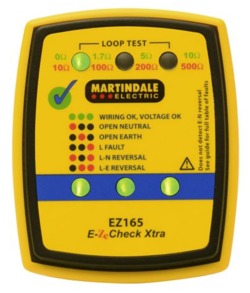

The main thing is these testers 1685888742949.pngshow there is a fault, yes it shows 1.7Ω when pass mark is below 1.4Ω but at least it does show when there is a major fault. But as to what the fault is, often it needs more testing.
