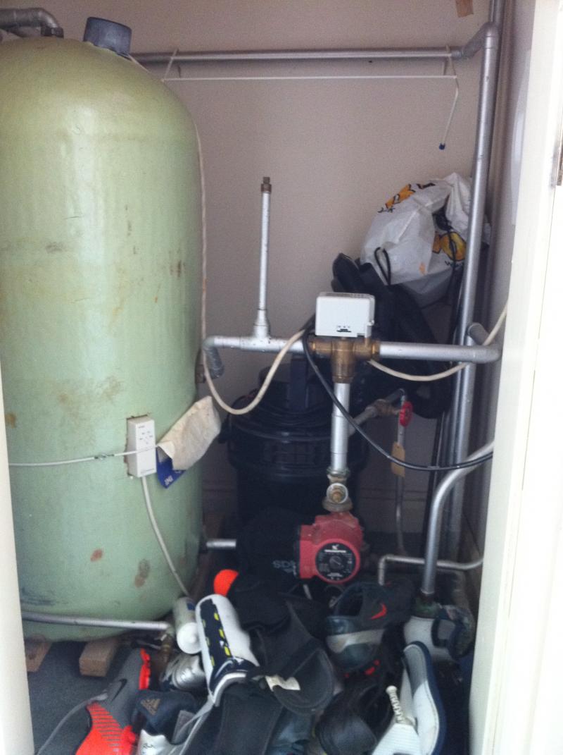

I've installed a towel radiator in the upstairs bathroom 1metre off the floor, it bleeds fine with no air but the water doesn't circulate so the rad stays cold.
I've tried turning all other rads off in the house but no good.
Any ideas?
It's a gravity fed system btw

Thanks for that, although i don't think it's plumbed in wrong....the inlet and outlet are on the same way as the previous convector radiator that was there.
Interesting you should mention modern valves being restrictive 'cos the inlet pipe gets warm up to the valve, but as mentioned i turned off all the other rads in the house you'd have thought there would be enough pressure to push the water through?

.....got a conventional boiler, an expansion tank in the loft, a pump and a motorised valve (CH/HW) by the immersion heater
This:
The air valve is the thing on the end of the pipe sticking up on its own between the cylinder and the motorized valve.
The valve should be above all radiators. I suspect that the valve is below the top of the new rad.
Is the air valve done up tight? It shouldn't be, otherwise any air cannot escape.

Ok this might be the problem. Does it need to be extended?
Plus yes it is tight - if i loosen it to bleed the system first any air then water comes out
