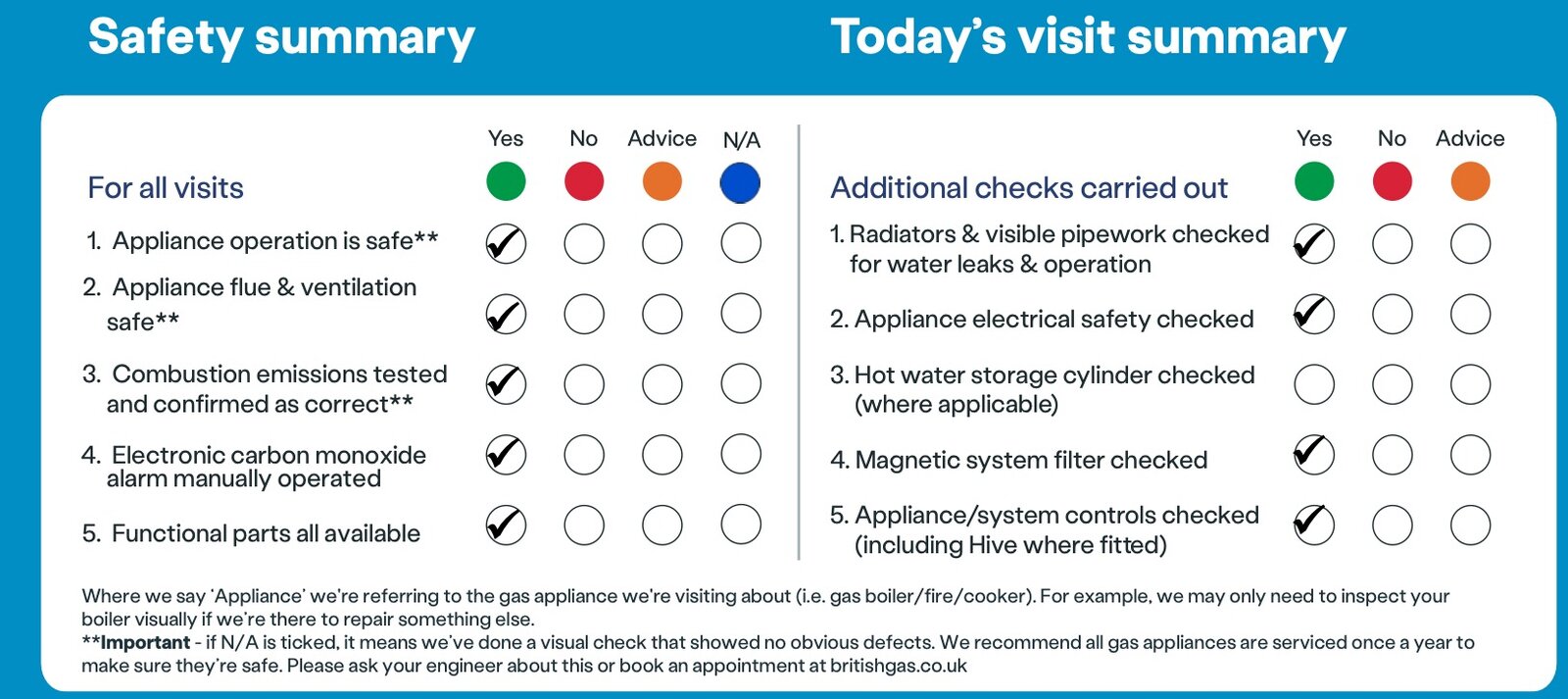

The British Gas service guy has not mentioned lack of filter, and they know the boiler was installed in 2024, after the regulations were apparently changed on 15 June 2022.
A boiler service, only includes the absolute basics (if you are lucky), of checking the boiler is doing what it should safely. They will not care about a filter, inhibitor, or any leaks on your system, etc..

It's rather like, going to a garage, and asking them to change the engine oil. They do as you ask, but would you also expect them to check the water, the wheels, and the tyres - maybe give the car a full service, when all you had ordered was an oil change?
You invite BG to do an annual boiler service, that what you get - the very basics, of an operational and safety check.

Recapping a bit, I bought a new Baxi boiler, to replace an old Vokera boiler. The installer had visited and seen the property / setup in advance, and quoted for Baxi supply and installation, relocating the boiler approx 60cm to the left within the same room, and adding some Hive TRVs to the setup.
Summarizing some of the discoveries in the thread and things I knew already before starting the thread:
The installer spent basically no time checking anything, once last pipe was connected, they were off.
Note they did not complete a commissioning checklist.
The heating did not, post install, work as well as it had before.
That caused me to complain to the installer.
They ignored my complaint.
As I had no confidence the install was done correctly, I telephoned Gas Safe for advice, who sent an inspector
The boiler installation failed the Gas Safe inspection, 12 different defects
We now discover the Flow/Return had been swapped around, probably inadvertently (I dont suggest it was deliberate)
In all TBOE connected cases, the Flow is now at the bottom and the Return is now at the top.
There was no filter installed, which you insist is a requirement.
The installer says, this very week, contrary to multiple posts in this thread, and Baxi support, that Flow/Return cant be wrong way round, as it does not matter at all which way around it is now, or ever was. I think direct quote is "it can't matter mate, it's just a loop".
I dont want to translate that into a specific car problem, but "the job", for which I paid 3500 UKP, isn't really equivalent to an oil change, is it?
