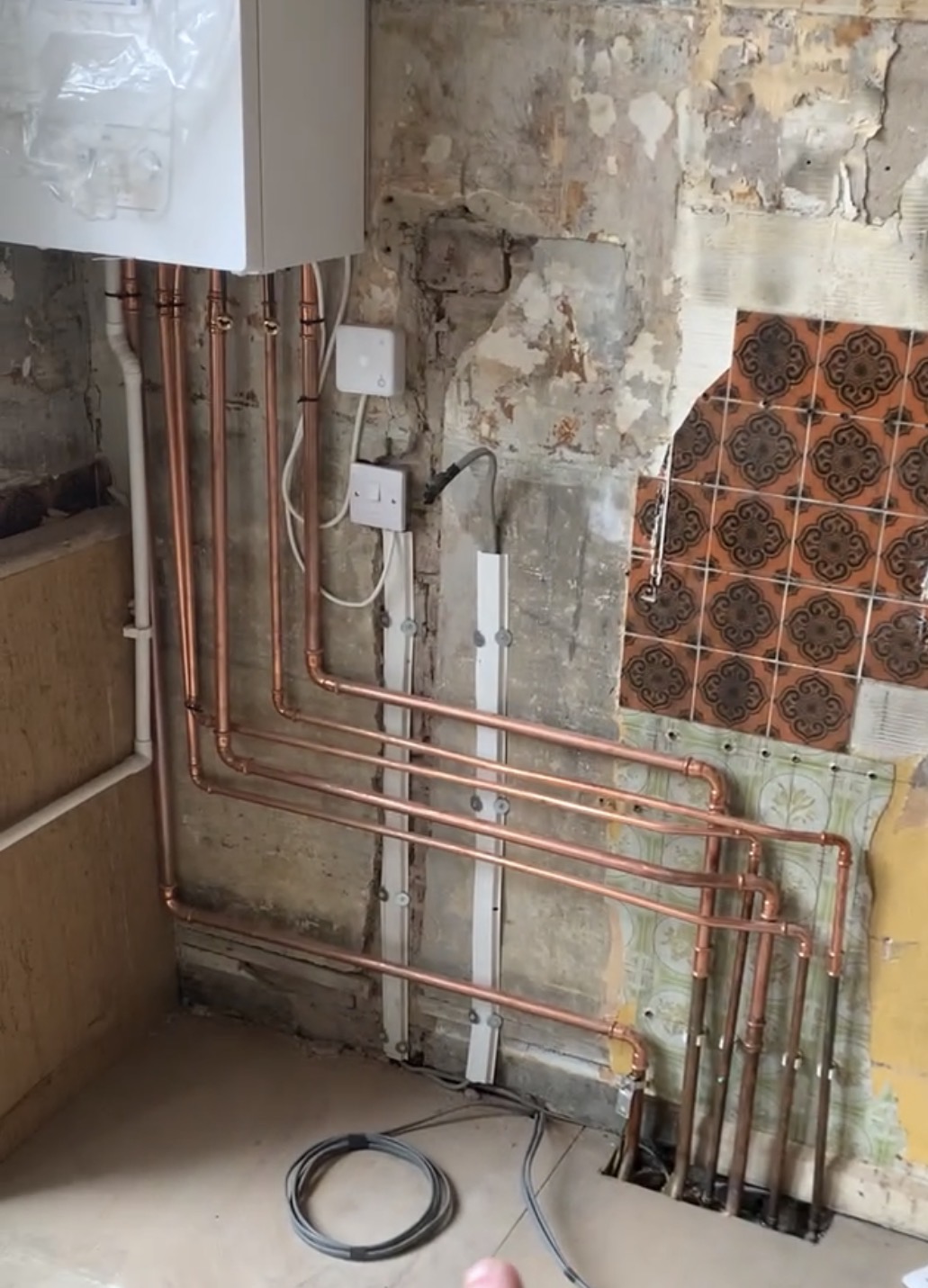

It's plumbing basics, the flow should go to the top of the radiator in your situation.He’d already dismissed the importance of flow/return possibly being wrong way around.
It has nothing to do with the valves, they are irrelevant. It only confirms your new plumbers misunderstanding.He says it’s irrelevant, dismissively, as the TRV is bidirectional.

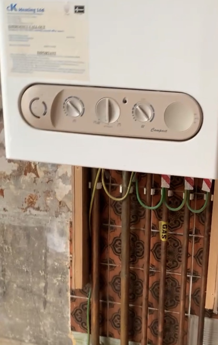

Volkera - left two pipes are return and flow, respectively.
Baxi: leftmost pipe is flow, rightmost pipe is return.
WRONG.
The guy I was recommended by local plumbers merchant insists that flow/return wrong way round is a non issue. My understanding is he’s plain wrong on that. Maybe he’s misunderstood my explanation? But he’s seem same images as shared here. Is that enough to just “walk away”, and find someone else ? If so, should I just tell the someone else I want flow/return swapped around, and not do what I’ve been doing which is describe the problem I am seeing ?
Don’t you see my dilemma/position? I’ve not enough knowledge, what we call in IT the relevant SME, to judge if this or that course of action is wise. So I ask a few local “professionals”, and in this forum. I get, at best reading, mixed & contradictory advice. Not a little bit contradictory, but polar opposite contradictory. Eg try to square:
I don’t really know how to best proceed.
