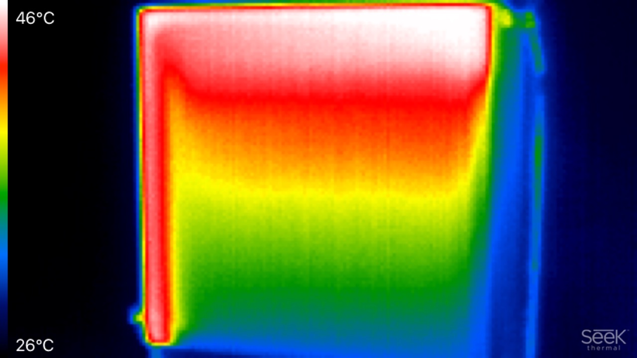

Any input much appreciated. I don't have great DIY skills, so I presume this is beyond my own abilities. Know Your Limits

Have any of the tradesmen actually gone around and balanced the radiators? That is: adjust the lockshield valves on each radiator to ensure that water doesn't flow preferentially to only a sub group of radiators? That could be the reason why some of your radiators don't get very warm rather than them being full of sludge.
Balancing can actually be done by anyone, although it requires a lot of patience. With the system running, open the main valves fully on every radiator and close the lockshield valves on all radiators except the one that get the least warm. Check that that one now heats up. Then go to the next radiator is the "warmness heirarchy" and gradually open the lockshield valve on it until it too now heats up. Check that the first radiator stays hot. Wait for at least 20 minutes between adjusting the lockshield and checking the radiator temperature. Proceed in this manner until you've adjusted all the lockshield valves, checking each time that all the radiators you've adjusted stay hot, and waiting 20 minutes of so between each adjustment and temperature checking (I said it needed patience!).
A skill worth learning. Paying an engineer to do it doesn’t make sense to me given the time it takes.
If you want to do it properly and have the time... A couple of temp clamps and adjust lockshield until getting the correct deltaT
