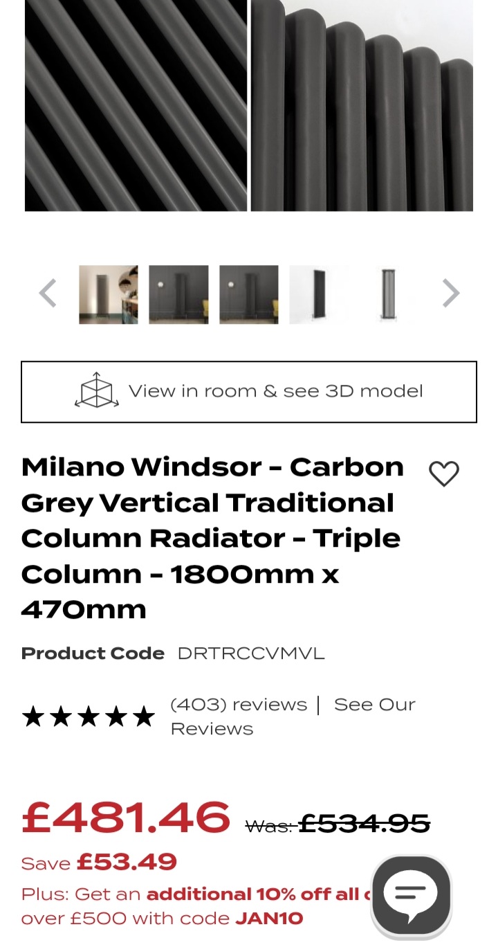

Hi all,
I'm looking to install some new radiators and i've been drawn to the traditional 3 column Milano Windsors being offered by Bestheating.com
I'm particularly curious about their ability to offer a 20 year guarantee whereas it appears that the industry norm is typically 5 years but occasionally 10 years
For example, if i looked at the Stelrad equivalent, their guarantee is 5 years
Has anyone got any experience or thoughts on Bestheating radiators and the quality please ?
thanks in advance
Bestheating - Milano Windsors

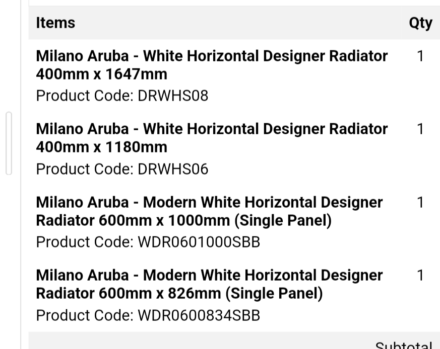

Fitted loads of Milano Aruba, they seem pretty decent. Never had to bother them for the warranty so can't comment on that
I bought four Bestheating Aruba's just over two years ago. They perform perfectly fine but I have noticed recently that the finish paint is separating from the radiator at the top corner in two of the four. I am waiting until the winter is over before raising a complaint, so cannot comment on the warranty
Regards
Tet
@muggles @Tetrarch - thanks both for your replies
Can i assume that you both mean Aruba's and not the Aruba Ayre's ?
Interesting to hear the paint issue after a couple of years which is disappointing
Seems the finish used by Bestheating is white powder coated finish
Yep

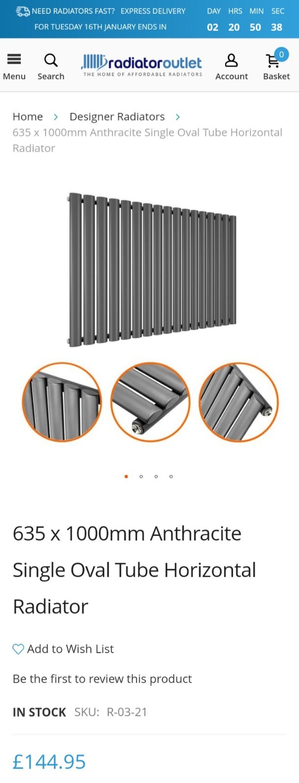

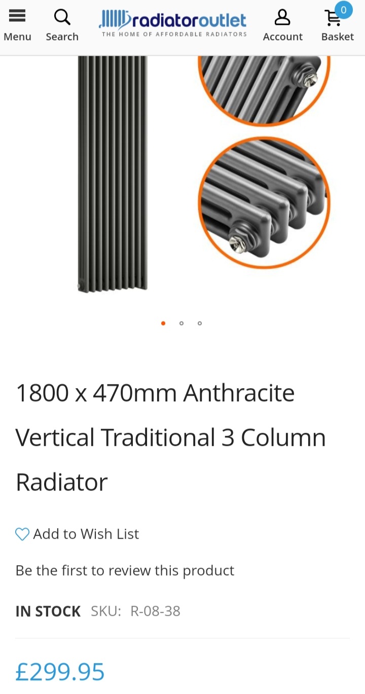

I bought some Aruba from Best Heating a few years ago - they're still good, but since then, their prices have gone up quite dramatically.
Recently I was looking to buy another, and i may be wrong, but I believe Radiator Outlet share the same OEM, at a reduced price.
In the end, I bought from Radiator Outlet, but I didn't get an Aruba equivalent, so I'm afraid I can't make a direct comparison - but the rad I bought was of a decent quality.
Example here...

So I’m looking at the Milano Windsor traditional style radiator not the Aruba but my question is more around how bestheating can offer a 20 year guarantee
It seems to be double what most other radiators offer
You may be over-thinking this.
I see lots of cheapo pressed-steel radiators 30 or 40 years old that are fine except for the paintwork looking tired and jaded. And some that have pinholed and need replacing.
Much depends on system water quality.
"Bestheating" may be a reseller company with little prospects of being around in 19 years time to honour any implied or express warrantee.

Sorry, the point I failed to make, was that the extra warranty equates to extra cost - is 10 years extra worth £180?
If they are from the same OEM, the MTTF would likely be similar - it's a game of odds!
(Although the increased colour choice on the Windsor may make it worthwhile)
Edit...
And for anyone interested, Best Heating is a brand run by "Limitless Digital Group Ltd", a company operating in it's current form since 2004, sourcing products from China, Turkey, Poland, UK and Italy to supply to customers via the internet.
