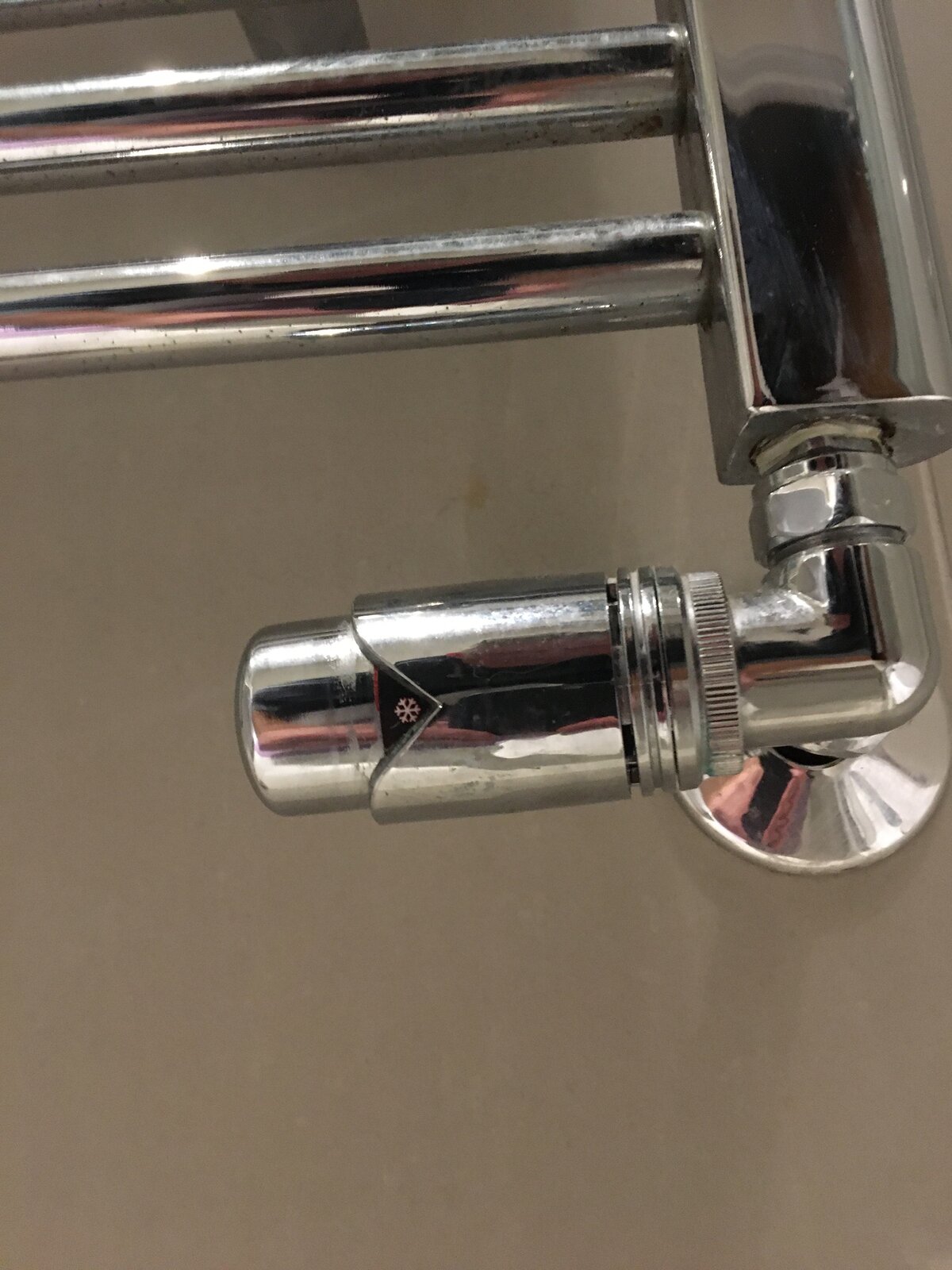

Ok will try that, also the shower room radiator towel rad ( it’s probably the nearest to the boiler... just) is boiling hot even when the thermostat is on lowest setting ....
this may not be shutting off correctly then.
Mottie thanks I’ll try that ... any advice on the blistering hot towel rad.?
It’s not a part of the bypass circuit is it? If not, I’m not an expert but if it’s the nearest to the boiler I’d try throttling it right down on the lockshield valve.
Yep I understand that and will give that ago too cheers
