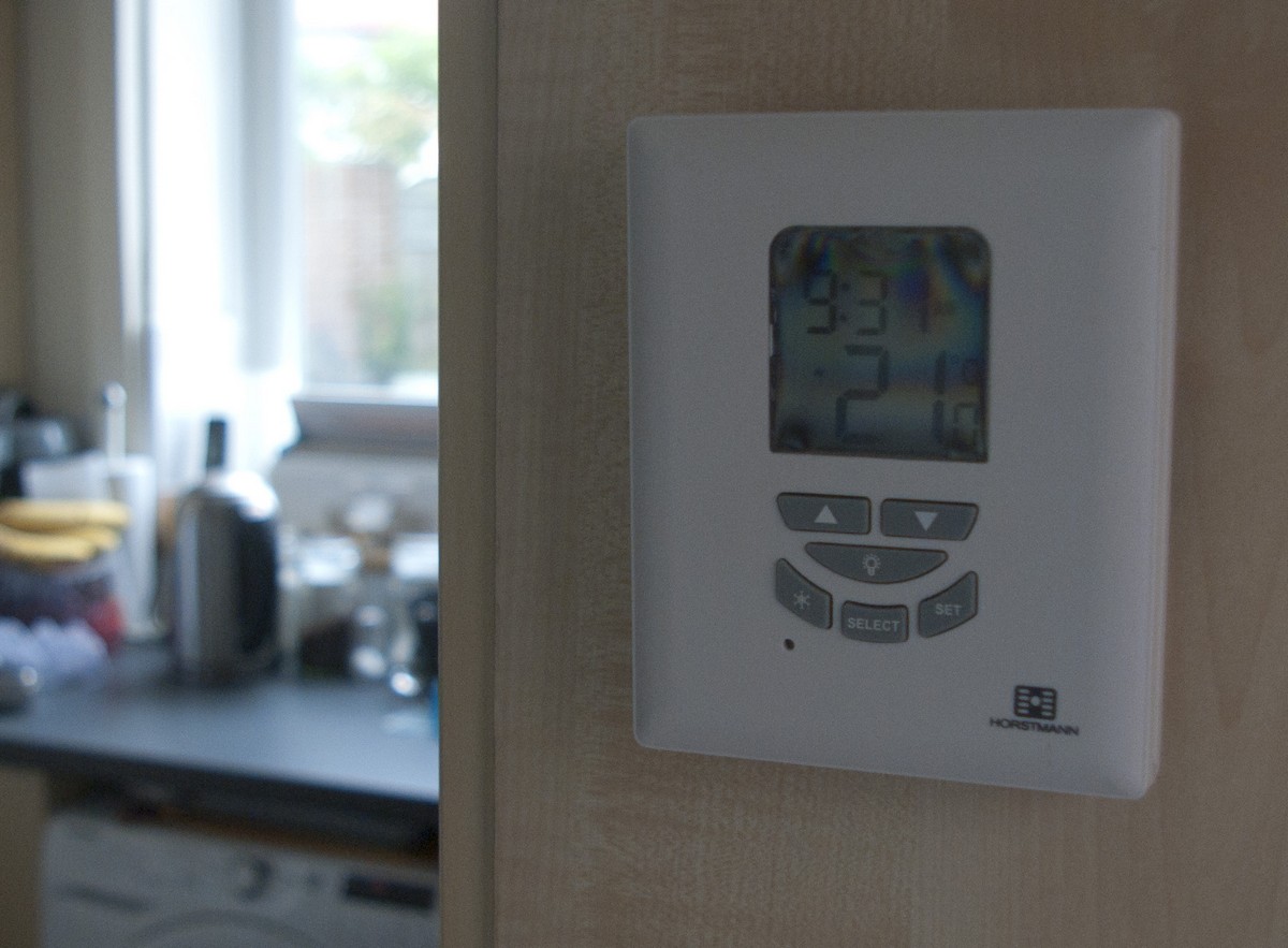

Feeling a bit warm yesterday evening, checked the radiators and they're all fierce hot - checked the wireless thermostat and it was reading 25 deg, and rising, even though it was set to 21 deg.
The display on the wireless thermostat (Honeywell DT92E) was showing the flame symbol (calling for heat??) and flashing 'radio waves' (communicating with receiver??).
The programmer was 'on' - ie it was during the programmed time for the heating to be on. Switching the programmer to 'off' turned off the boiler and the rads then cooled down. Have left it switched off for now.
When this happed a week or so ago, I suspected it might be that the motorised valve actuator had stuck, (that has happened before a couple of years ago) so I replaced the actuator (as I did that previous time) and everything was fine again until last night.
Oddly enough, when I fitted the replacement actuator I noticed that the lever, which I believe is supposed to return itself to the "Auto" position when unlatched from "Man" actually seemed to stick halfway. Looking at it again now, with everything switched off, the lever is sitting halfway across, whereas the other actuator (for hot water) is parked in "Auto".
Is it possible that the replacement actuator is faulty, or is it more likely that there's some kind of intermittent issue with the thermostat? (I couldn't understand why the thermostat was still displaying the flame symbol when the temperature was already way above where it was set) (or does the flame symbol display whenever the boiler's firing??)

The problem is almost certainly with the thermostat. The fact that turning the programmer to OFF halted the heating suggests the the thermostat is communicating ok with the receiver unit at the boiler end so I’m not sure what the problem might be, just that the actuator is simply doing what it has been told by the thermostat.

I think this comment shows its the thermostat as it is asking the boiler to heat
have you changed the batteries , seems like a faulty thermostat
As its was calling for heat, so the boiler was doing what it has been told to do, by the thermostat to keep heating.
I would not look anywhere else, until the thermostat when it reaches the required temp setting, actually turns off the request for heat symbol

Have changed the batteries and testing it again right now. Thanks for your help, btw.
OK so have tested again and so far it's working correctly. Observing the valve, it seems to operate correctly even though the lever isn't fully returning to the "Auto" position like the HW one does. Unfortunately I have zero confidence the problem is fixed for good, because I've done nothing other than turn the wireless thermostat off and on again! (although I replaced the batteries, according to multimeter the ones in there were fine). This thermostat was only replaced a year or so ago due to its predecessor (identical model) developing a fault with its wireless communications so not great if it is that at fault.
