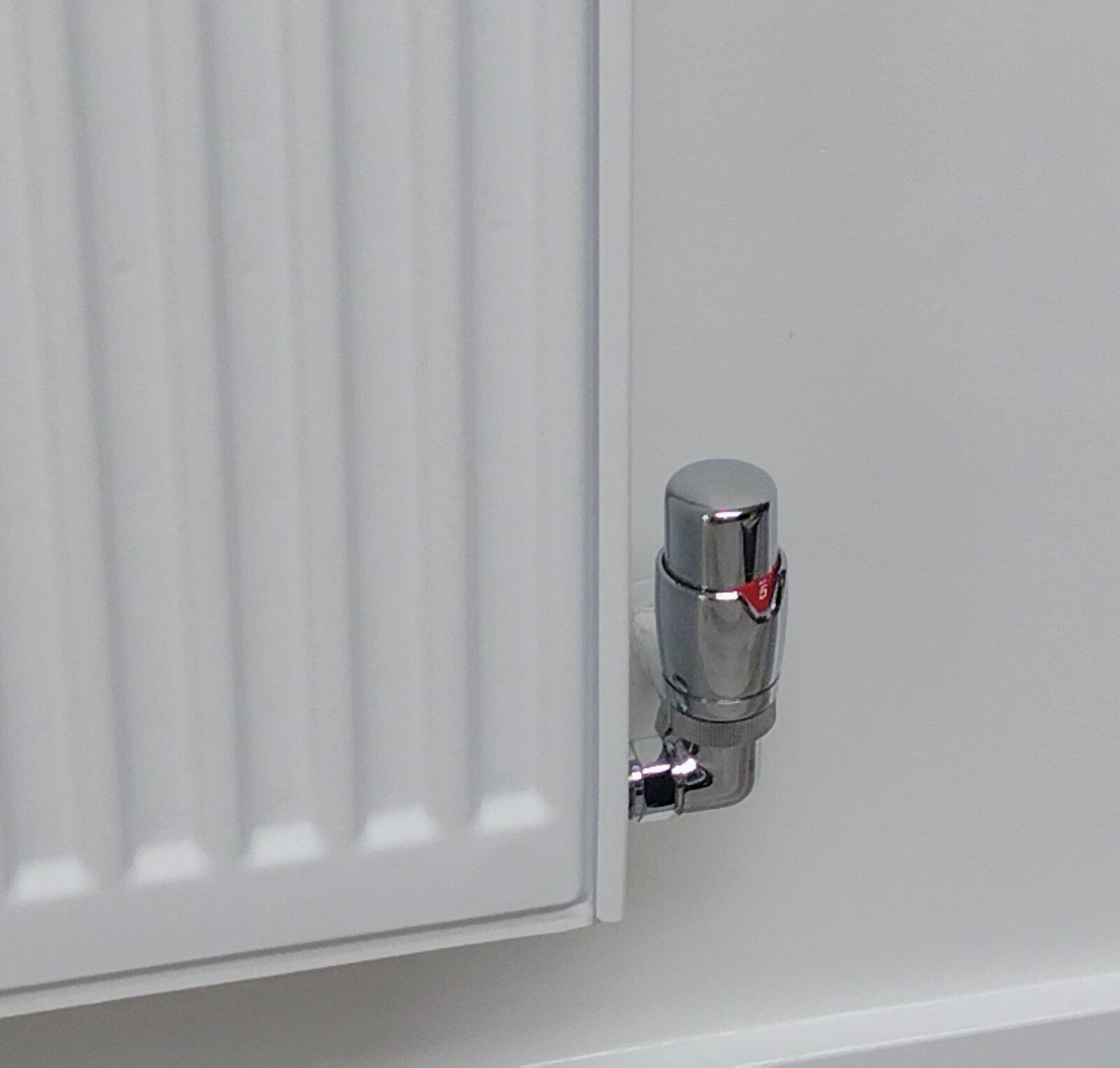

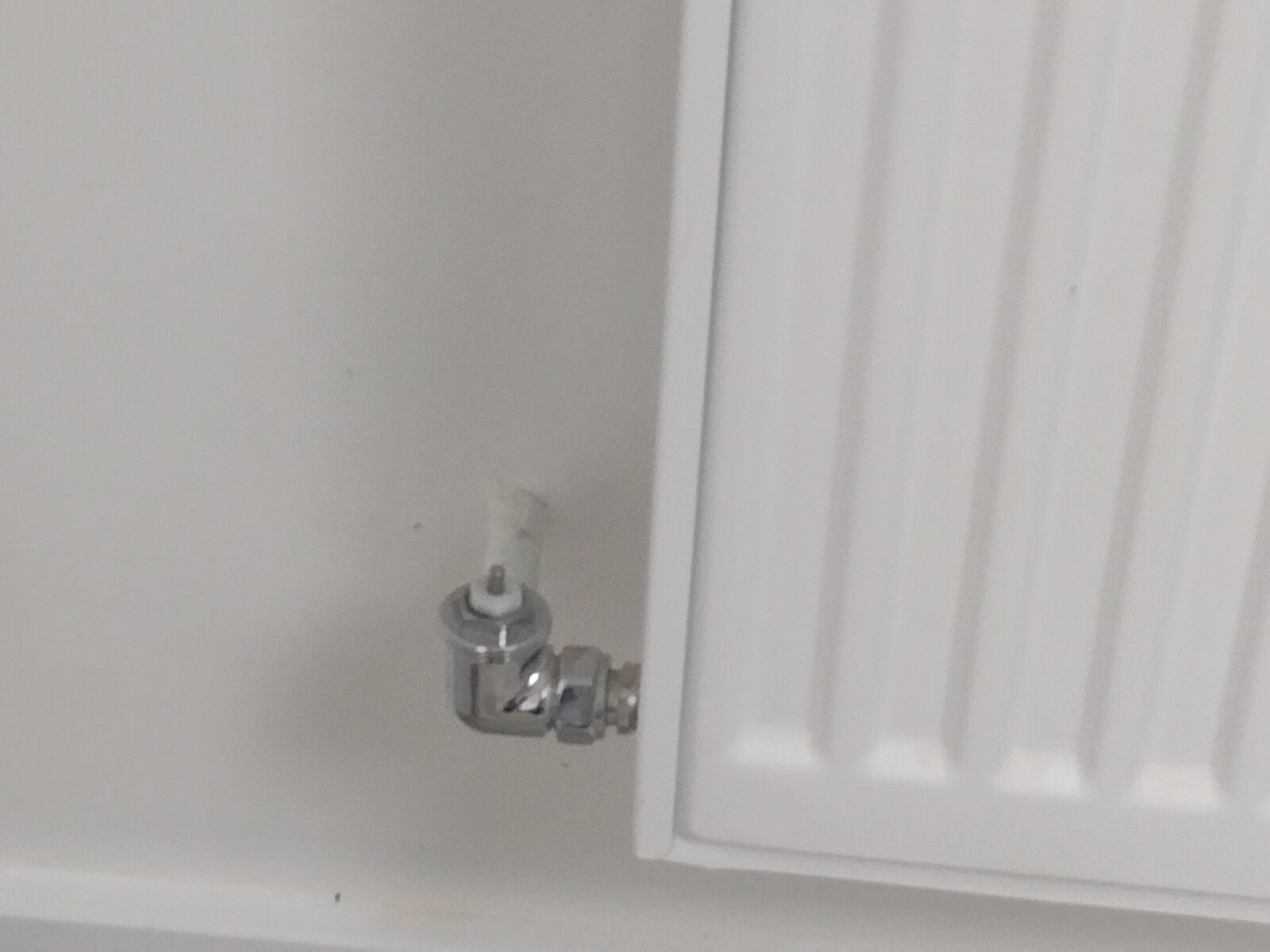

Depends on the valves thread size as to what fitting would be suitable to connect the valve to hose pipe. Show us pics of both valves.
Severely blocked pipework would need section cut out and replaced. Sometimes a blast of compressed air from a foot pump ( as used to pump car tyre) into pipework may shift light blockage ,and that's probably best left to professional plumber, as precautions need to be taken.

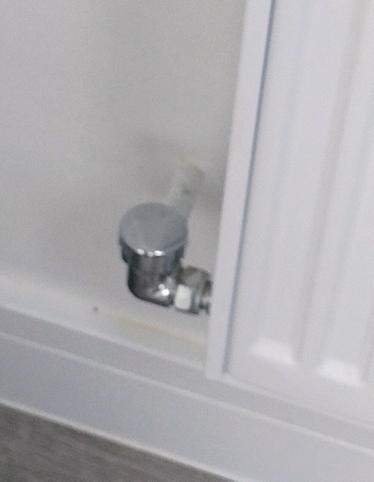

@terryplumb pics of the valves are attached
One end has standard TRV
The other end doesn't have a traditional lockshield. It like another TRV.

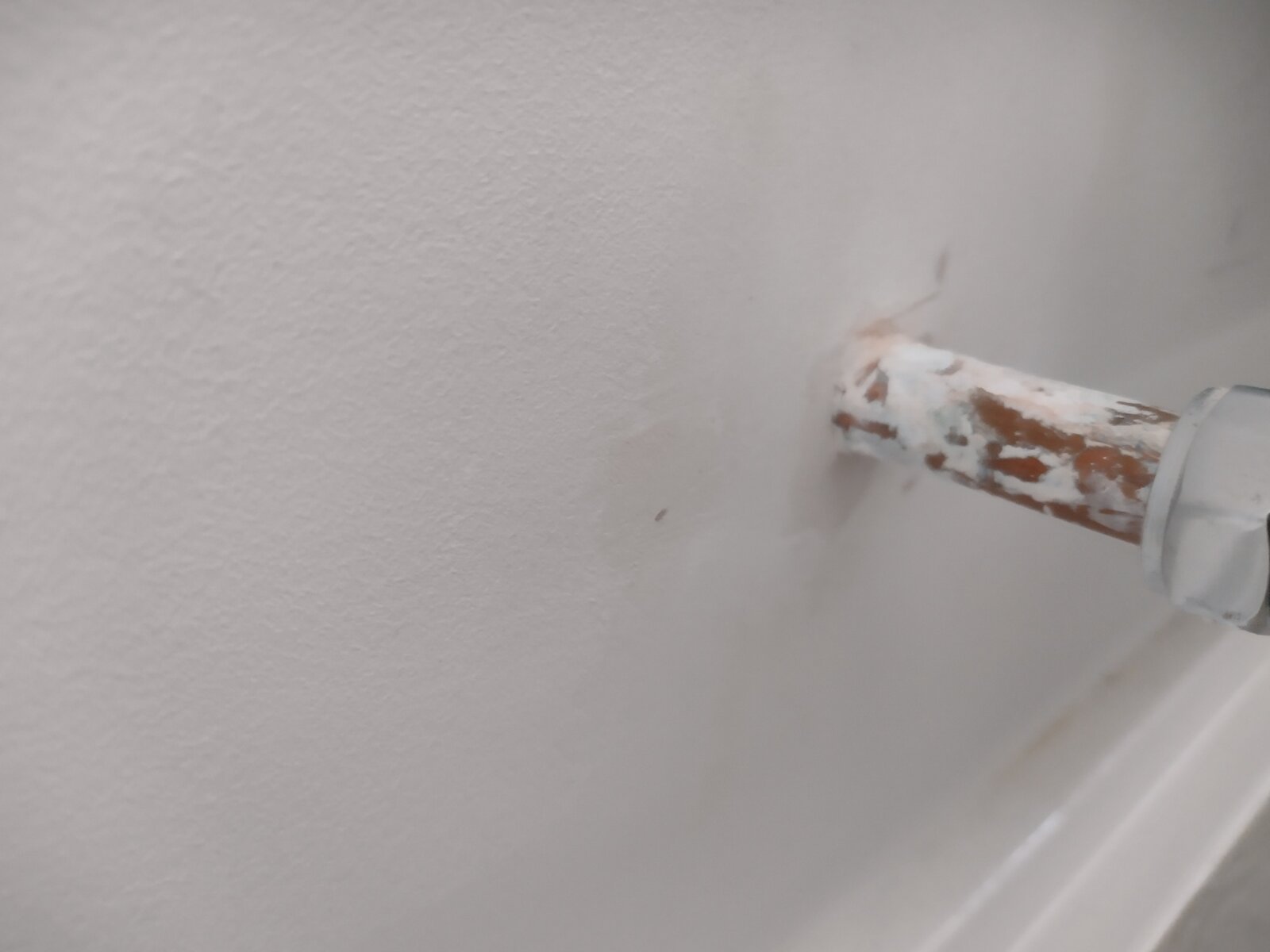

Family are reporting that as the pipework is coming out of the wall horizontally and there is no play/movement in the pipe, getting it off the wall is proving difficult.
The nuts are slacked and the rad has been moved a little to the side to try get the rad off but its not budging.
The last resort would be to cut into the plasterboard.

If you really can't remove the rad, drain system ,take TRV off pipe, remove rad ,refit TRV and refill system. Or try another approach ( not as good really).
Reconnect rad to valves and close both valves.
Using the air bleed valve at top of the rad ,open it with key and have large towel handy, water will trickle out for a bit then it will stop.
Leaving the bleed valve open ,and ready to contain water( bucket and towel ) ,open the lockshield valve only. Water should run out the bleed valve continuously for I full minute ( someone keeping pressure topped up).
Then close the lockshield ,and open the TRV, again let water flow for 1 full minute out the bleed valve.
If water ceases to flow from one valve ,that pipe is blocked.

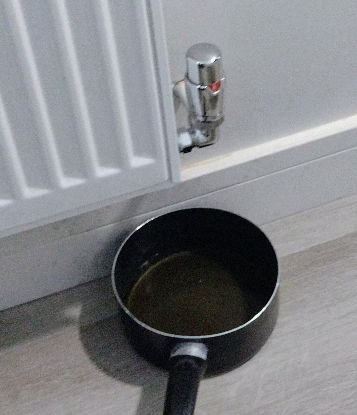

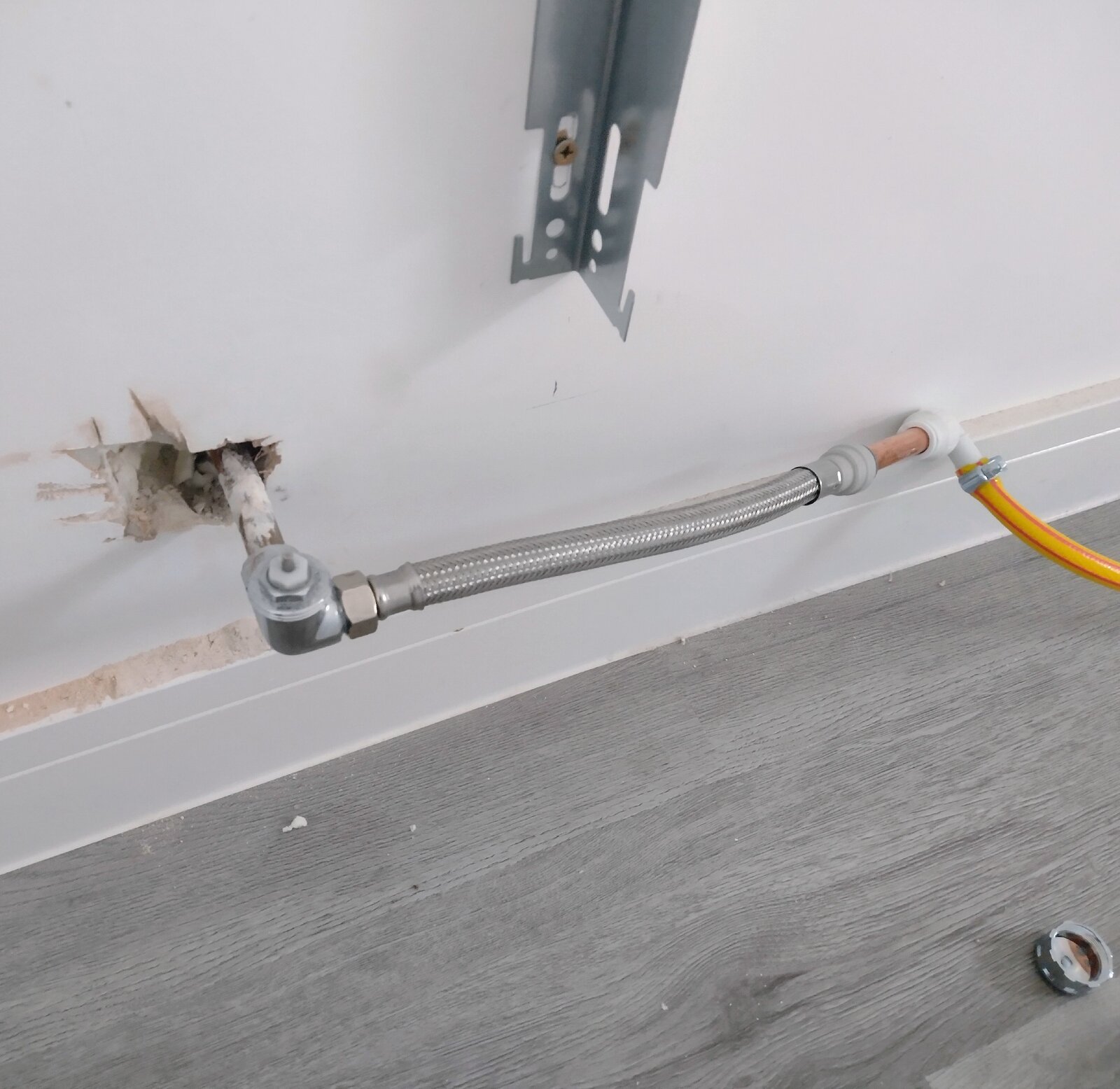

One rad (ground floor) finally came off. Plasterboard was cutout (1)
The system has been drained for over 1 hour now.
1. The upper floor rads appear to be fully drained
2. Some of the ground floor rads were holding a lot of water even after 1 hour. So valve was cracked open to drain the rad direct (2).

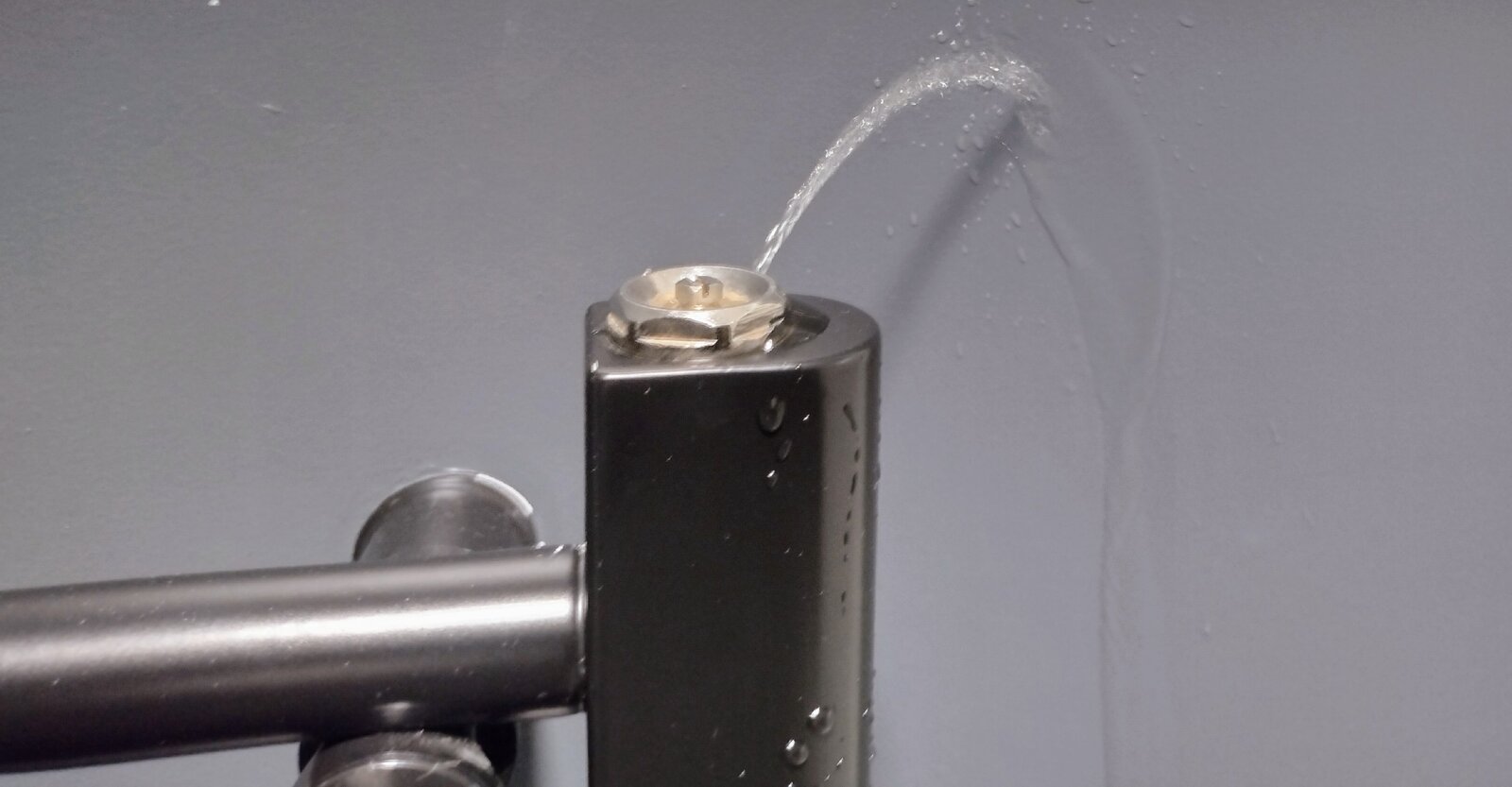

3. After all this draining, water is still shooting out of the ground floor towel rail when bled (3). The towel rail is higher (in terms of heigh on the wall) compared to the all the other ground floor rads.
Does this infer that there is an airlock, or some other issue?

Where on the system are you draining down from ? It's not unusual for some ,or all ,ground floor rads to be full of water when draining from one single point on the ground floor. All rads above the draining point would empty ,others may or may not ,depending on pipework layout.
Ground floor rad in dining room was drained.
On the ground floor we have a living room, bathroom, dining room, then kitchen. One room after the other, in that order
With the living room being the front room and kitchen furthest away in a single storey extension.
Today we'll get the other ground floor rads off and see if there's a restriction.
