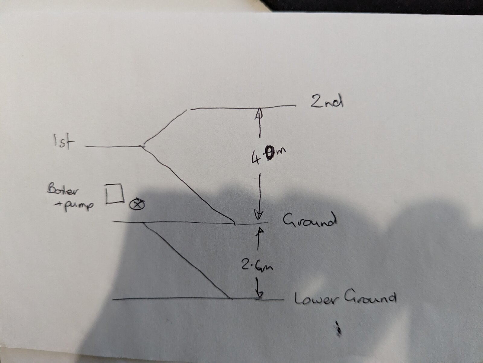

We've got an old Georgian house that has a system operating rads on 4 floors. The LG is 2.6m from the GF where the boiler and pump is located. There are 2 more floors staggered over 4m (see attached). We've not been there long but we've noticed that the 3 rads on the 2nd floor only get hot at the top. All other rads on the lower floors are piping hot.
I undersdtand that there may be sludge in the upper rads but why aren't the other rads affected?
The other problem may be that the grundfos system pump (located at the ground level) was replaced with a cheaper one. I'm not sure of the specs albeit I remember reading that it would pump up to 6m.
Before I remove the rads and wreck the brand new carpets, is there any merit in investigating the pump first and what would be the best way of going about this?

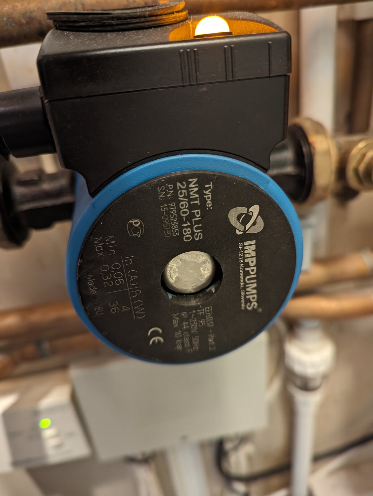

Can you post a photo of the pump label.

Thanks for the reply. Please see the attached photo. There are 16 rads and it's a sealed system which also heats the hot water.

The pump at 36watts has the same power as my 6M Wilo, but I have only 10 rads.

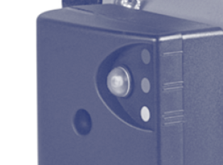

Can you post a photo of the pump controls LEDs etc, while running and info you may have on the pump, normally, these A rated pumps have 3 fixed speed settings, (constant curve, CC) and a number of CP (constant pressure) and PP (proportional pressure) modes.

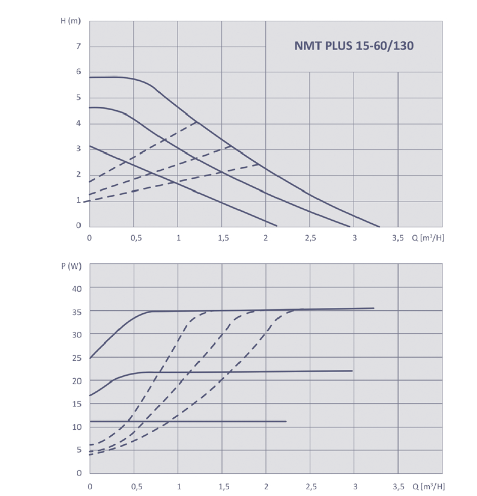

The PDF for the pump is here. I had a quick read of it before posting and I could see that whilst the pump was set to the highest setting (yellow), the indicator was flashing meaning the flow was being regulated. I set the pump to unregulated (indicator on permenantly) and 2 of the rads are now hot all the way down. The remaining rad has a weird connection, flow at the bottom left and return on the top left so only the left side gets hot now so that one will need replumbing. I guess I'm going to need a stronger pump if I want to run it efficiently.
What are your thoughts?
I had a very quick look, it seems you have the 3 traditional fixed speed CC settings and 3 proportional pressure PP settings,the flashng LED probably/possibly indicates that you were on (regulated) PP mode and you will certainly get a far greated head and flow in CC mode which is what seems to be happening now?, can you post a photo of the setting button and LEDs?. That rad will certainly require replumbing.
How do you know what setting you are on, be it CC1, 2 or3 or PP1, 2 or 3??.

Had another good look through the MIs and yes, as you probably know anyway, you have three CC curves and three PP settings and it was set to the highest PP setting (flashing LED), the highest CC setting will give that extra boost.
