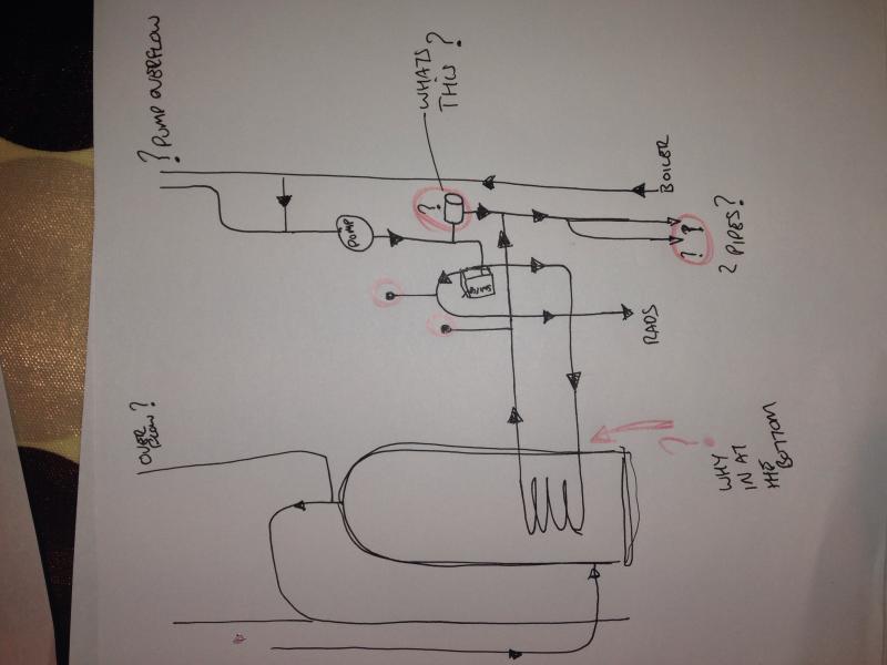

    So here's a diagram of my mangled ch pipes
    Why is there a t off after pump before mechanical port
    Why does that connect to the out flow of the water tank heat pipe
    Why does my inflow to water heater go in at the bottom
    Why 2 pipes going down towards boiler
    What are those weird stand up pipes that go no where for?
    ( the guy that owned this house before me was such a bodger)

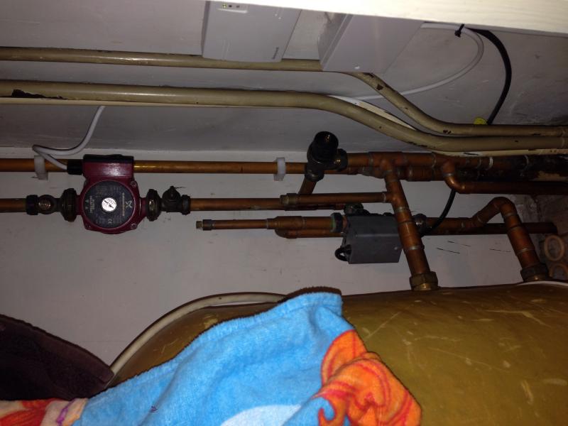

  7. stevesnas
    stevesnas

    That looks like an auto bypass (does it have numbers/pressure settings on the top of the black knob?) feeding into the Boiler Return. Do all your rads have TRV's?
    The smaller 2nd pipe could be the return from the upstairs rads but would expect to see 22mm there unless there's a rad close by.
    The 2 'standy up pipes' are manual air vents

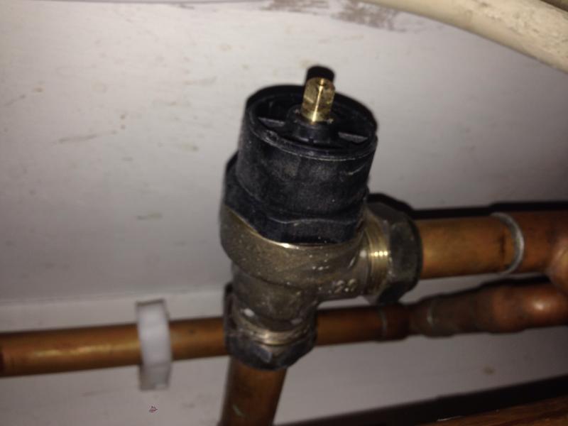

    Only a few have the 3 regular ones on 2nd floor
    Bath rad on second floor and all other rads have basics lock valves
    Can't see any numbers on the bypass pic attached
    Actually one small rad on first floor has a trv ( we currently have this turned off and lock valve off)

    Ah ok, looks awfully like a honeywell auto bypass with the red head taken off, presumably when it was set.
    Reading your original post that you get CH when the hot water is off/satisfied sounds awful like a W plan setup, which gives HW priority at all times.
    When the rads do get the heat, if most of the rads have manual lockshied/twist valves then it could need properly balanced. What speed setting is the pump on?

    OK Doesnt seem like I'm on a W plan as, when heating and water both on this morning - both sides of mechanical switch were getting warm.
    Now beginning to suspect the auto bypass valve.
    According to the specs of my boiler (BAXI solo 18HE) it doesn't require a bypass.
    Could a wrongly installed bypass be directing heat from the radiatos and water tank.
    Given that someone helpful removed my plastic cap of the DU145 can I just screw/wrench the valve shut? Anything I need to be afraid of?

    Does the bypass pipework get hot at any time?
    The bypass may be a hangover from an earlier boiler and yes it could be causing problems.
    Turning off a rad really shouldn't lockout the boiler unless it causes it to overheats but that's really what the bypass is for.

    1a. Why is there a t off after pump before mechanical port1
    1b. Why does that connect to the out flow of the water tank heat pipe
    That's an autobypass
    2. Why does my inflow to water heater go in at the bottom.
    No reason why it shouldn't. Some say that, in theory, it is better that way round.
    3. Why 2 pipes going down towards boiler
    Are you sure they both go to the boiler? Where are the returns from the rads connected?
    4. What are those weird stand up pipes that go nowhere for?
    Air vents
