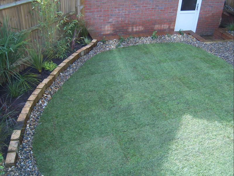

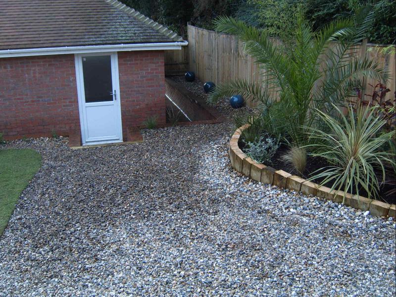

How easy would it be for me to create a low wall, maybe 2-3 bricks high? im thinking one brick below lawned area then two above ground, or maybe eben half brick below lawn the one and a half above to raise border that way....
Would I get away with single thikness? and how about foundation wise?
More ideas always welcome...
patience is a virtue. some of us have work to do you know! :lol:
single skin is fine at that height and that purpose, i normally lay the top course frog down to cap it off. As for the foundation, go for about 1/2 brick below ground level. A small footing is all thats needed, about 8inches wide by 4 inches deep will be more than enough. Try to keep the brickwork to the outside edge of the footing so theres not a small amount of topsoil on top of the footing to be covered by the grass.

its the indentation in the brick that the mortar goes in. normally laid facing upwards, but you can turn the brick upside down to finish the wall

Just one last quick one, if wall is to be 3 course high.... and run the length of 65 ft, how many bricks do you think ill need?
65' = 19.8m
common brick length 215mm + 10mm mortar = 225mm
19.8 divided by 225mm = 88 bricks per course
3 brick high (3 x 88 = 264 bricks)
So ill round that up to 300 to make sure ive more than enough....
