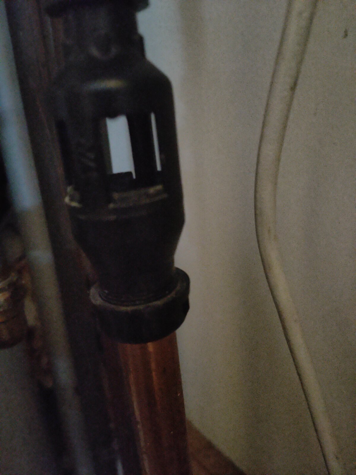

Hi
Can some one help loads of boiler issues over the last two weeks with no pressure and leaks. This is now fixed just waiting on another part. Should it be like this as the black gadget on the pipes was not there before and there is a constant drip with in it. The electric is constantly on and is heating the water but not keeping it warm after two showers. Plus pressure dropping from 1.5 bar to 1bar. We are having to keep topping up. Can someone help with reasons why please

The black part is a tundish. It would have water dripping through it when there is an issue ,such as excessive pressure,and under normal circumstances wouldn't have water dripping through it . Only a G3 certified engineer should be doing work on unvented cylinder by the way.

Thanks for that information the engineers coming out are G3 certified but now one seems to know the answer to what's happening or why it is happening. Next guy coming out on Monday with a part. Should I be expecting that the tundish is left on and not dripping. And can I ask where that drip is going as we've already suffer water damage from the problem and on going issues with this system over the last 7 years with lost of heating for 4 weeks and water damaged ceilings. In 2010 the water leaked and it was so bad it was like a water fall into the hallway and to remedy it they just repaired it. Should I be asking for it to be removed?
The pipework from the tundish should continue to a safe place to discharge. As already said, under normal circumstances it shouldn't have water running through it ,it's there to alert you to a problem, when you see water dripping through it something's wrong !

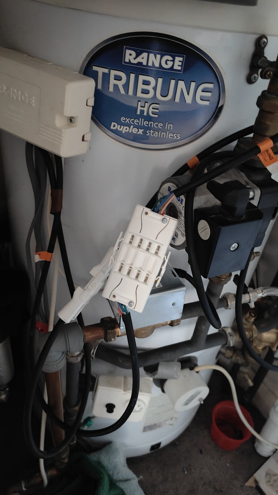

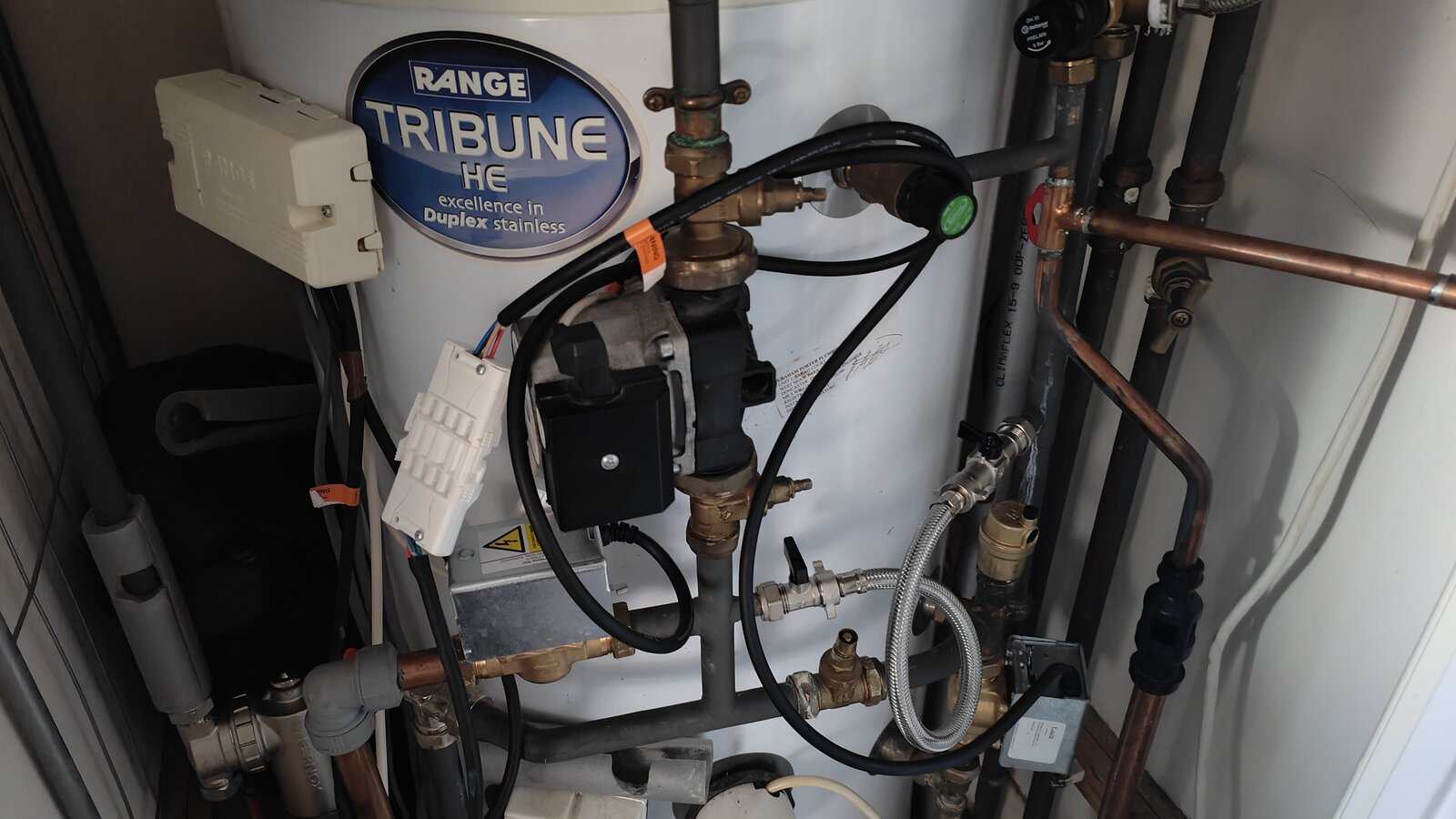

Hi Guy me again still issues with my invented cylinder again when gas heater was on the heating turned on. Engineer fixed the issue and saw d it was the switch but has now put his contraption on the boiler. What is it and is it dangerous as this is in my son's bedroom. Now my water pressure is dropping resulting in no pressure so the water will not warm up unless I pressurise the tank with the filling loop Help please with advice about to call them out again in my 6 Weeks saga
