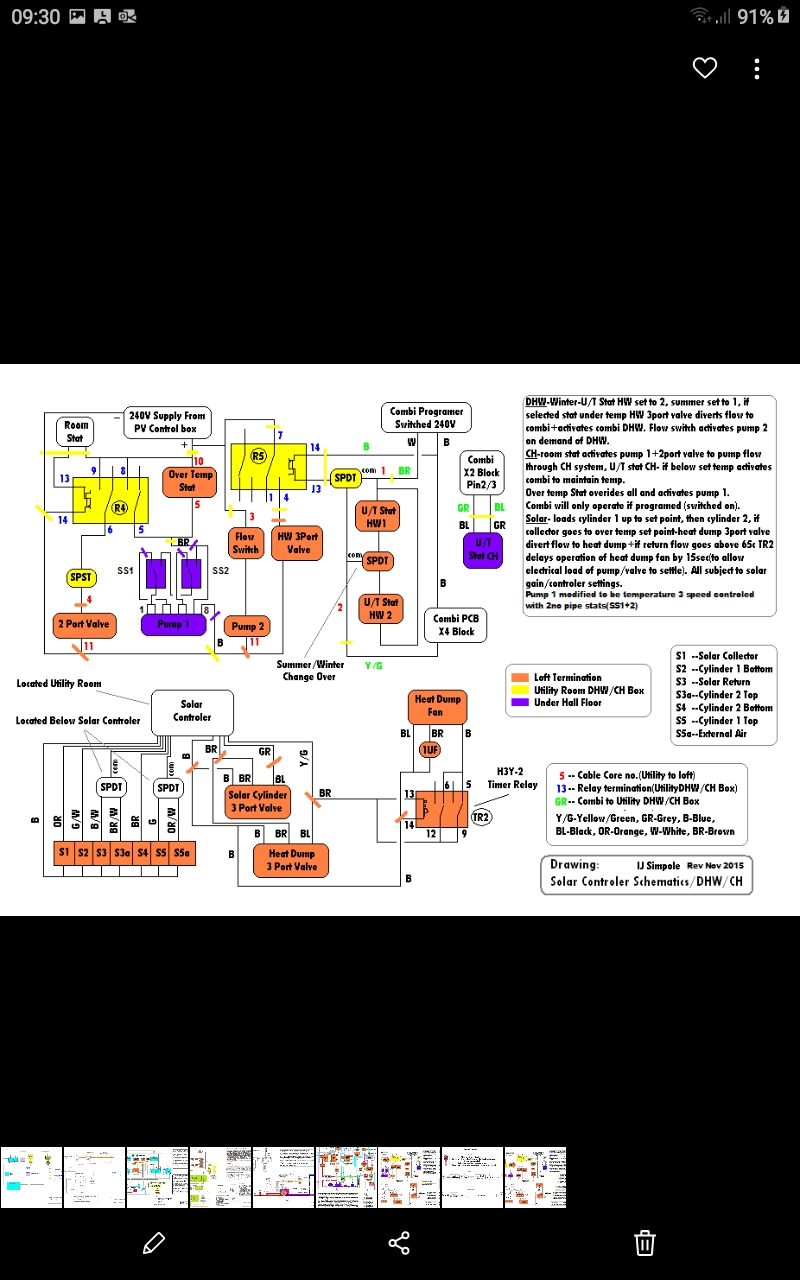

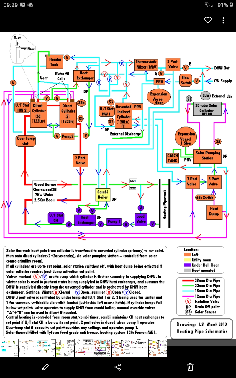

Has anyone used a raspberry pi to automate thier house heating/ventilation?
I have a quite complicated system which has wood burner(plumbed in with back boiler) combined with oiled fired combi boiler(fed into rads via plate heat exchanger), mechanical ventilation with heat recovery, solar thermal, solar pv(with diverter to heat water tank / convector heater), 3no. Hot water cylinders (due to space restrictions)- 1no. Pressurised +2no. Gravity fed, a fair number of pipe stats, 3speed rad pump rewired to run at speed dependent on water temp ect ect.
Already have a couple of rasberry pi's used for streaming and they have capability of running countless temperature sensors / relays ect. Plus my boy can program the pi and get it networked / viewable on smart phone /internet.
Anyone with any experience with pi and automation, I would love to hear your what it is capable of.
Let me think about it.
To give an idea of what I'm looking at controlling / monitoring attached a couple schematics of current system. All running ok, just looking for rasberry pi to control / monitor / log, plus would give easy access to view via smart phone.

Take a look at Home Assistant.
You also might like to look at Arduino - IMHO more suited in some of the scenarios you may be looking at. And nothing to stop you mixing the two - arduino for sensors/device control, and HA running on a PI for combining everything.
