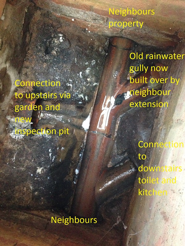

We had a rear extension built in Autumn 2014. We discovered we had a problem with rats. We killed them with poison. They came back. We killed them again with poison. They came back again.
A long story short(ish), they have been getting under the house and then coming up either through the new cavity wall or behind the oven, up through pipe runs etc. I've blocked all these off over the last 3½ (barring the small hole in the cavity wall behind the oven which is the last to do) but know prevention is better than cure. I don't want rats living under my house.
We paid for cctv drainage investigation in 2015 on the advise of my last plea-for-help to sort this problem (see link above). They found nothing. We've checked and rechecked the state of all external walls at ground level (front and back as live in a terrace). There are no holes, only air bricks. On the rear 5 air bricks, on the front 3 air bricks - an older design but still secure.
We'd already decided it must be the sewers so last year when they returned we asked Thames Water to come out and have a look. Our rear extension was built on top of the old inspection manhole but another was put in the garden. They discovered the old inspection pit was badly damaged. Cue floor up, old manhole cover up and a full repair. The gaps in the side of the manhole were big enough to allow a rat to squeeze through, presumably under the concrete floor for the new extension and in to the main part of the house where it is a suspended wood floor. This was July. Result. No more rats.
Until this month. There must have been a little poison left down there following my last cull last year as the cat did its usual pacing around the kitchen floor for a week and then the unmistakable smell of rotting rat coming up through the floor. I took up the corner of the living room floor again this week for the umpteenth time to put more poison down and when I had checked it the next day again it had been nibbled.
I am totally out of ideas with how to resolve this. TW are reluctant to come out again as they say they've solved it and repaired the manhole. They also checked right up and down the sewer in to neighbouring properties at the time and found everything to be secure.
I've had the council out before who told me I didn't have rats (despite seeing two in my house over the last 4 years) and am unsure where to go from here. I want the problem solved as I have three very young children and rats are not the most hygienic house visitors we have.
I live in a terrace and none of my neighbours have this problem. I don't believe them to be coming along the terrace or anything like that - there are solid brick walls between us all which must be supported down to foundation level surely?
So, has anyone ever paid for any of the 'survey' options from the likes of Rentokil etc?
Are they worth it/did they solve the problem/guarantee?
My only crumbs of hope are that last year when we had a loft conversion put on our house that maybe the extra weight has caused some sort of sewer problem/damage (this is since TW came) and somehow this has caused a crack and they can get in again somewhere. Otherwise I don't know what to suggest...

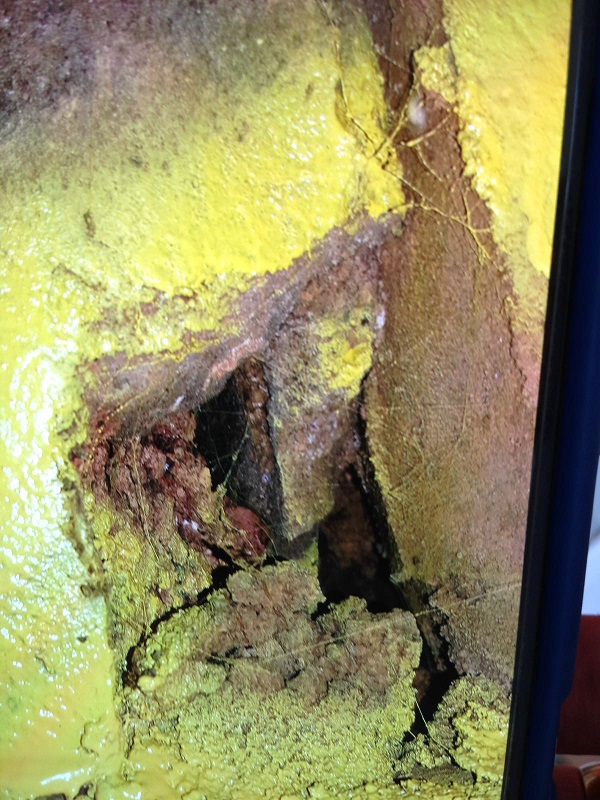

Added a couple of pics of the sewers. Not really sure it helps but hey...

I'm no drain expert, but the entry into the inspection chamber from upstairs looks like it's angled against the flow and kinda just thrown in.

Your story sounds very familiar. Over a year ago we had a very similar problem which went on for 5 months before we finally solved it. We had a new extension built 4 years ago at the back of the house (7m x 5m – big enough) which involved new sewer pipe connections, build of a new sewer chamber and blocking up of old sewer connection. Extension floor (concrete raft) was built over sewer pipe, and builder did a great job and all was well. However, 3 years later we started hearing noises under the suspended floor of the older part of the house, and on investigation it was clear we had rats. We laid poison and blocked up with steel wool and concrete/expanding foam where we *thought* they were getting access to the house (under a section of new decking) and thought we’d solved it. Couple of weeks later they were back. More lifting of sections of suspended floor in older part of the house, laying of traps, use of motion sensor cameras – all of which told us there were 3 or 4 down there at any one time. More theories as to how they were getting access, more lifting of sections of floor, more rat traps and poison etc. We’d have a period of 2-3 weeks of quiet (and awful smell from decomposing poisoned rats) and then they’d be back. We’d employed a domestic pest company by the way, but all they could do was identify what they thought were potential access points, and lay more poison and/or traps. Again a couple of weeks quiet, then they’d come back. Incidentally, we caught very few in rat traps – they seem to be extremely smart and wary of them!
In desperation one day we rang Rentokil, and spoke to one of their surveyors. After telling him the story he said it was pointless getting them (Rentokil) out (as they’d just do the same – lay traps and poison), but he recommended we get a CCTV survey of the main sewage line done, and gave me a name and number of an expert. Needless to say I got in touch immediately and they came out and surveyed the main sewer (which was now under the concrete extension). The video footage identified the problem – there were 2 sets of excavated debris at 2 separate points, where the old sewage connections from our house joined the sewer pipe. The guy said this debris was from the rats excavating the infill to gain access to the house. Bear in mind these old connections had been blocked up 4 years ago at the time the extension was built – I’m assuming by pouring concrete down from our end. The surveyor said this often happens – rats at a later date can start exploring and then excavating these. The debris in the pipe was evidence of this. Solution was 2 in-pipe fibre glass re-linings and he was 100% adamant that was where they were accessing the house, and equally adamant that if we re-lined the problem would be solved. I liked his certainty, so they came back a week later, did the work (expensive – ouch!) and the problem was solved. That was over a year ago and we haven’t had a problem since.
Moral of the story – you can’t keep poisoning them as they’ll keep coming back once there’s a way in. If you can’t see the way in get a CCTV survey of the sewer pipe – if we’d done this earlier we’d have saved months of stress, annoyance and disturbance (opening up sections of floor etc.). I'm happy to say the problem is solved, but it was an awful 5 months and I wouldn’t wish it on anyone.
