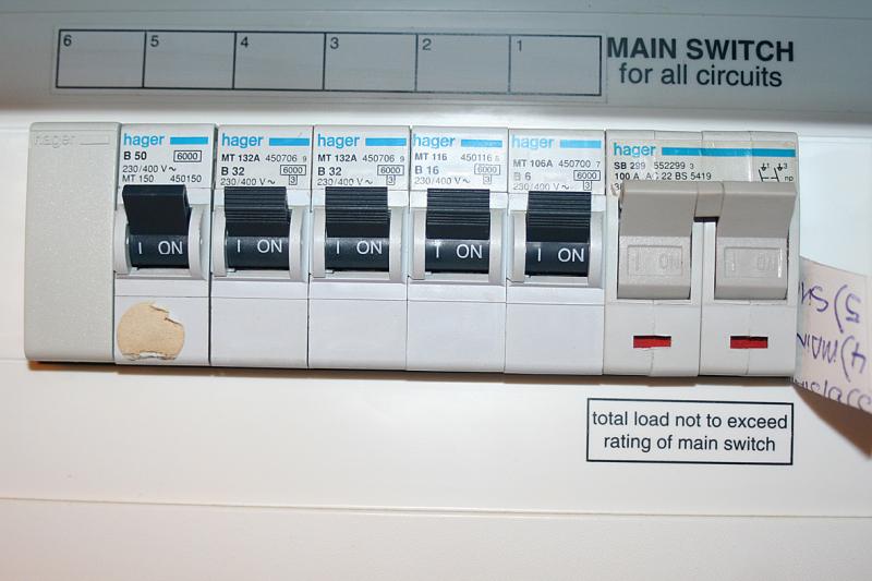

Hello.
In another thread (see link below) a RCBO was mentioned with the link, http://www.sparksdirect.co.uk/hager...stic-boards-mcb-50a-rcbo-type-b#.VM_Fz8ZrjmR.
Just about to purchase when I noticed on eBay this one as it is a little cheaper?
http://www.ebay.co.uk/itm/HAGER-RCB...-FROM-6-50-AMP-Combined-postage-/301077914934
Please can you tell me if this is the same item as it is a few quid cheaper.
I/we do appreciate all your help and advice.
Read more: http://www.diynot.com/diy/threads/replacing-shower-electrics-info-please.423476/page-1#ixzz3QcAOYcwc

Even a slight strain on the terminals of a RCD / RCBO can cause them to malfunction so after fitting we test all RCD / RCBO devices with an RCD tester to ensure they trip in the required 40 ms and before it reaches 30 mA and not before it reaches 15 mA this can't be done with built in test button.
I would think it is unlikely if the RCD part of the RCBO works correctly that there would be any fault with the MCB part of the device. So as long as you do the prescribed tests I can't see a problem.
If however you intend to trust to the lord rather than test correctly I would buy it from a trusted supplier.

Once I install the shower, I have an electrician who will visit and fully test the RCBO in situ.
Before purchasing the eBay version I will write to them and ask them if it is a genuine Hagar product. We will see 'how' they answer!
