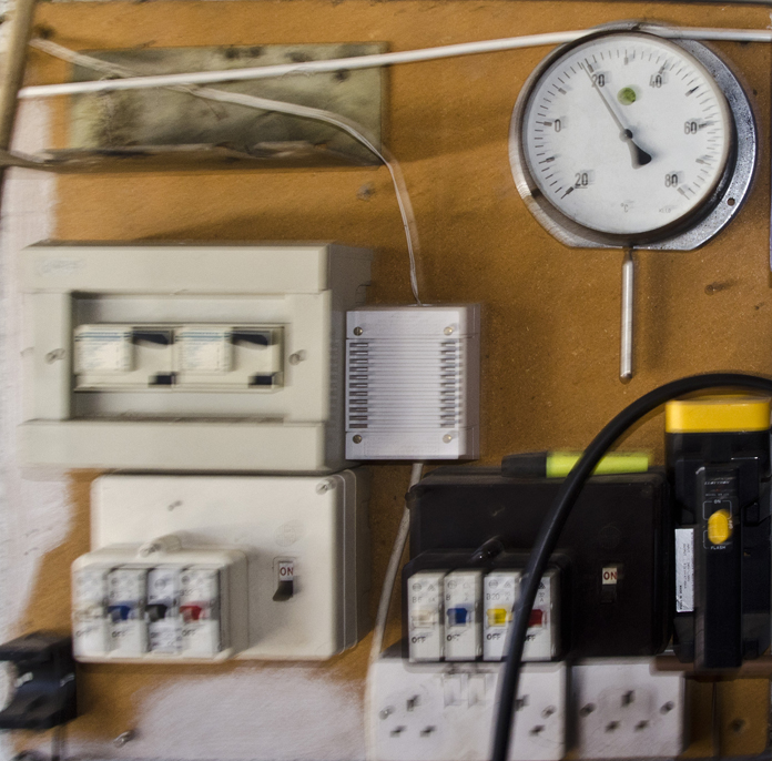

Back around 1992 when RCD's were not required and finding a consumer unit to take RCD's never mind RCBO's was near impossible I fitted two RCD's outside the fuse box. Wilex-board-with-RCD.jpg However today there would be little point, the unit
is discontinued and even second hand cost around £60 each, so yes with the Memera 2000 either swap whole board or a RCD before or after the board.
