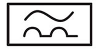

To my mind if it is tested with all connected and it passes, then it would also pass with all disconnected, and the RCD/RCBO should not be disturbed after the test, as strain on the casing has been known to affect the operation of some RCD's, we have manufacturers telling us all RCD's should be tested as type AC and when tested as type A if it exceeds the trip time that is allowed, not sure I agree with that, but it has been said we don't test MCB's trip at rated current so why should we test RCD's as type A, F or B testing as type AC is good enough.
