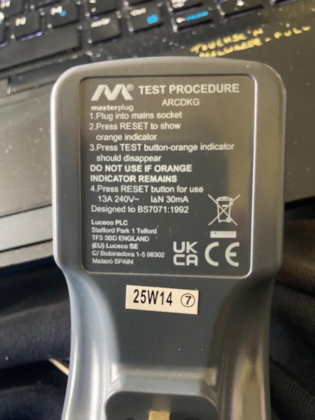

* It can't detect earth/neutral reversal.
They could detect a reversal at a socket on an RCD protected circuit.
Not if they have been powered continuosly for weeks/months.
That design gets rather hot in operation, which is ideal for ensuring it has as short a life as possible.
worse than not using one at all ?easy to mislead as to actually worse than than using one at all.
Hah - I did wonder which one of you would spot that one !*** PEDANT ALERT *** PEDANT ALERT ***
Not necessarily a circuit, just needs a CU updateGet a new circuit in that is rcd protected or bring your installation wiring up to date.

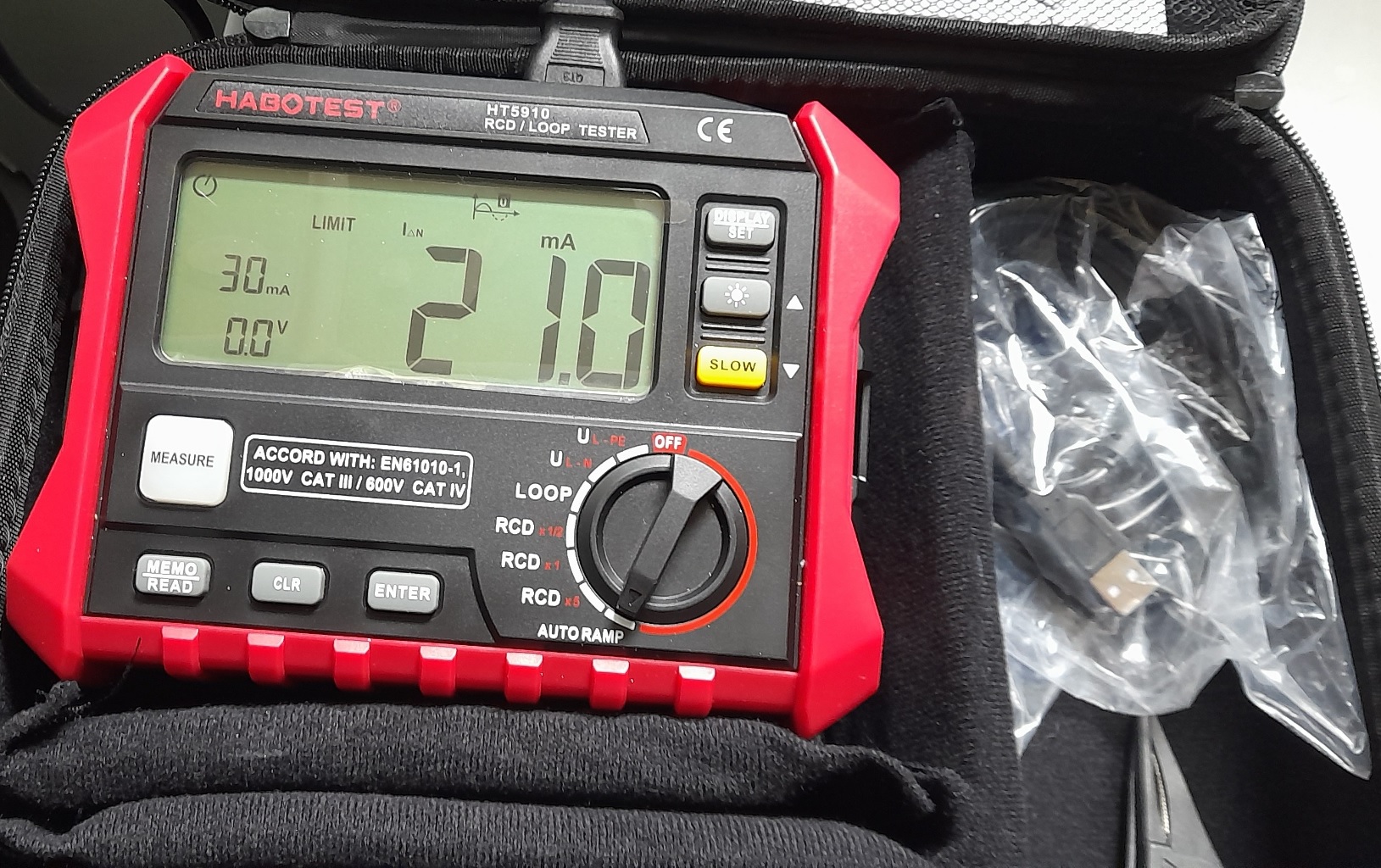

OK, fair enough, I know my clamp-on is not very good with DC, and I would not trust it to show less than 6 mA with a type A RCD, but still better than nothing.Never confuse resolution with accuracy - a resolution of 0.001 with an accuracy of +/- 10% is not an indication of accuracy.
Here measuring earth leakage, essential with RCBOs as when measured
one needs to add the back-ground leakage to the reading to be sure they will trip at 30 mA, experience very early when the RCD came out, showed how a strain on the terminals can cause a malfunction, so all tests need doing after it has been terminated, so one can't disconnect the circuit to test.
