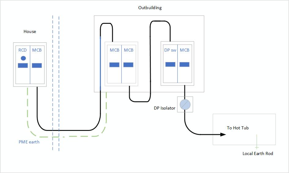

Scenario … a pair of wooden outbuildings, are fed from an 30mA RCD in the house, from the outbuildings a small consumer unit divides it up … couple of AC sockets and lights in out buildings. Then an armoured cable out to a decking area for a 32A hot tub.
The HT has local earth rod.
Previously outbuildings were a TT circuit to local earth rod, house has now been converted to PME and now earth is exported to outbuildings, but not to Hot Tub which remains on its own local earth rod, and protects armours as far as outbuilding.
Sketch attached may help - MCB interlinks etc. left out for simplicitiy
All has been tested and Part P certified by Electrician.

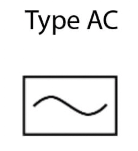

I just went and looked my RCD is definitely Type AC
The symbol on it is as per:
The note he left shows to change to type A.

Well as far is I know, type AC can no longer fitted but you've already got them so cant be forced to change them but he is advising you which is good advice (you don't really want something that isnt allowed to be fitted these days)
Type AC have been banned in other countries including Germany...I think.. for many years.
Type AC for resistive loads only, and with modern equipment that means pretty much nothing. .... Type A is the minimum. .... Some devices may require other types such as F or B.
