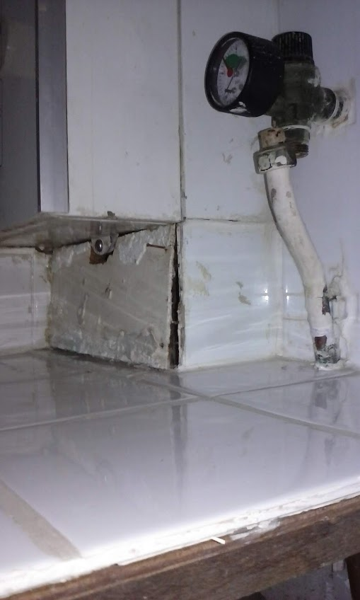

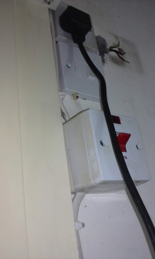

I had that job to remedy.
The shower room had been a cupboard, when converted the cables running top to bottom had been placed in a trunking right beside the glass screen.

I’ve always been a bit amused about the line “passing through “ above! ... Who in their right mind would do this at all?

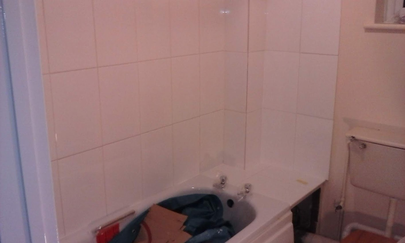

It's presumably fairly uncommon but, off the top of my head, I can think of two houses I've known in which cables of circuits not serving the bathroom 'passed through' the bathroom in the under-bath space.

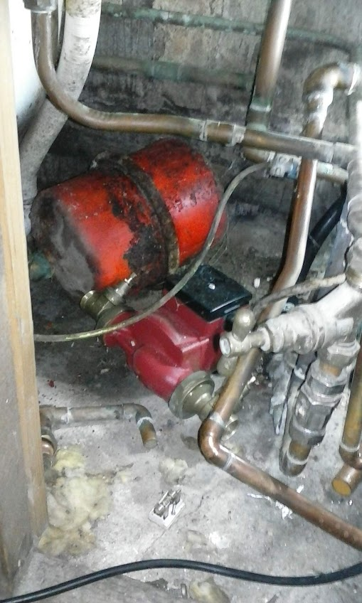

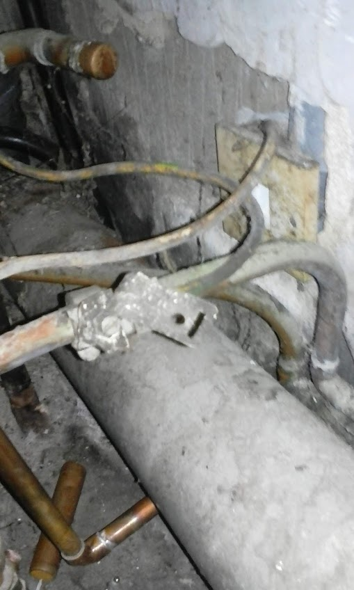

The first house I purchased and reburbished I ran mains and comms cables, gas and waste pipe under the bath but of course it's not a 'Zone' if it requires a tool to access. One of my rental properties had heating pump under the end of the bath and non electric Chaffoteaux boiler above.
How the wetpants left it when the boiler was replaced/repositioned
And subsequent removal

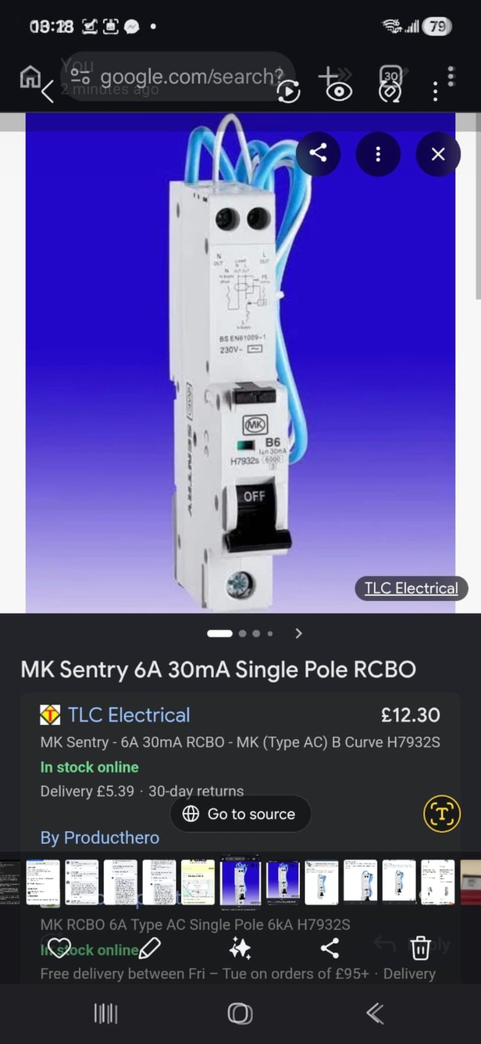

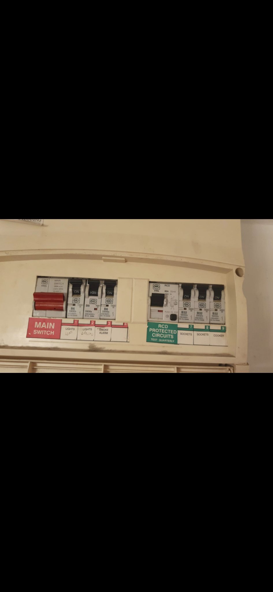

THe consumer unit in pic. Could anyone confirm if they know if the rcbo are compatible with consumer unit ?
Under the bath AND behind a fixed panel isn’t in the zones IMHO
