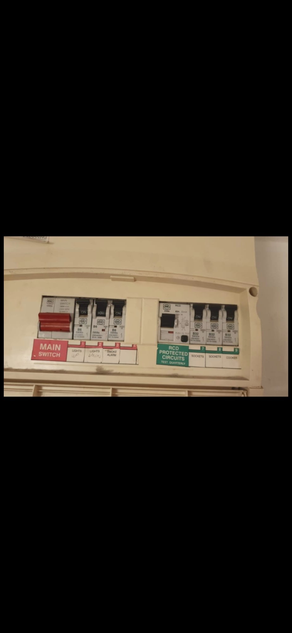

I got a EICR 5 years ago which passed.
I have a dual board with no rcd protection on lights.
So bathroom light have no rcd. Ladt spark passed it as all plumbing in bathroom is plumbed in plastic so I believe this is reason why no supplementory bonding was required.
This is my understanding.
I got a different spark to do this EICR and he has failed it on c2.
Can anyone advise if this is now a c2 please

So you have to act on the new EICR
That board can accept RCBOs but I would recommend you go for a new CU with all RCBOs and surge protection

The light you have requires RCD protection
At the end of the day it’s a rental and you have a duty of care for your tenants
The requirements for circuits in a bathroom to have RCDs protection is separate from whether supplementary bonding is required or not.
All circuits in or passing through a bathroom have required RCD protection since the 17th edition in 2008.
Supplementary bonding can be omitted in certain circumstances, and having RCD protection is one of the requirements for that, but it's not the only one.
In any event, 3 RCBOs for that consumer unit will hardly break the bank.

Thanks, that helps.
So if I understand correctly, the bathroom lighting/fan circuit not having RCD protection is separate from the plastic
pipework/supplementary bonding point, and fitting an RCBO to the relevant lighting circuit would likely remedy that issue.
Which I am happy to do and not alot of money. Easy fix and if brings eicr up to satifavtory Im happy.
The part I am still unclear on is item 6.2 SELV/PELV. The fan appears to be a standard 240V fan and I am not aware of any 12V fan/light or transformer in the bathroom, so it sounds like that item may have been marked C2 in error unless the inspector can identify actual SELV/PELV equipment.
I will ask the inspector to clarify exactly what item 6.2 relates to, and also ask for the exact location/accessory for the other C2 items.
