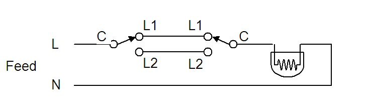

Again, fair enough. What we call "2-way switching" (with or without intermediate switches, which some then call "3-way) is really pretty straightforward once you study the diagrams of how it is done. The only thing to watch is that, at least in the UK, there is the 'old-fashioned' and 'new' way of arranging "2-way switching" wiring. The former is probably a little easier to understand, but the latter offers a number of benefits.

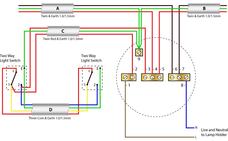

Oh dear John.... I guess I have done it the old way as the diagram I used was in old colours!
I used this diagram (twice)
Will this cause me a problem?
All the best
Andrew
Phew, I thought because of the old colours in the diagram I used I was going to have to change it all. Thanks for the picture of the old way John, it looks like it would be a bit of a nightmare to wire with only one going through the switch.
Even if you had been right, there would have been no need to change it - there must be millions of instances of 'old method' 2-way switch wiring out there. In reality, I think that the move to the 'modern'way of doing it happened long before the colours changed.
