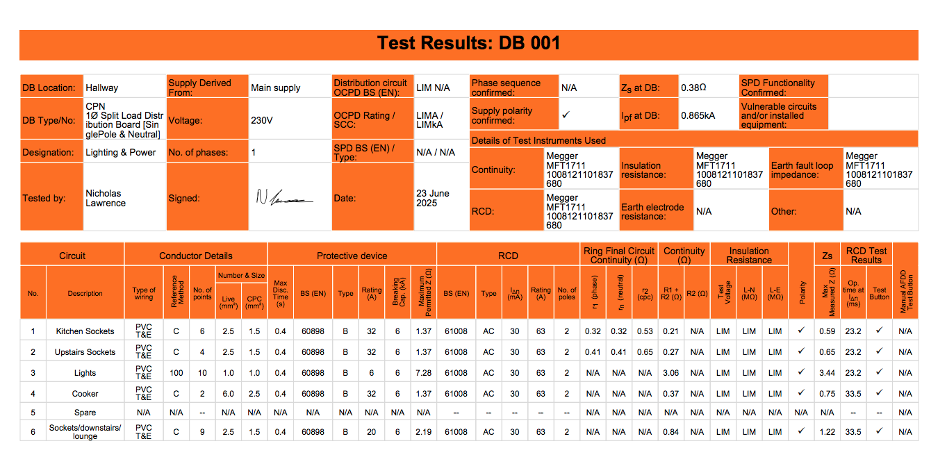

My tenants moved in and they say the rcd is tripping when they plug the hoover in the three rooms in the house but it works ok in the kitchen.
The CU is a split load with two RCDs protecting two sets of circuits.
The kitchen is on a 32A ring circuit where the rest 3 rooms are on a 20A radial.
What are the things I need to check?
The house has just had an EICR performed and all recommendations and critical points were addressed and it passed.
How do I go about tracing the fault.
The only thing I suspect is the previous tenants had an electrician o fit an outside socket on the 20A radial.

BTW that EICR is rubbish and it appears to be dated for yesterday - really?
using LIM for all the IR tests is not helpful to say the very least AND there could be low IR that you are not aware of
Yes I looked at all circuits with Limitation on all IR testing, one could at least lower to 250v and do some kind of test on some circuits. With regards to the sockets they should be able to be switched off and End to end resistances have been taken so not sure why no IR.

You shouldn't have accepted an EICR that lacks any IR measurements. Is there a note stating why there are no IR measurements? Did you say, "I'm a landlord and I need the bare minimum paperwork to comply with the regulations", or did you say, "I would like you to inspect the electrical installation and complete an EICR please" ?

I agree. LIM on all IR readings is unacceptable and IMO constitutes an incomplete EICR. He should revisit the property and complete the EICR correctly.
