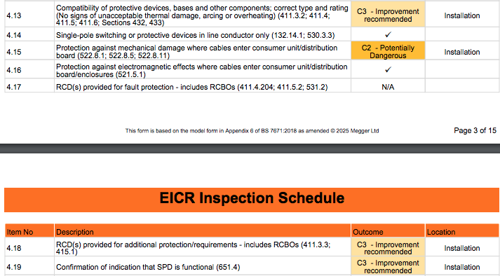

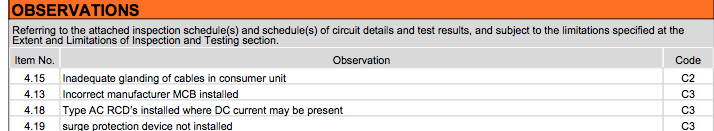

This is the full EICR, I also attach the first results of the EICR that failed, plus the recommendations that were actually carried out.
Quote from the PDF:
‘Insulation resistance testing not carried out due to being unable to disconnect sensitive loads”
