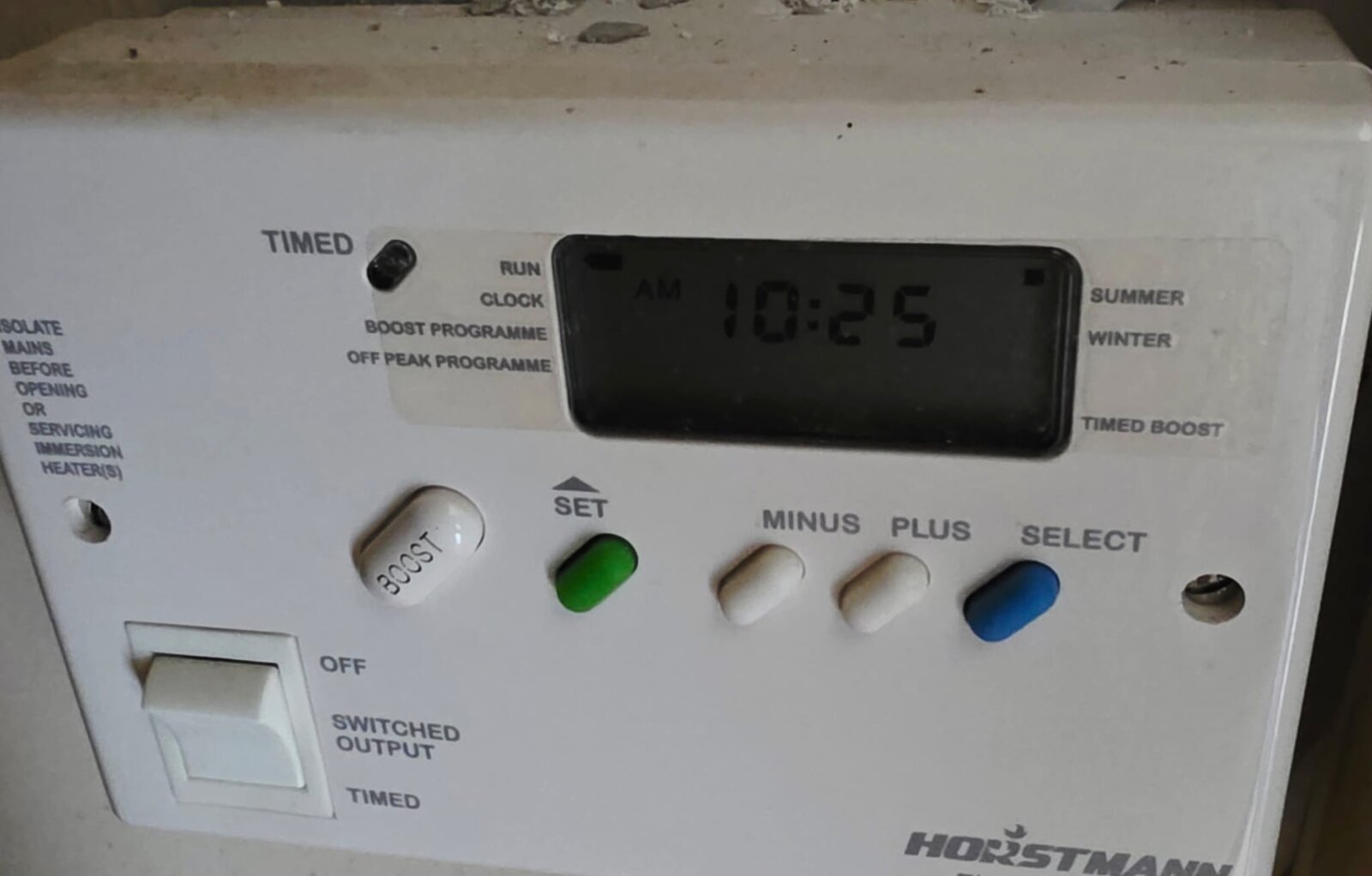

Today I tried to hit the boost on the horstmann, and nothing (electricity usage didnt go up) and it didnt tripped (I think only one element comes on at night.

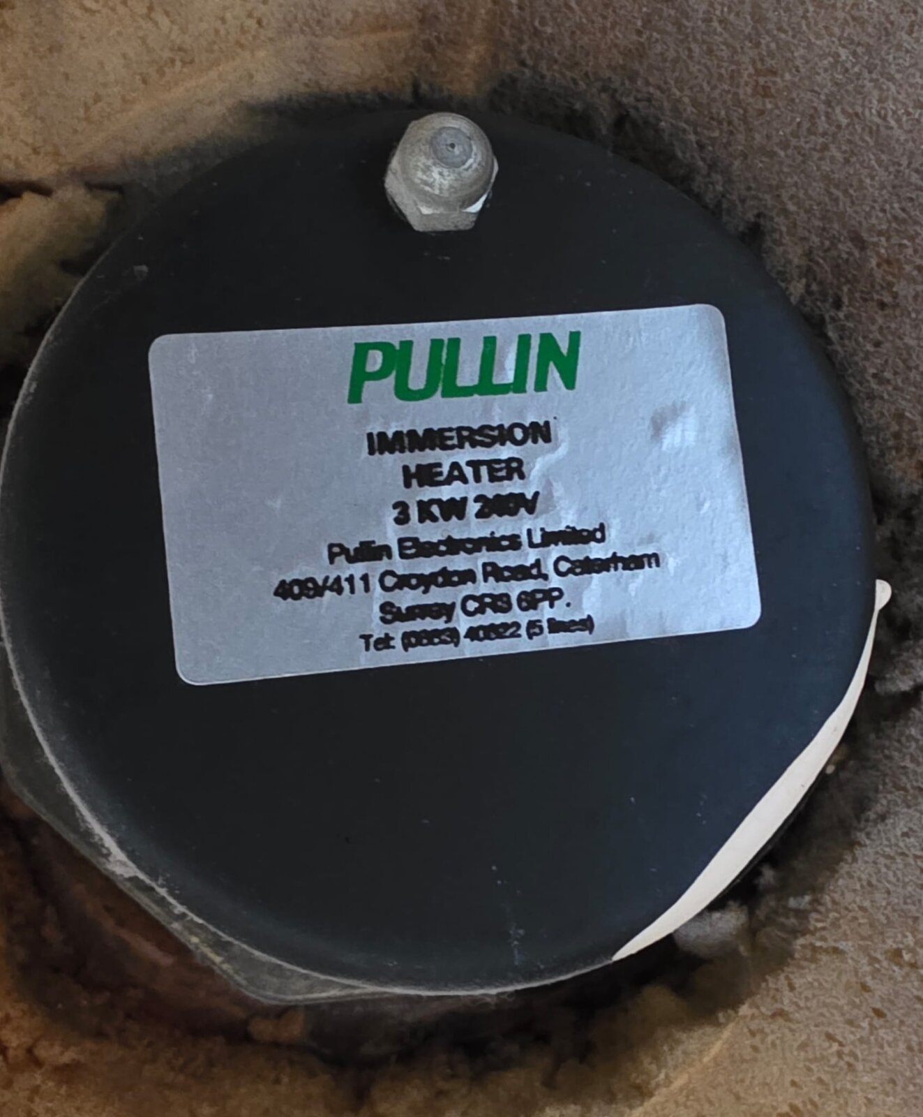

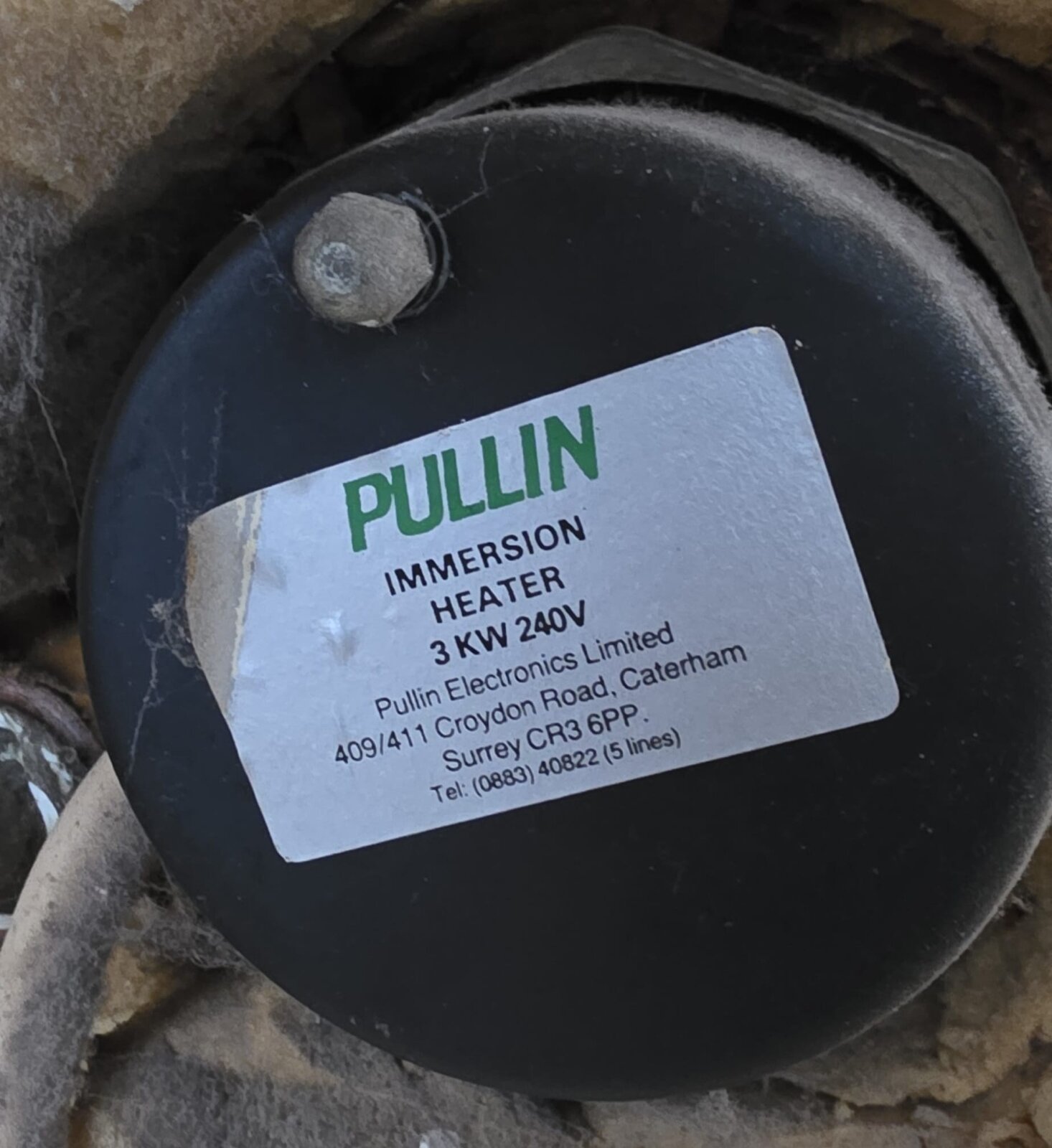

Do I just do a continuity test on the element cable?
Is it something I can change my self? IMG-20250626-WA0004.jpgIMG-20250626-WA0005.jpgIMG-20250626-WA0006.jpgIMG-20250626-WA0007.jpg

How could the Horstmann stay on if the RCD had tripped?

Probably better to check the disconnected element first. L - N, L - E & N - E
Is what something you can change yourself? Element - probably not.

I assume the Hortsmann has a back up battery that keeps it going. I have just tested it, when i turn the MCB off, it still stays on.

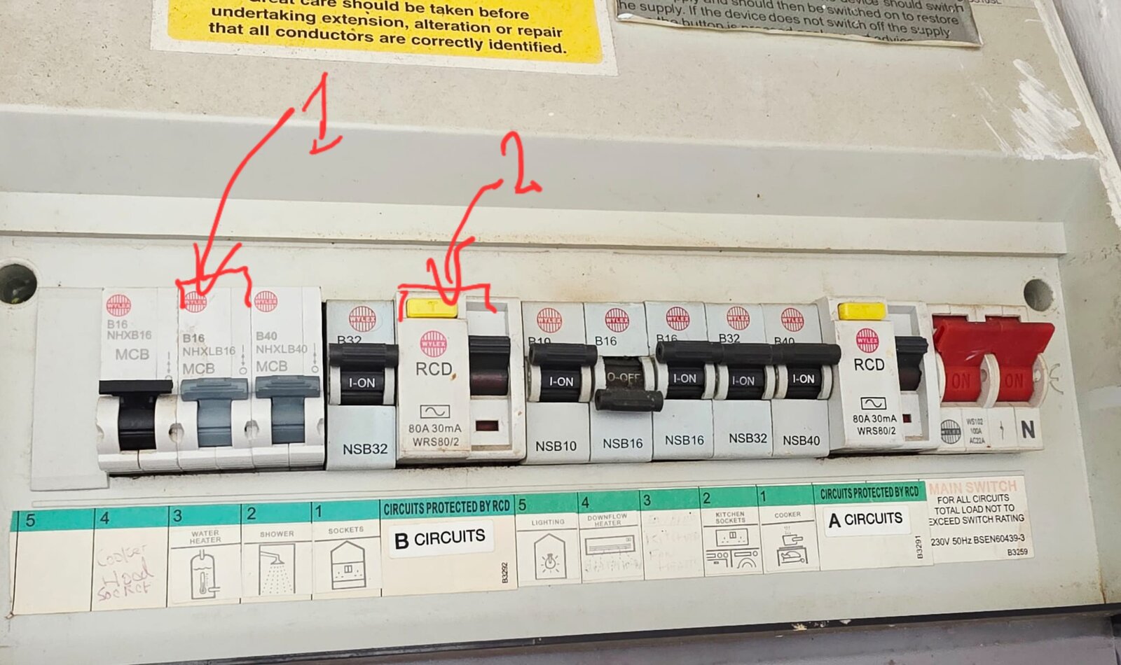

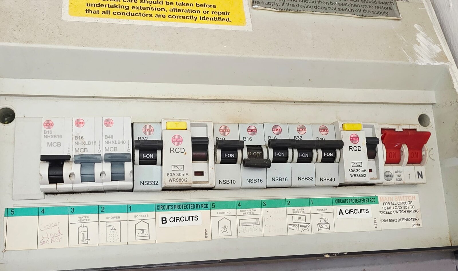

I would call an electrician as not all plumbers know about electrics. Also, the photo of the consumer unit, the MCB that's down, down flow heater - are you saying the immersion is connected or is that not in use?
Ah, ok, maybe for the clock but it wouldn't switch on the element.

That MCB that is down, is a kitchen wall mounted downflow heater i removed. The wiring is still there, and capped. So left that MCB down.
I just realised, I amdidnt attach the annotated pic of the CU.
1. Is the MCB for the Immersion heater - that doesn't trip when the problem occurs.
2. The RCD that trips when the immersion is on.

An RCD checks for imbalance, so there could be a neutral - earth problem which has only showed up with the increased load. I would start by turning all off, then starting with RCD turn them back on, one more at a time and see if anything trips.

It seems likely, that it is the immersion heater element, which is failing, the longer one, used during the night, on E7. Assuming it is an open-vented hot water system (large header tank in the loft), fitting a replacement can be a DIY job. You will need an immersion heater socket spanner, to get the element out, and fit the new one.
The first job, will be to isolate the power, then either isolate the water supply to the header tank, or tie up the ball valve, so no more water goes in, then turn all of your hot taps on to drain the water down as much as possible, before beginning to try to remove the element. There will still be a few pints of water escape, even then, so plenty of old towels ready to catch it, always assuming the elements are cylinder top mounted.
The element will probably be a 27" one, best to get a new, matching thermostat to go with it.
You need to be firm, but also gentle in trying to undo the element - undo a fraction, tighten a fraction, until it turns out easily. Make sure you get/install a new gasket.
Plumbers tell me not to do this, it is more likely to damage the tank, removing it empty, so I employed a plumber to change mine.
You cannot empty the cylinder - You can only drain the header tank down, and pipework, to the highest point of the cylinder. Which in fact, is the top of the pipe, which comes out of the cylinder top/centre. Which was why I suggested lots of towels..
Make sure you crack the element (loosen) with the tank full of water.
