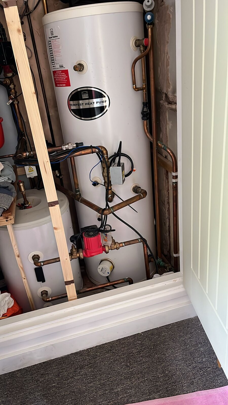

Hi all I have a customer who's immersion heater keeps tripping the RCD sound like the element is faulty.
Any ideas how to drain the tank to replace the element.

Turn the water off and put a hose pipe on the drain on the bottom right, loosen the element before you drain the water
Has this element been tested to confirm?
Could just as easily be something else, given that just in the picture provided there is an open junction box and a whole bundle of cables attached to the uninsulated pipes with cable ties.
Something has been leaking bottom right,
