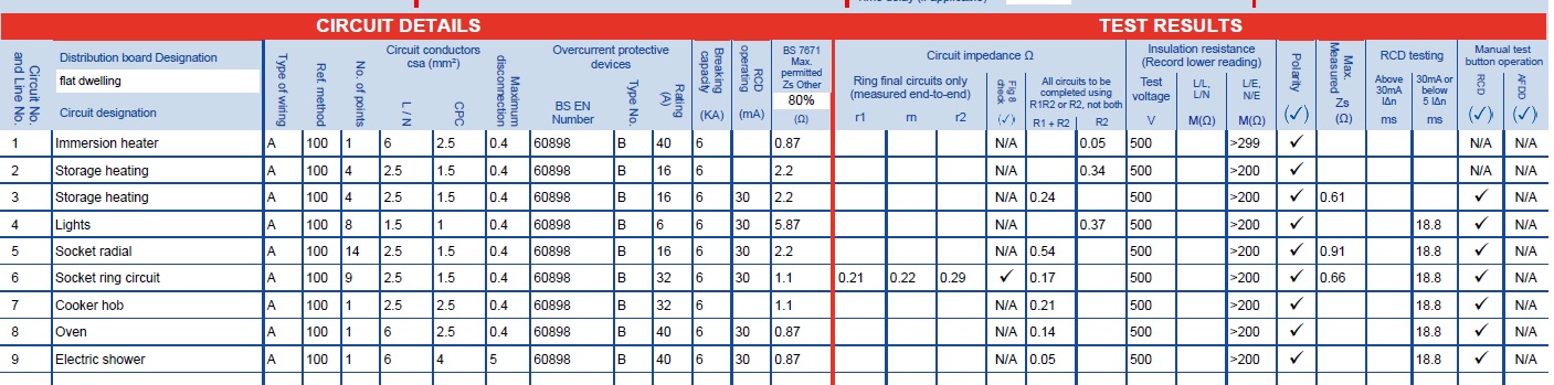

Did you receive any paperwork when consumer unit was installed ,detailing the circuits ,cable sizes / test results etc ?
I think your problem is within the consumer unit . Was it the same electrician that supposedly " tested" the circuits recently ,that installed the consumer unit earlier this year ?
And please confirm that he tested the circuits recently ,without removing the cover of the consumer unit .
40 amp seems a lot for an immersion, are there several storage heaters in the flat?
Could the 40 amp serve another consumer unit for storage heaters?
i got a funny feeling that the 40amp is for both immersion heaters as the paperwork from the electrician when he installed the new consumer unit only had the 40 amp MCB on the consumer unit detailed as hot water heater in the certificate of testing that he issued.
so that when the night immersion heater comes live, it somehow conflicts with the day time one. the 40amp is fine for both immersion heaters as they are 2.4kW rated each.
Fuses and MCBs protect the cables - nothing to do with the immersion - the flex will not be overloaded.
If the cable is large enough for a 40A MCB (obviously might not be), the immersion won't know or care.
I didn't say that, did I?So you're telling them I'm wrong, and that 2.5 T&E is adequately protected by a 40Amp MCB -
Do you not think you should have known it?I never knew that.
Yes, I think so. I am a bit worried about your reading though.Is my spelling OK?
You don't know it is 2.5mm², although even if it is, it likely is adequately protected for one immersion.
That's because a lot of your posts, while not actually wrong, do not tell the whole story.
Immersion heaters are normally wired in 2.5² T&E cable with 16 or 20A protection. So a 40A mcb is double the size required and means the cables could over heat with disastrous consequences. You must get a proper electrician to inspect your installation. A question you could ask to find out if they are "proper" is - "is a 40A MCB the correct size for an immersion heater" he should immediately say "No", any other answer or umming and arring means another numpty, and you have to ring someone else.
