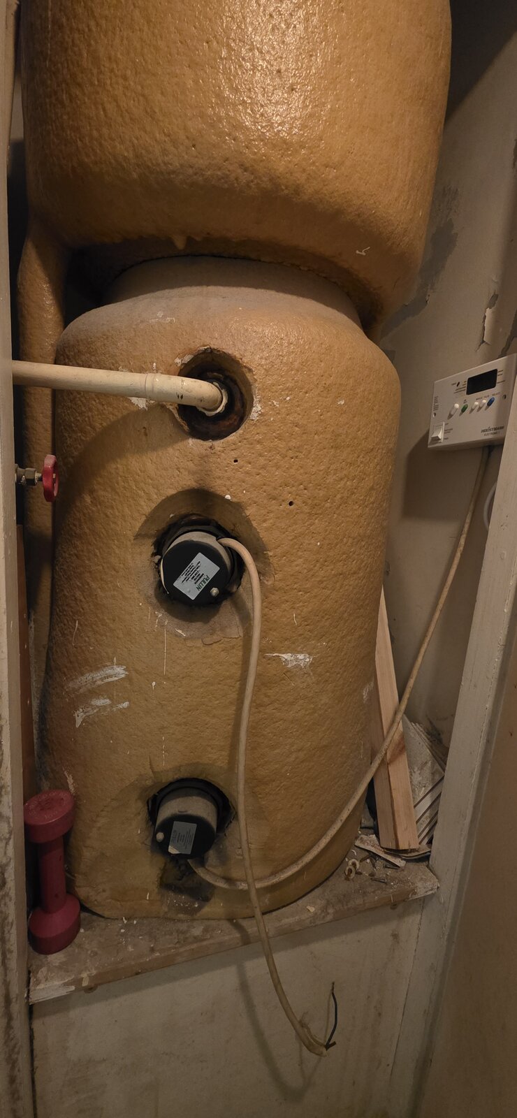

Has anyone said where the element is?
Top entry - as with 27in. - or side entry near the bottom.
Since the two pictures of the nuts on the cover are not aliened the same, I would assume side entry. Of course, it may not even be in the cylinder, but we don't see the Willis system much on mainland UK. Did ask the plumber I got to change mine about Willis, and got a blank expression, so thought saver not to ask for one of them.

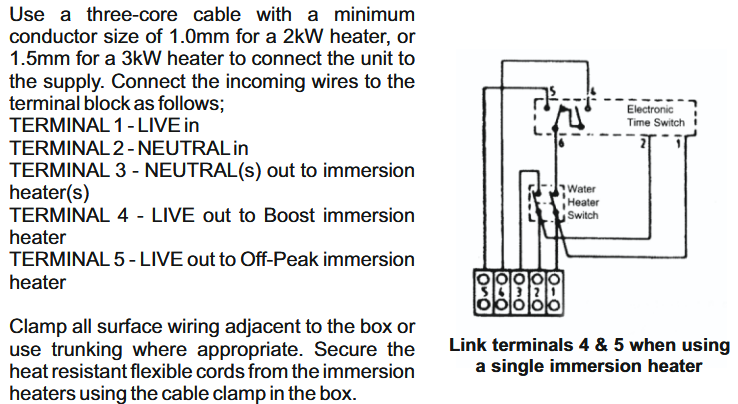

I looked for the instructions to see how this one is wired.
And it uses a single supply, so if either immersion is damaged, both will fail. Darn expensive controller, nearly as expensive as mine which does a lot more, using solar power.
It cost me £80 for the plumber, but the last thing I wanted was a buckled tank, and £30 for the element, and £10 for the spanner, as I don't have one, so his labour cost me £40, he even emptied the airing cupboard for me. I live in the country, so he had transport costs, both fuel and time, and an hour at the house, so he was likely getting less than £20 an hour, so think that was reasonable.
When I was younger I did do my own plumbing, I remember fitting a hot coil in the cylinder when fitting my own central heating, but today I want things done for me, and with things like an immersion heater, when you don't know which one has failed, is it worth £40 for the easy life?

Okay. So given I think it was the boost one that failed (which is really strange), I disconnected it all together and left the wire hanging. I will swap / get it swapped in a few days when I have a bit more time.
The instructions, say that when using a single heater, you should jump terminal 4 (boost) and 5 (off peak) - assuming to allow you to use boost when you need.
Is that safe? - I.e. if the offpeak programme was running and the boost came on at the same time. I assume the heater will only draw whats needed as opposed to getting double the power).
It is safe to do that, with only a single element connected, but with both elements connected and working, it would draw double the current, and trip the supply - so remove the link, once repaired.
