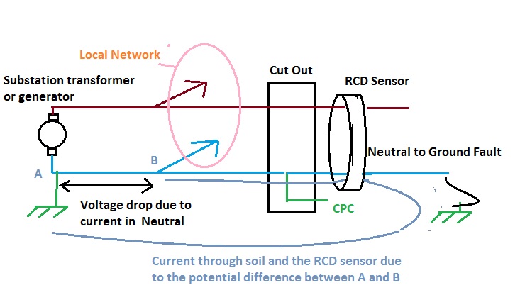

What about a Neutral to GROUND fault where the incoming Neutral is not at the same potential as the GROUND ( not the CPC "Earth" ) at the fault site.
What about a fault on another circuit that is manifesting itself when an unrelated circuit is energised?
I am struggling to see why/how, in terms of RCD operation, that would be any different from a N-CPC fault. All an RCD knows is that there is an L-N imbalance and, if such an imbalance exists, it neither knows nor cares where the 'missing neutral current' has gone. Perhaps you could explain what you are thinking of?
Kind Regards, John
<diagram>
Yes, but I was talking in the context of the OP's situation, not 'in general'. What you describe would be a 'permanent' situation, which would result in the RCD tripping whenever there was sufficient total load on the local network (even if there were no load within the actual installation). AIUI, in the OP's case, the RCD trips don't occur if he isolates the L of one of his sockets circuits (with no loads connected to that circuit) - so I don't see how the mechanism you describe could be responsible.

all seems fine apart from some Cu corrosion on the wires leading to a socket on a damp wall.
Which could be creating a Neutral to Ground fault. If you move point B to the consumer unit neutral bar then potential difference A to B created by the Neutral current from one appliance could be enough to have a 30 mA ground current.
My point is when looking for faults that are tripping an RCD keep an open mind about what the possible causes are.
Indeed - but if (as apparently in the OP's case), opening a single-pole MCB on one (totally unloaded) circuit prevents the RCD trips, that excludes a lot of the hypothetical things that could be causing the problem if that were not the case. In particular, AFAICS, it excludes any N-cpc or N-ground fault as the cause, doesn't it?

Assuming TN-C-S supply. Didn't think at time of first post but with a TT supply then earth neutral fault could trip RCD with no load.
Which is the same as Neutral to GROUND ( Not Earth ) fault on a TN-C-S system. The potential that forces a current on the Neutral through the RCD sensor coil is the potential difference between the incoming Neutral and the local Ground.
