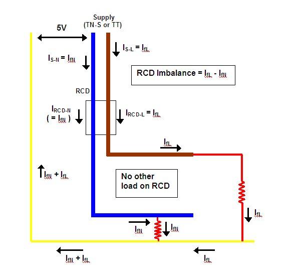

John, are you sure about that?
Suppose PD N-E is 5V, and PD L-N is 250V, and these voltages are in phase. Therefore the fault currents introduced by say a 1k N-E resistance (5mA), and a 50k L-E resistance (5mA) will still imbalance the RCD to same effect as a single 10mA L-E current.
I don't think so. I think they will balance. keep in mind that the N-E 5Volts (and the subsequent 5mA that you mention) is not from the phase.
It is from the Neutral via the sub-transformer so it passes through the Neutral side of the toroid (to earth) just as the phase current (5mA that you mention) passes through the phase side of the toroid (to earth) Both sides of the toroid see the same current.

But for an RCD in balance, the current through the phase coil is equal and opposite to the current in the N coil. If one coil was connected up the 'wrong' way, the RCD would trip (vigourously!) - it would be as if the 2 coils were connected as one.
In this 5V N-E example, we have our 5mA N-E current essentially flowing the 'wrong' way (180 deg out of 'correct' phase) through the N coil.
And I think that if we have our 5V N-E PD such that the L-N was 255V and L-E was 250V, the same applies.
I'm coming to believe that you are correct - as you've pointed out to sparkticus in a subsequent post, I've been forgetting about 'phase' (direction of current flow through RCD). Before reading your message, I drew the following, which appeared to indicate that the L-E and N-E fault currents were 'cancelling' in this situation...
However, as one can see, the N-E fault current is actually going through the N side of the RCD in the opposite direction from usual (since neutral is the 'line', not the return, for this current. So, if the voltages on L & N are in phase, the fault currents will, indeed, add in the RCD. In fact, I think that everything about my diagram is correct, but, given the direction of flow through the N side of the RCD, the value of my IfN is negative, making the imbalance IfL + IfN, in trems of the unsigned values of the currents.
Is that right?
