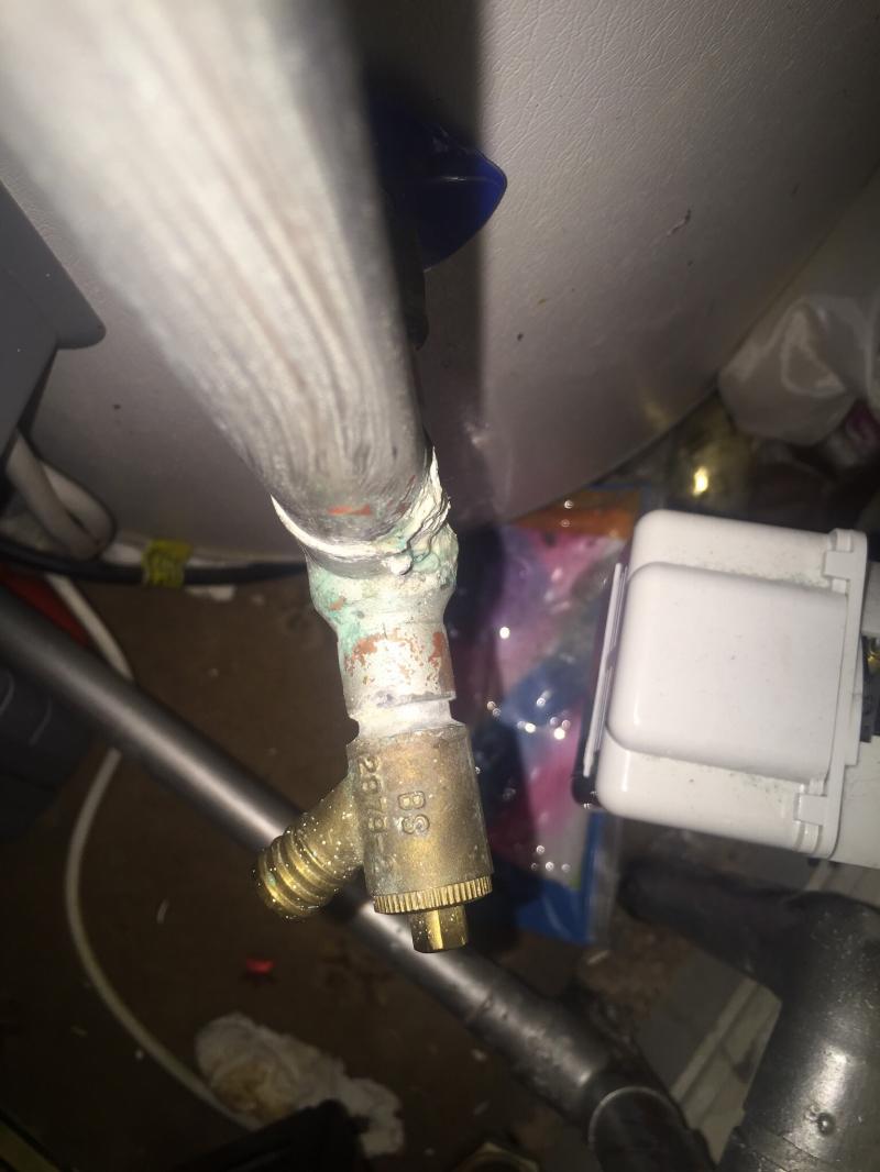

I think i obviously need to sort this tiny droplet leak but i don't know how to balance the return temp from the HW. All i see is a black screw handle and i afaik this was a tank drain off which i obviously don't want to mess with.
There should be two more pipes entering the side of the cylinder, just to the left of the grey box in the pic. These are the connections to the coil. The left pipe is the return and, hopefully, has a gate valve which can be used to reduce the flow rate.
Unfortunately there is no gate on the return just an aav on flow and manual air vent on return
