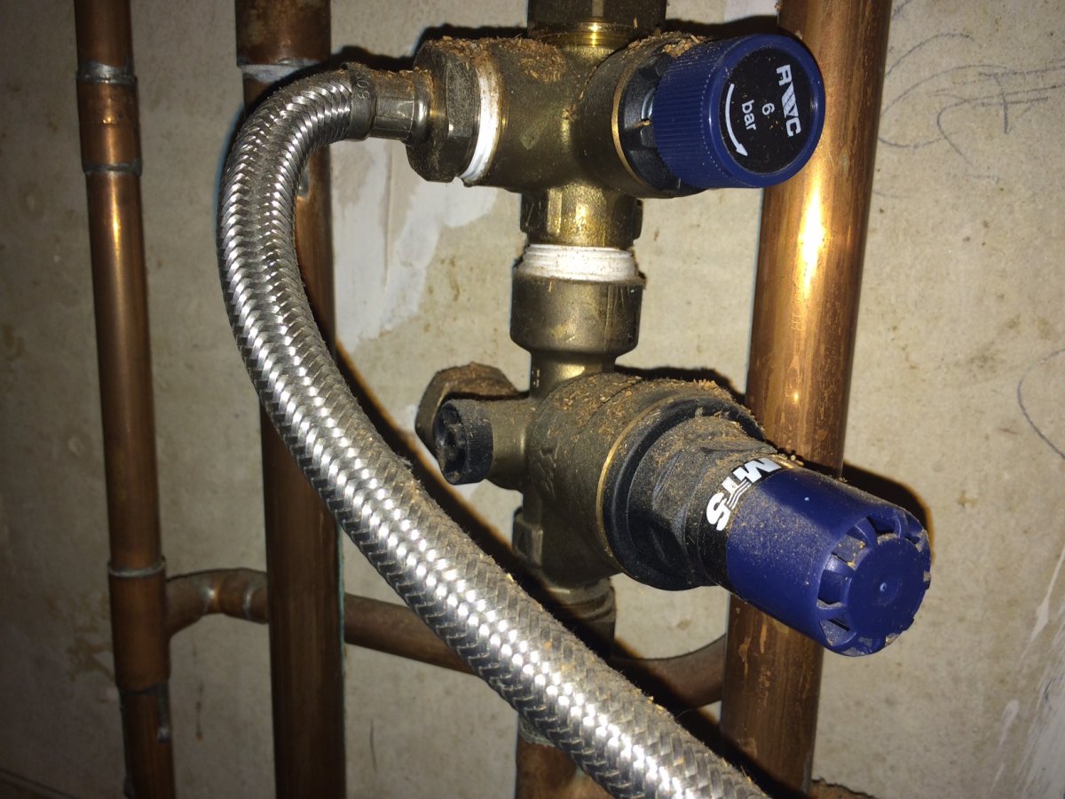

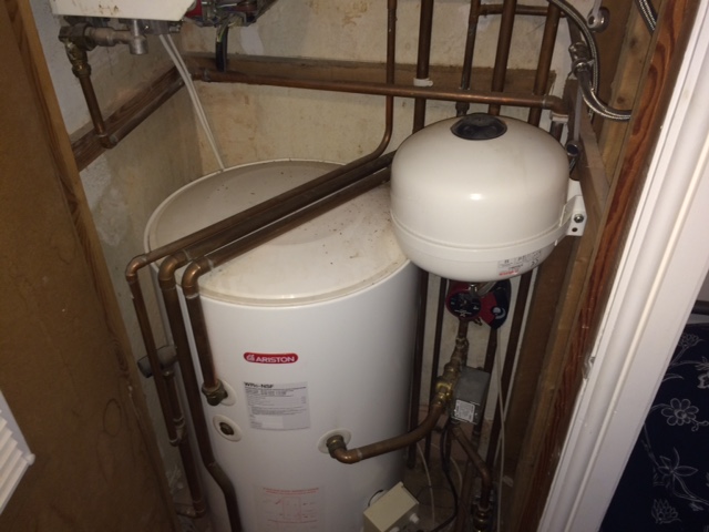

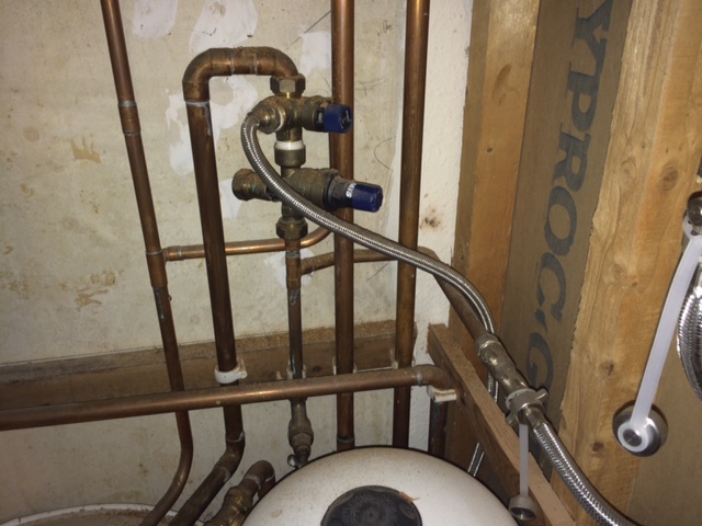

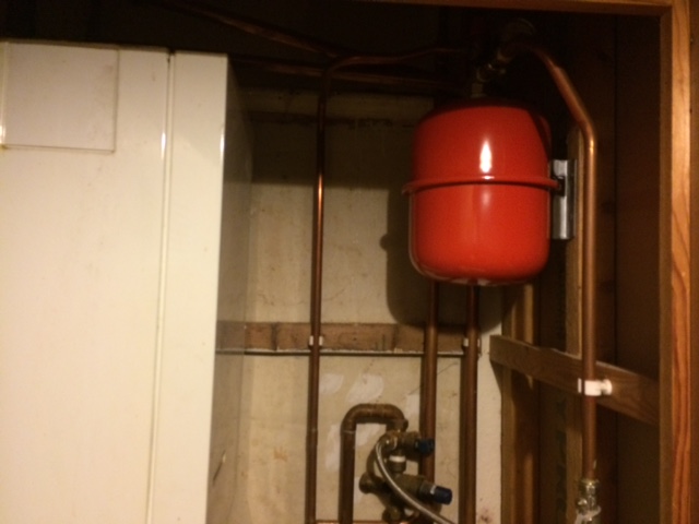

Hi,
I'm wondering if anyone can help, I used to have to re-pressurise our boiler every few months which was fine, last year when we had the pump replaced the plumber changed a couple of other bits around as well and I forgot to ask about the pressurising procedure.
Attached are some photos of the parts now, would anyone know how I would do it? I've tried the black tap at the top and the blue one lower down, I believe it used to be the black tap at the top near the pressure gauge that worked. Its currently sitting not much above 0 bar when the boiler is off or on
Thanks for your help

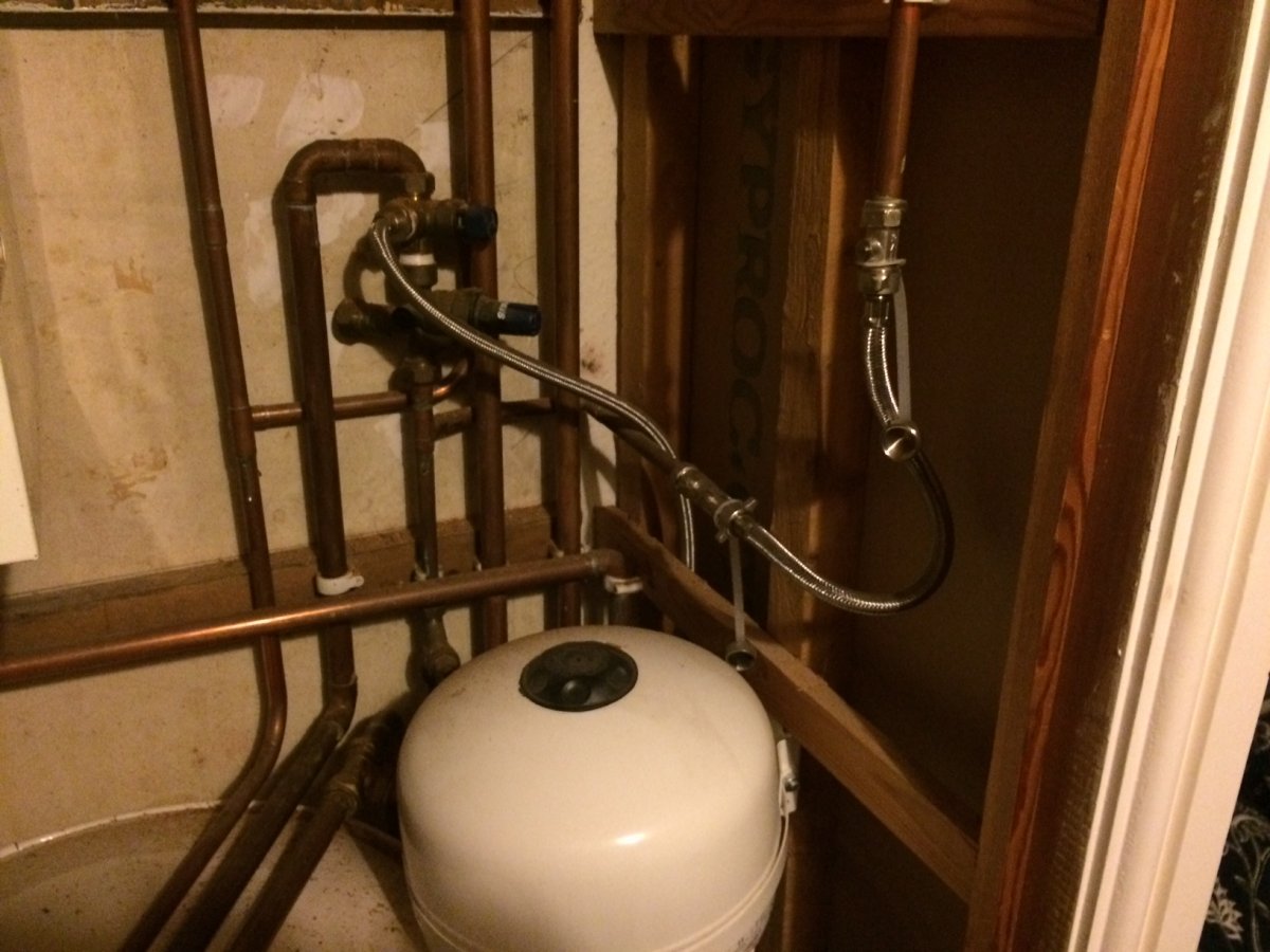

The third photo is just cutting off the other end of the filling loop,(image 4) one end is already open, can you post another photo ?

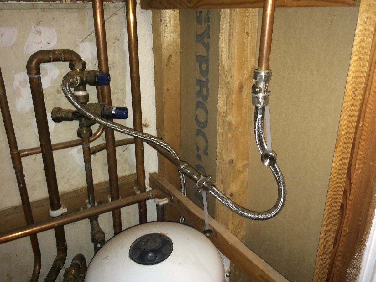

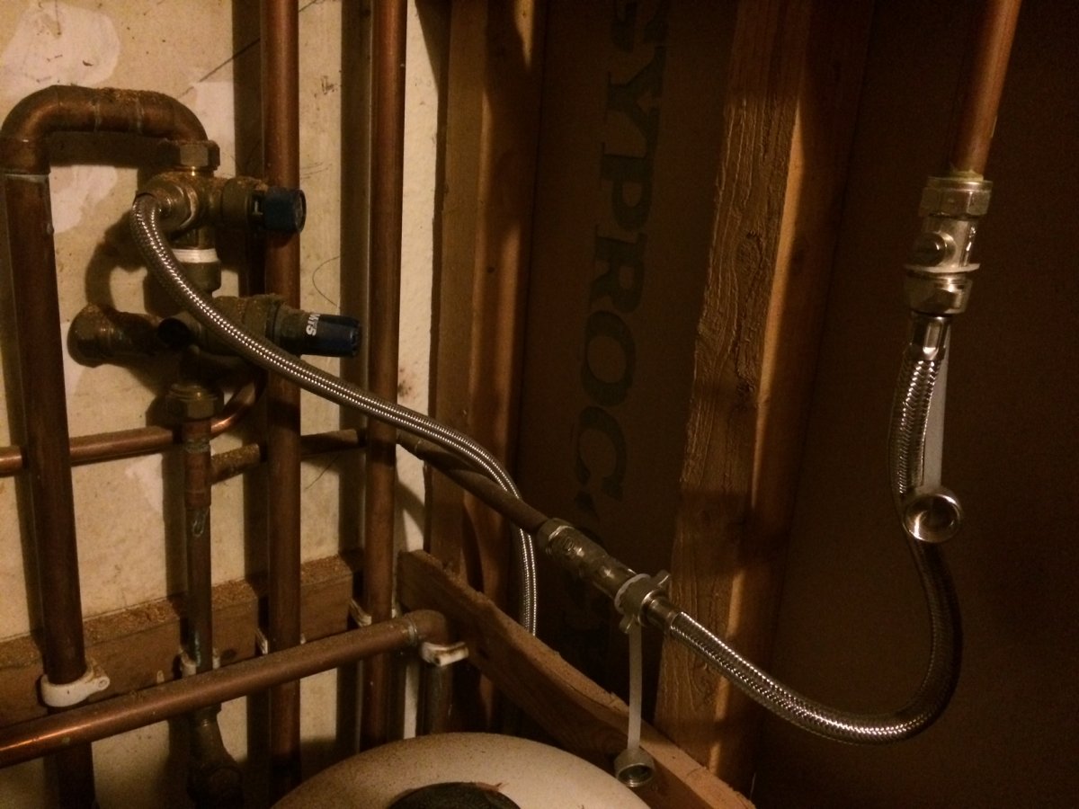

Thanks for the reply, attached are a few more photos
I assume it does need re-pressurising if its that low? I bled a couple of the radiators earlier and after putting the heating back on all the radiators in the house are hot still. The shower might not be as hot as it used to be but I'm not even sure if that could be caused by the pressue

on image 0430 you can see a valve with a slot for a screwdriver,you need to open this, this is one half of your filling loop, the other valve is up near the red expansion vessel which is already open and should be closed when you have topped the pressure up.
