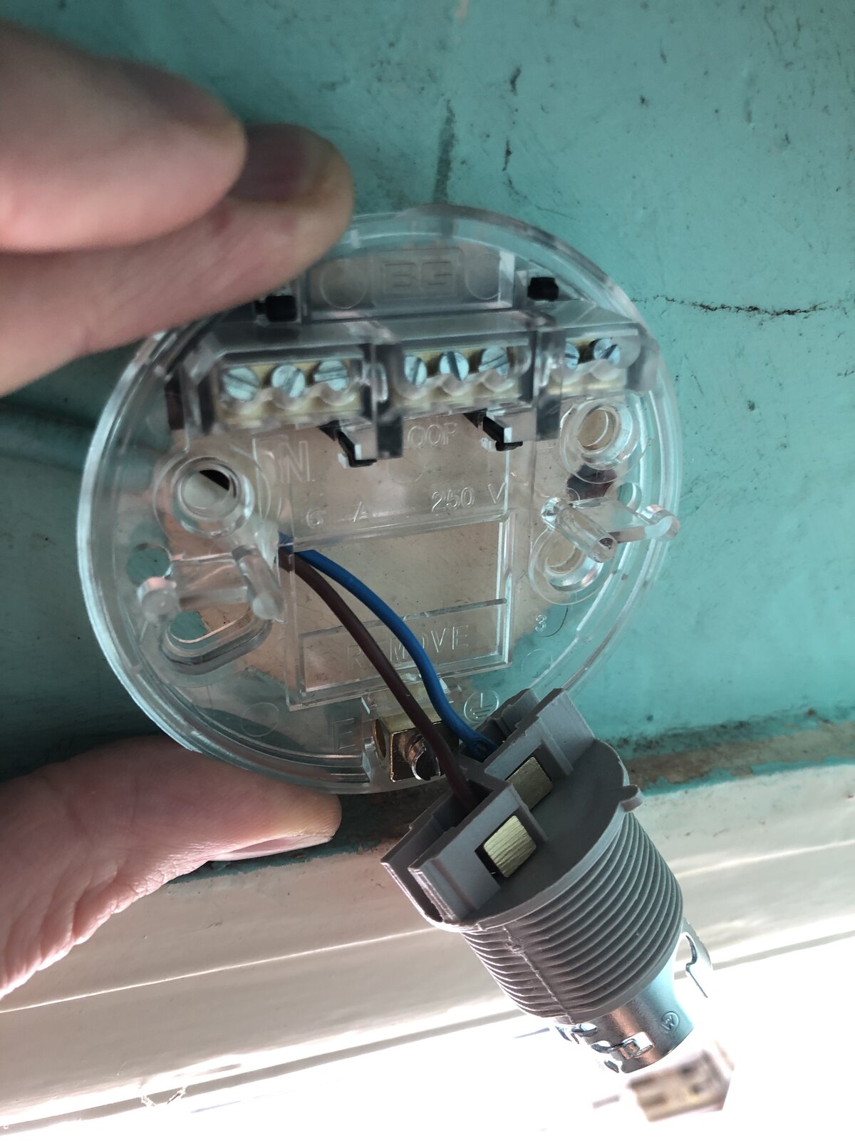

Hi
I am replacing an angled lamp holder which has a blue and brown wire which I know are neut and live. But the new fitting doesn’t specify which terminal is which so I want to make sure I have it the right way round. Does it matter? I have attached some photos of the new fitting plate and the terminals.
I have tried both options and they both work but I want to make sure it’s safe.
Any advice is welcome as I am a novice.

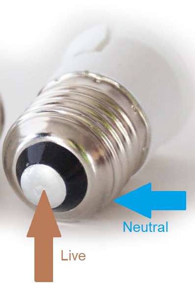

It doesn't matter - but if the fitting is for a screw-in bulb then it is best to fit the live to the centre contact.
Thanks. Is the centre contact on the backplate?

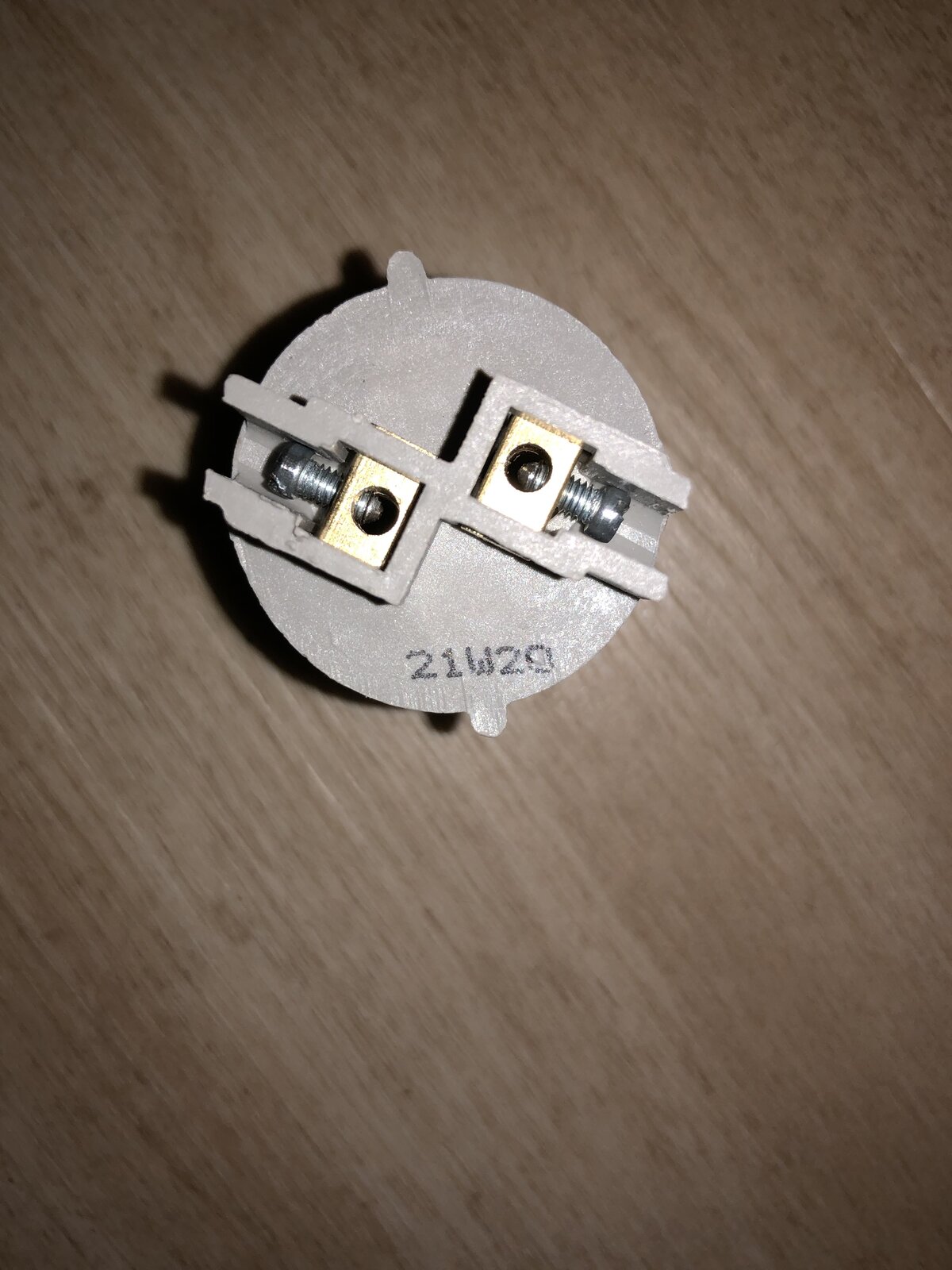

Im also assuming as my light is 1-way I don’t need to use any terminals on the backplate, just the x2 points on the back of the bulb connector?

No, in the bulb holder.
You need to connect the cable in the picture to the rose (backplate) by going through the hole in it and then a piece of flex from there to the light.

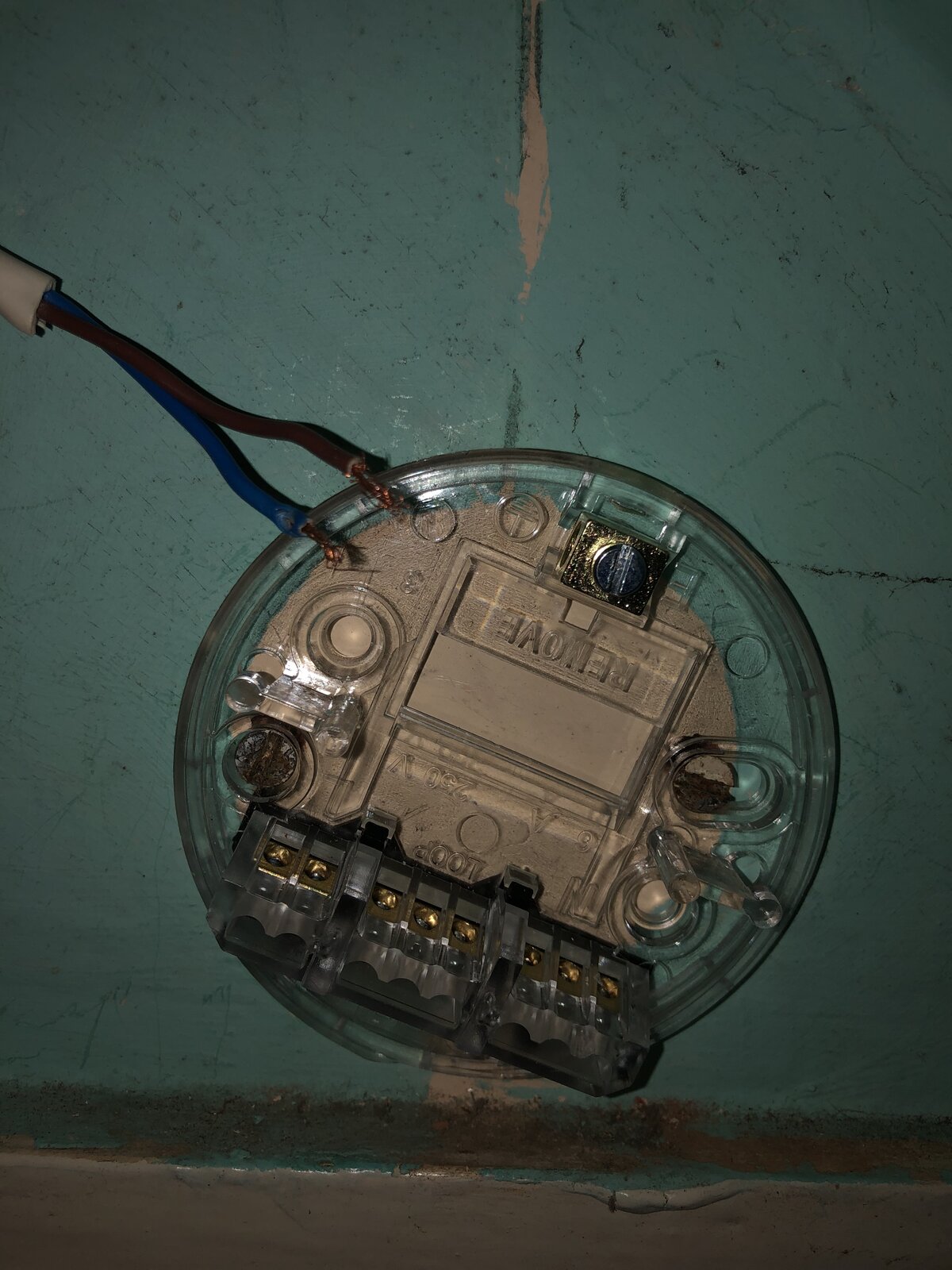

Like this? New photo added. The previous fitting didn’t have a backplate so the two wires just went straight into the bulb holder.
Or do the wires actually need to go in to the L (brown wire) and N (blue) terminal on the rose?
What do you mean by flex? The fitting came with two little white wires do they fit into the same terminals and then attach the bulb holder?
Well yes, but then the rose won't fit flush to the surface.

Probably not, it depends on the fitting. Picture of it?
Like this:

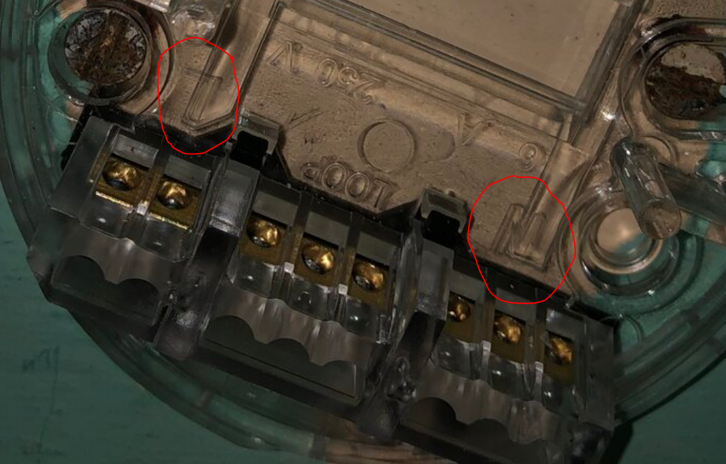

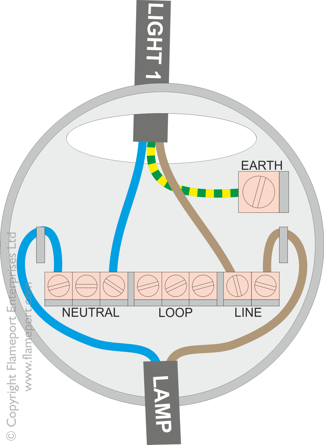

Your supply cables would usually go in the base,
switched live in the outer 2 terminals, Neutral in the outer 3 terminals.
The Two supplied White links just go from the base to the holder, either way round as it is a Bc holder.
1 in with the switched live, the other in with the N.
Its ok to bypass the lot and put your flex straight to the holder like you have though.
Not really an issue but there should also be an Earth there even if unused.

Ok, thanks all for your help. I have effectively done the attached (albeit no Earth wire) and works fine.
