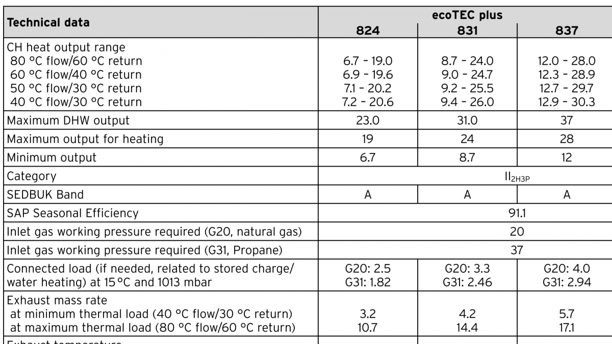

Do you mean this one?Anyway back to the topic in hand @TCCHeating I noticed you completely avoided my question about the less than manual specified flow rate. You don't actually know do you? And you call me a muppet!![]()
