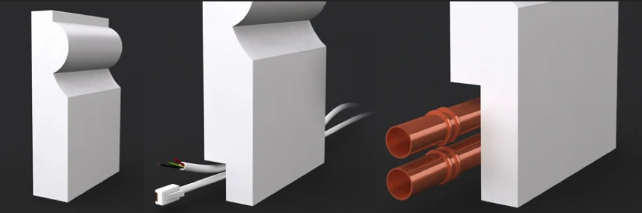

I'm a bit mystified about what you intend to do, here. Firstly, by rebated skirting I take it that you mean the profiled stuff where the rebate is at the back and is meant to hide pipes or wiring:

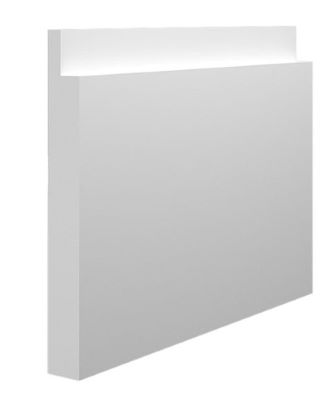

Although there is a square-edged board you sometimes see where the rebate is installed top, front as a decorative feature:
This is normally installed with the rebate at the top, not the bottom and is installed with a rebated architrave. So what do you intend to do with a rebted skirting?
You are also talking about having a wooden floor - what is the sub-floor (i.e. the floor beneath the carpet) made of? (e.g. concrete, parquet, planks, chipboard, plywood, etc) and what sort of finish flooring are you considering installing? (e.g. laminate, engineered wood, parquet, solid wood etc). If we know that a better, more specific answer is possible. Also a picture if the existing skirting would be a great help
Does anyone know of a rebated skirting with a thicker base or a way of perhaps cutting a piece out the base of the old skirting or any other suggestions?
You don't normally rebate the bottom of a skirting - you normally either remove, install the new flooring then reinstate/replace OR you undercut the existing skirtings and install flooring (needs a flooring saw - look up Crane Flooring Saws - can also be done with a multitool but is hellishly slow, very noisy and difficult to get a straight enough edge) OR you hide the floor edge with a beading
