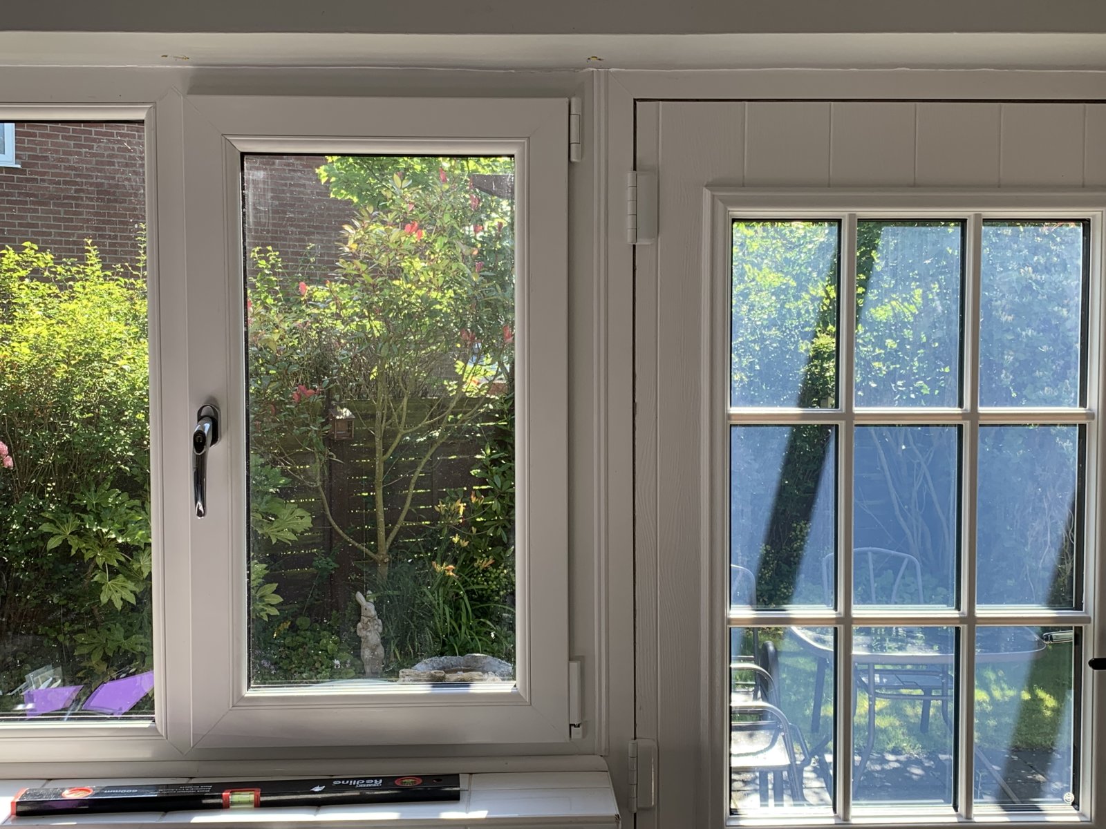

Good morning everyone I’m new to this forum due to being in a bit of a pickle.
The situation.

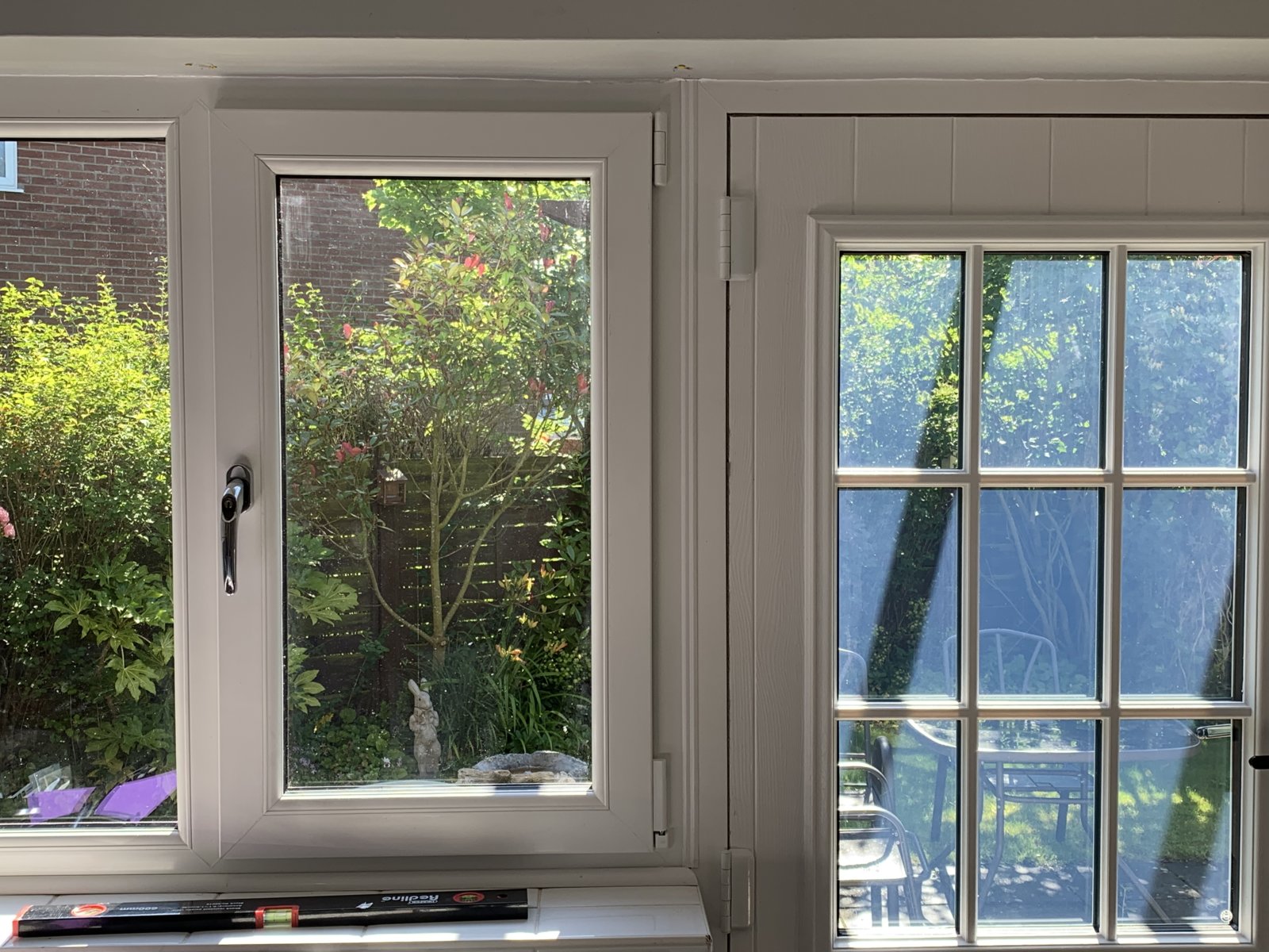

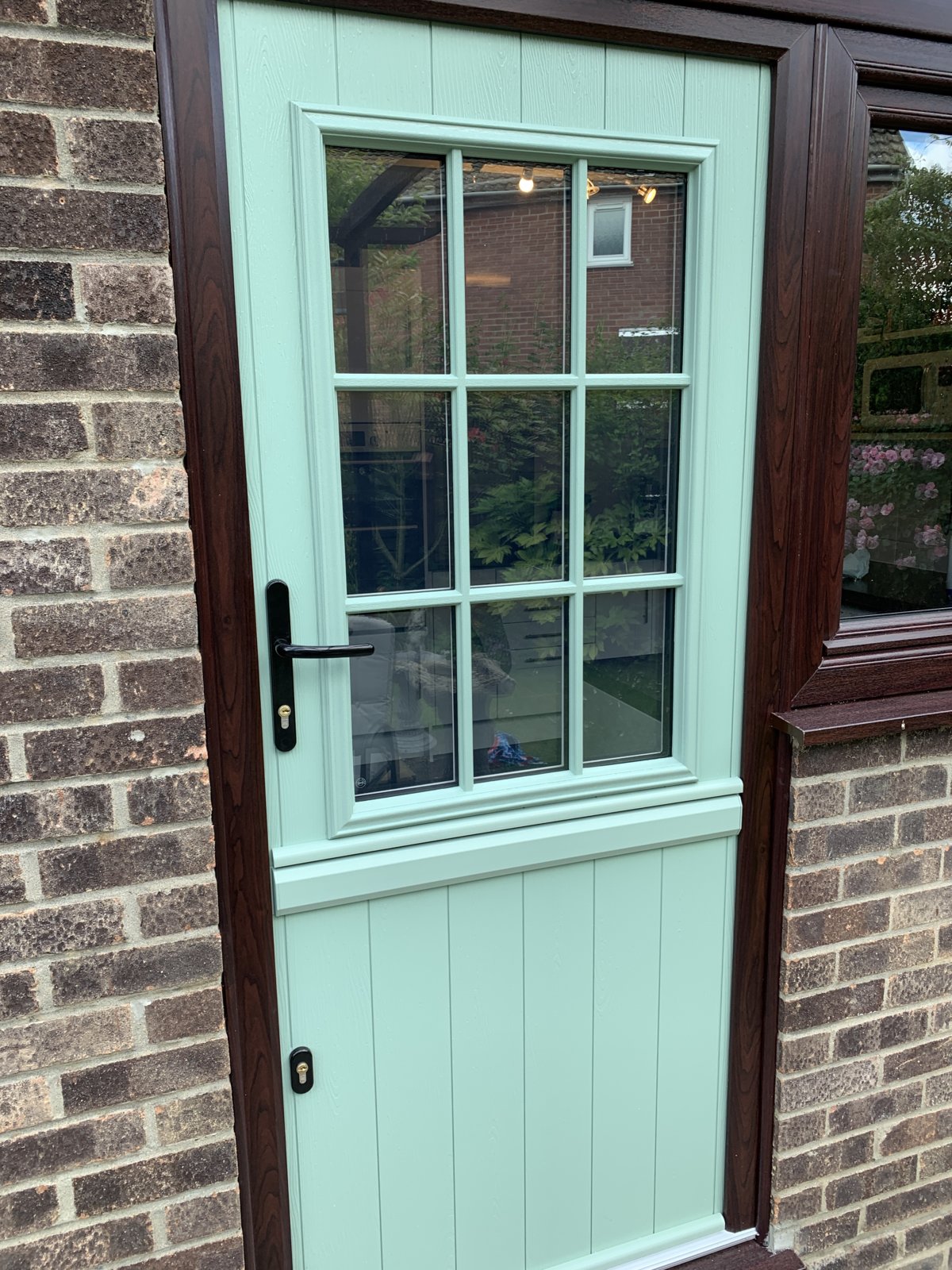

Went on holiday, while away had 9 windows and composite door replaced while I was away by a recommended installer. I’ve come back to what seems like a massacre.
The reason I’m posting is because I’m not sure if I’m being to fussy or not.
I was wondering if anyone with knowledge could help me figuring out what’s acceptable and what isn’t. I’ve found so many problems I’ll do the step by step.

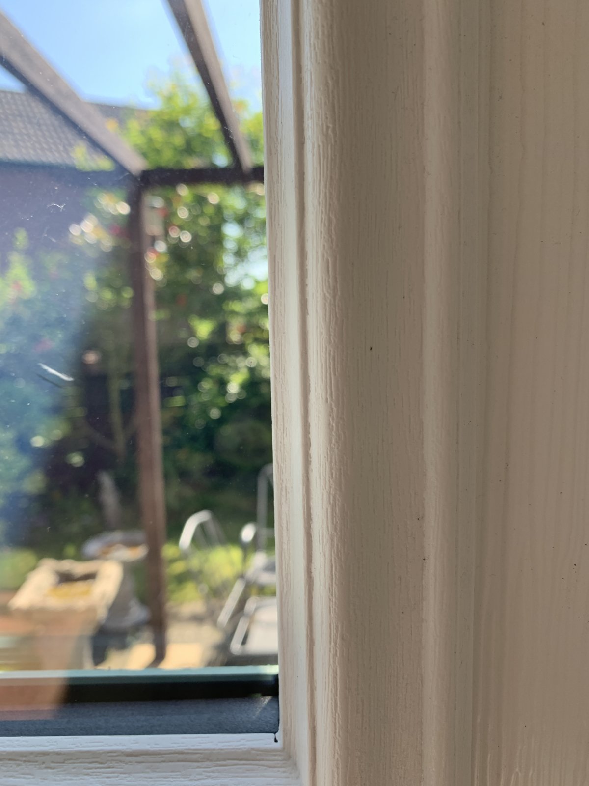

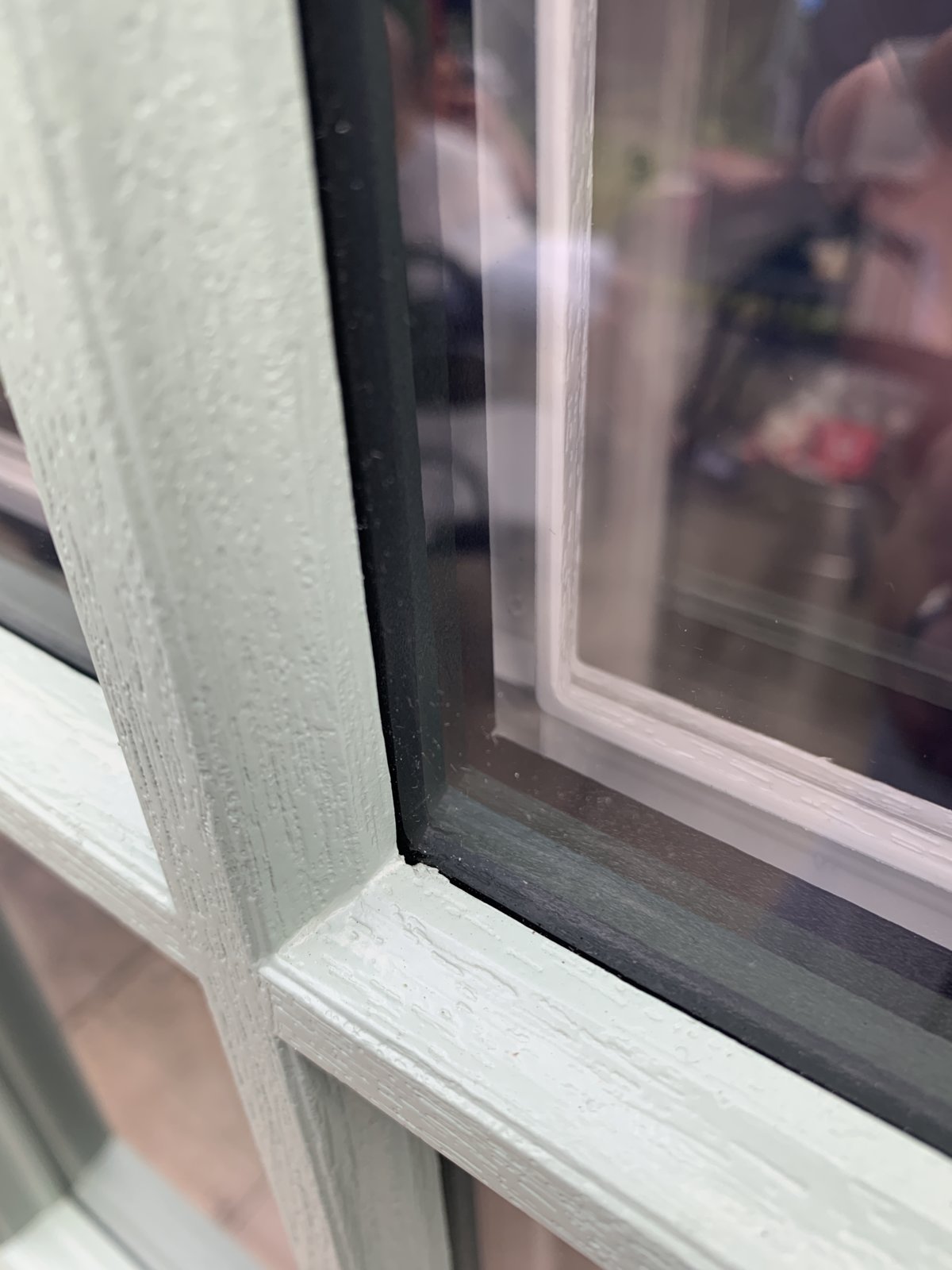

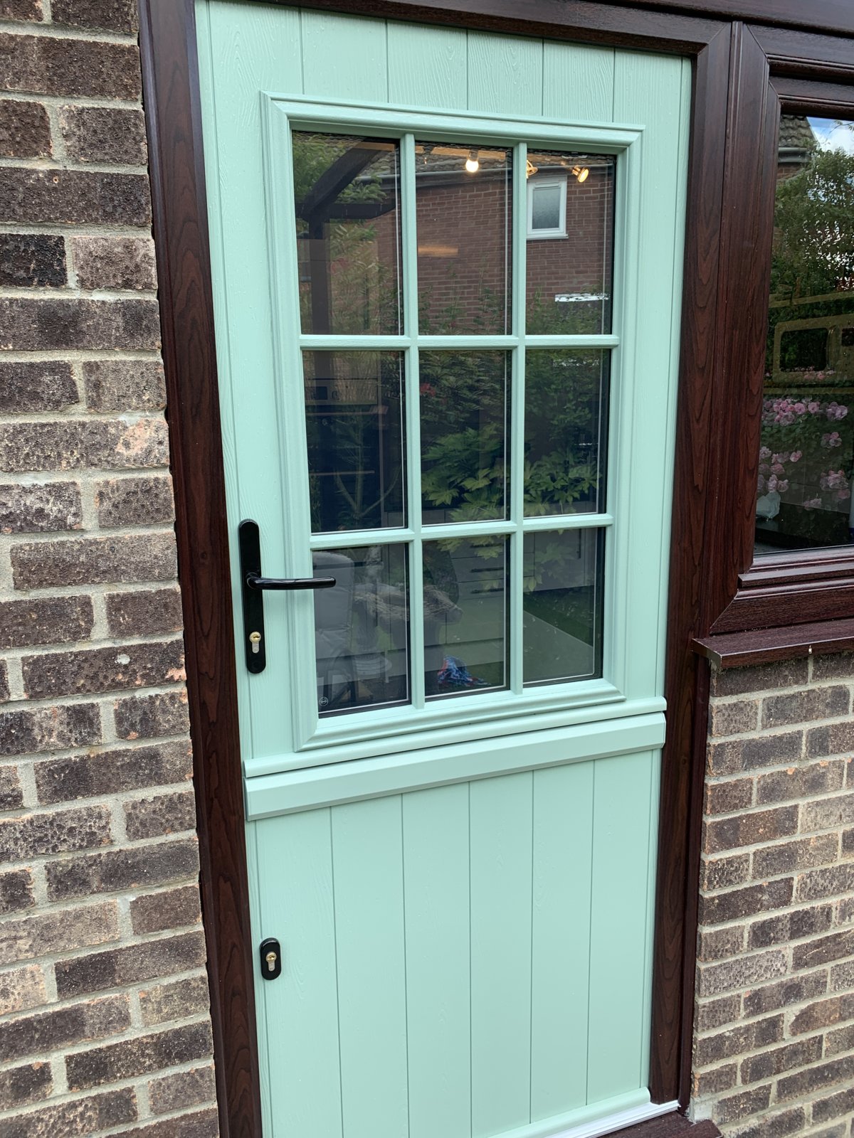

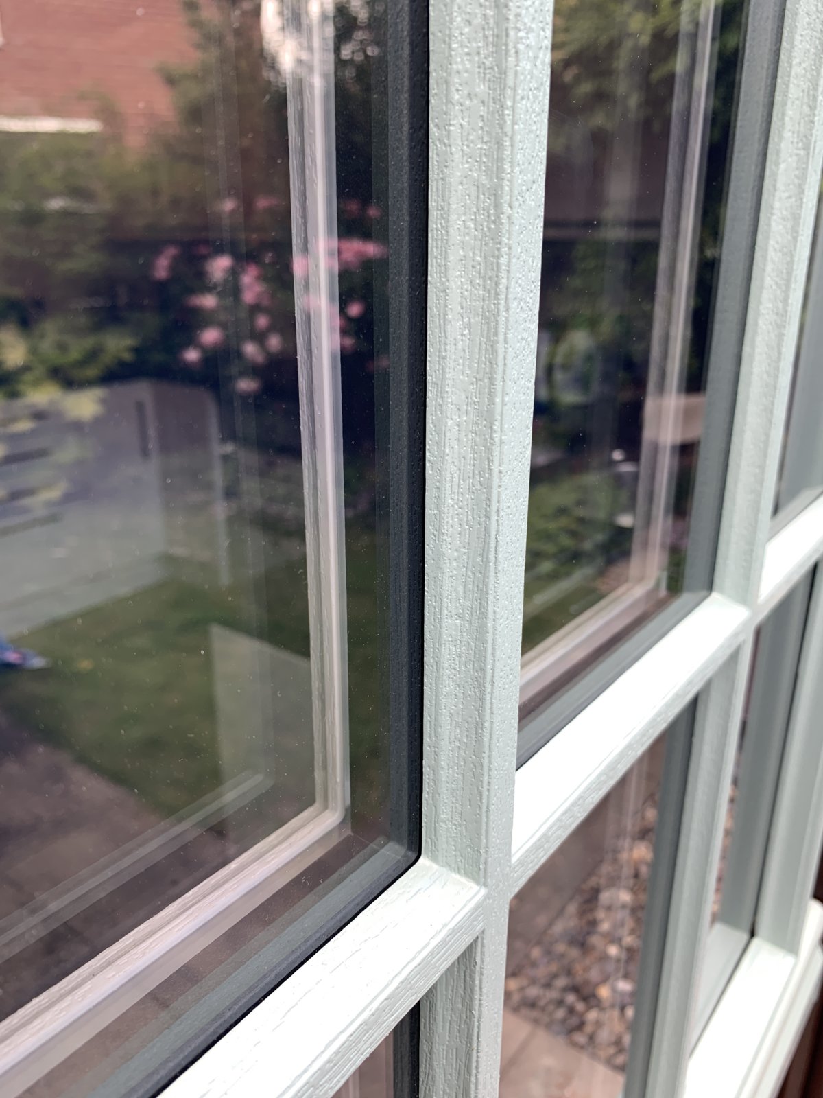

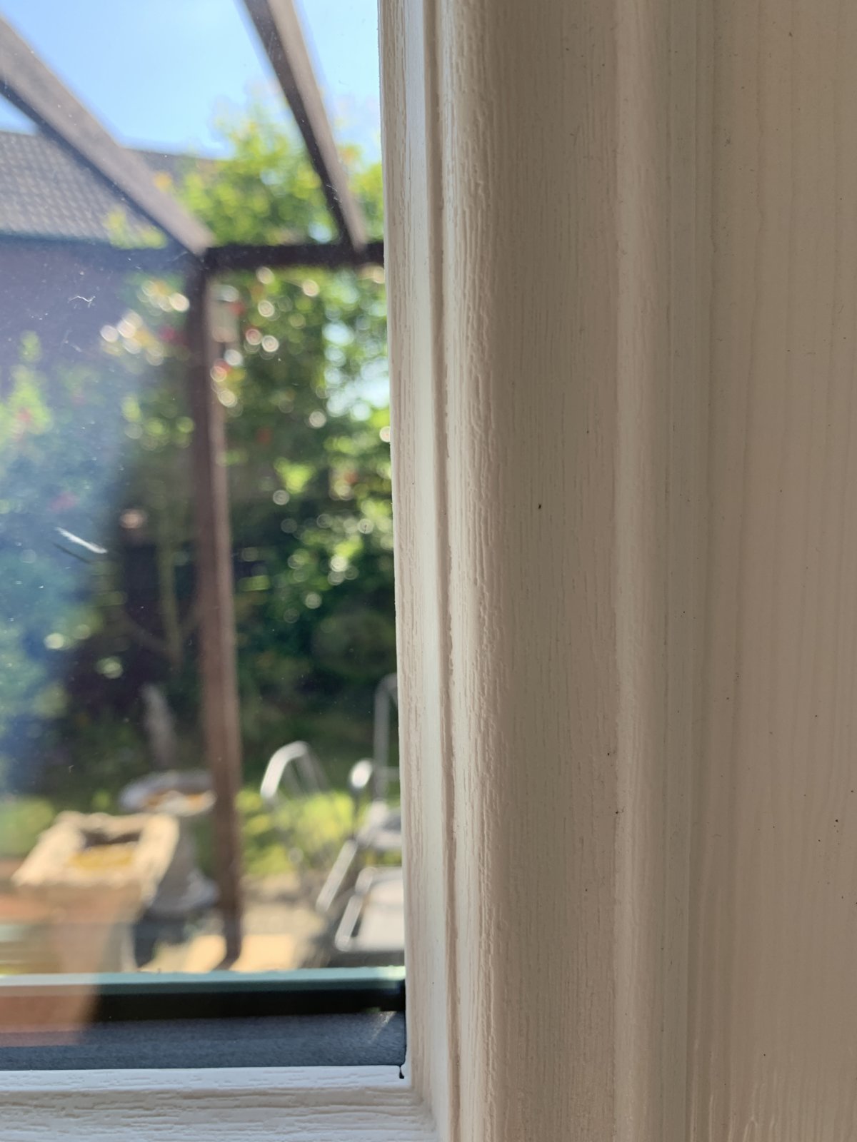

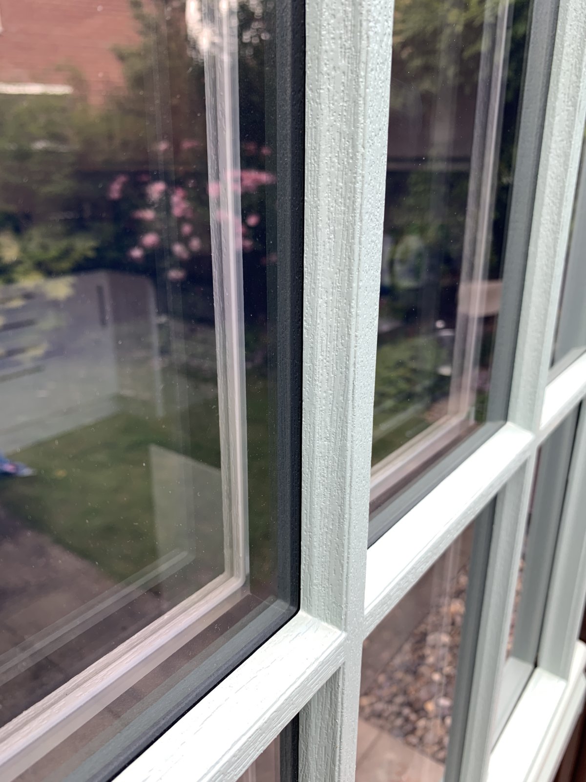

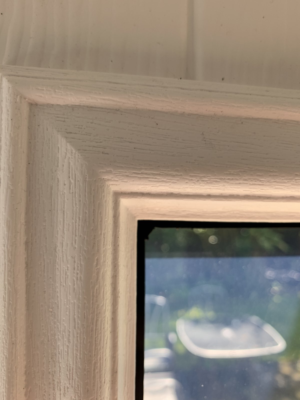

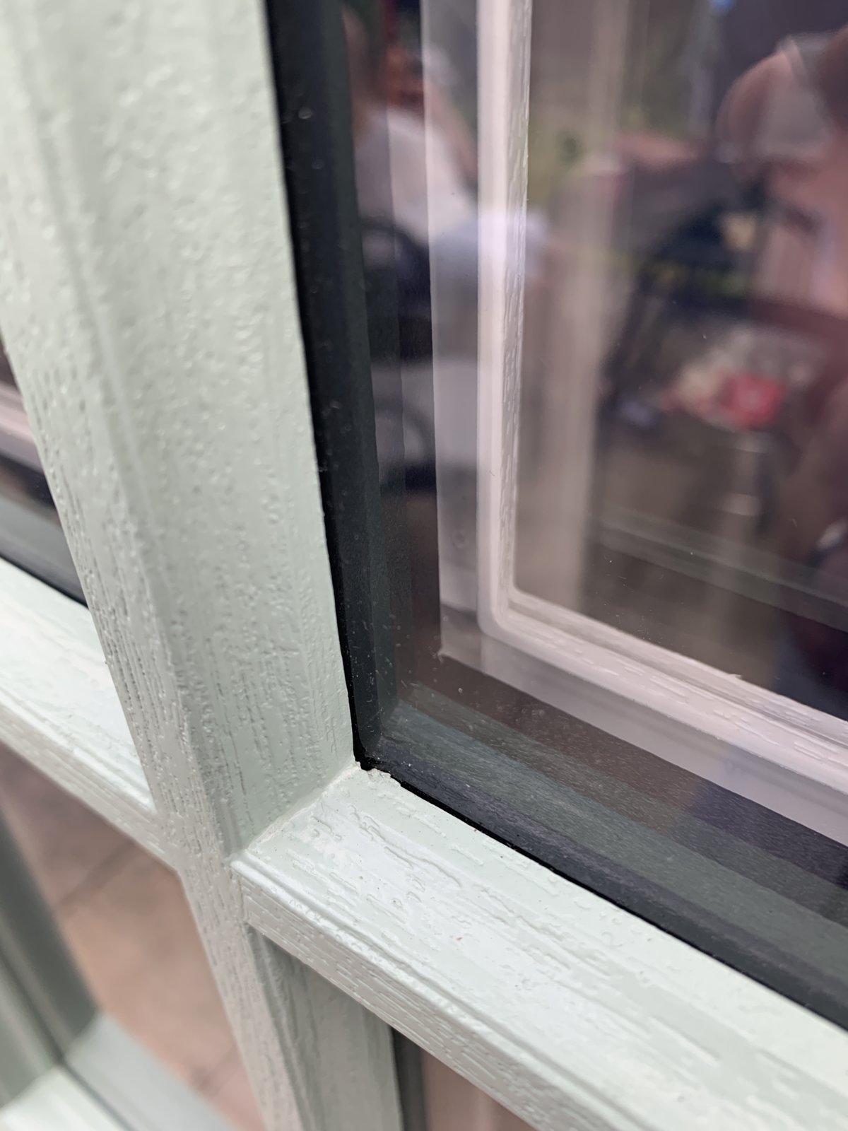

1st image I’m pretty sure the Glass in the door needs replacing it’s misty and the casing can been seen the border doesn’t seem to cover the glass properly, one side of the window you can see the black cassette by about 5mm the other side is recessed.
Hopefully some can shed some light on this and thank you in advance if you do.

Yes, the glass in the door is almost certainly Pilkington K, its a low E(emissivity) glass that regs demand, the blue misty effect is the metallic coating which reflects the heat back into the room, back in the day Pilkington K was the only choice but there are many more manufacturers of low E glass nowadays, my personal choice is Planitherm total +, made by Saint Gobain Glass. I guess this only affects the door because it was made and supplied by someone different to the windows, the door manufacturer uses Pilkington K while the window manufactuer if the glass is clearer(without the blue hue) uses Planitherm.
The second problem is the glass in the door doesn't central, you don't normally have so much slack to get it that far out one way, it could be the glass is too small in the width and simply wants repositioning, however that would mean stripping down the glazing casette(the beads and all the geo bars) so while at that point I'd ask to have the glass changed to planitherm total +.
Two problems solved, not biggies really, I agree though the glass looks s***, I stopped spec'ing it because of the colour
Thanks for your reply will get this looked into.

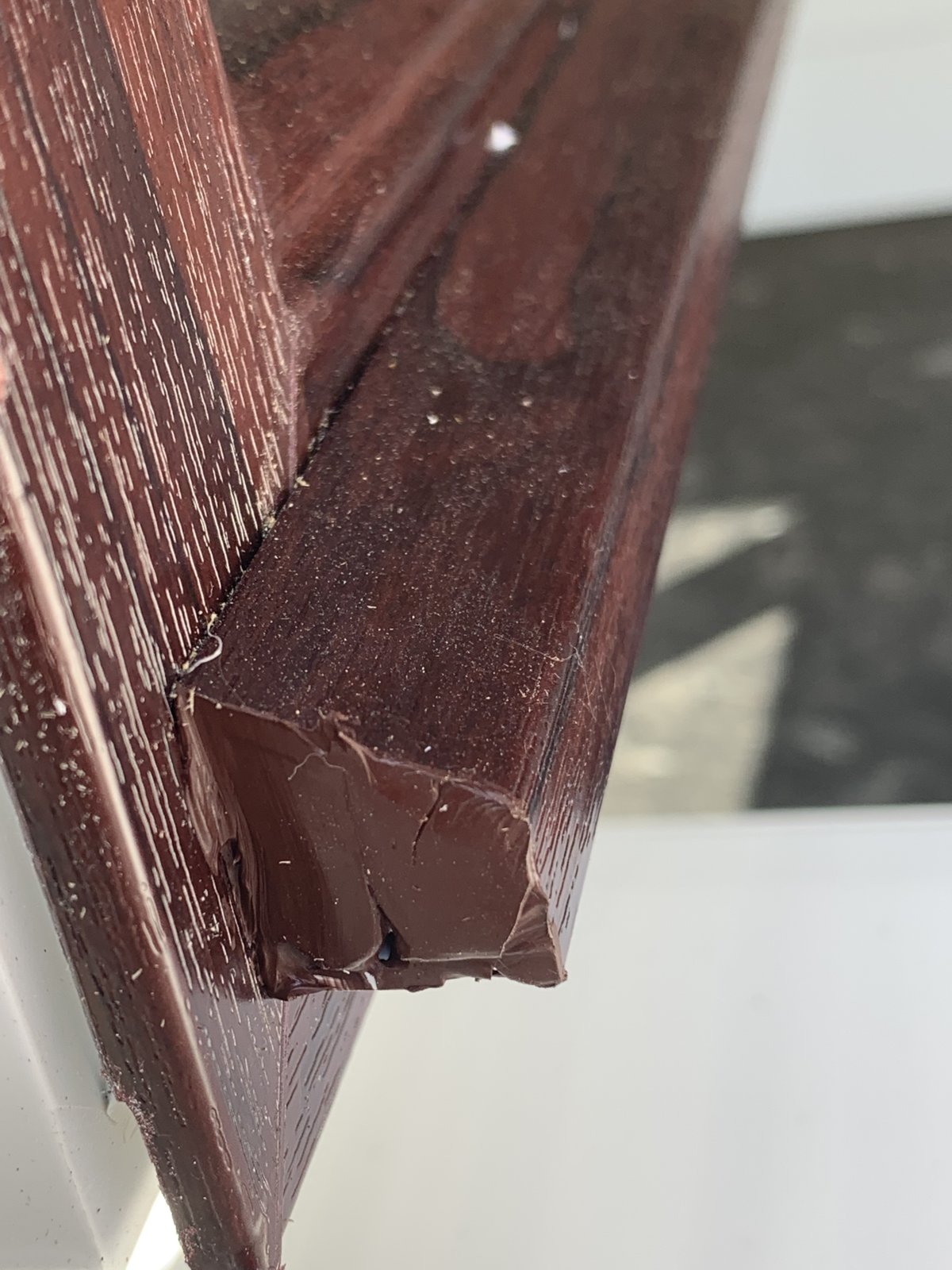

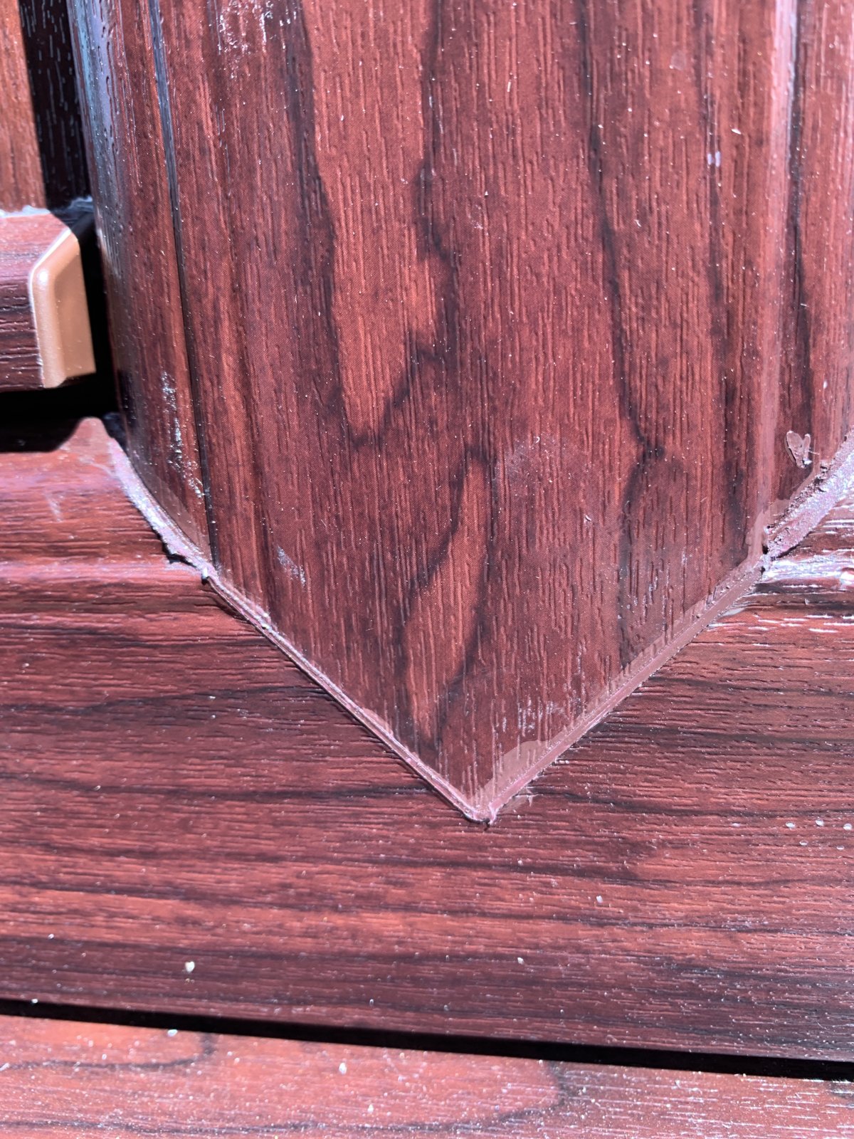

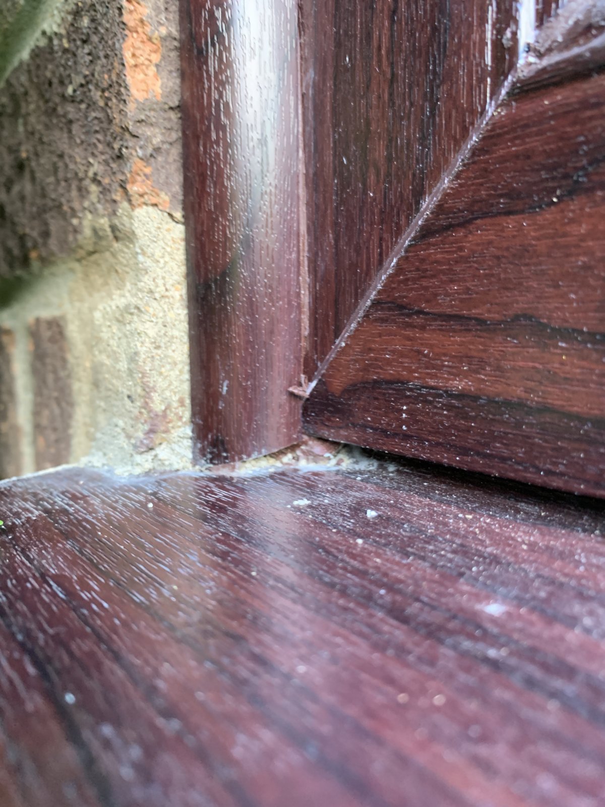

Onto the next problem.....chips

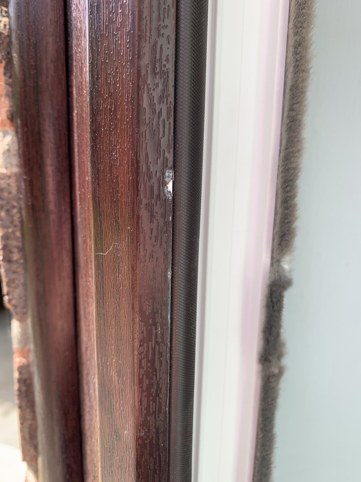

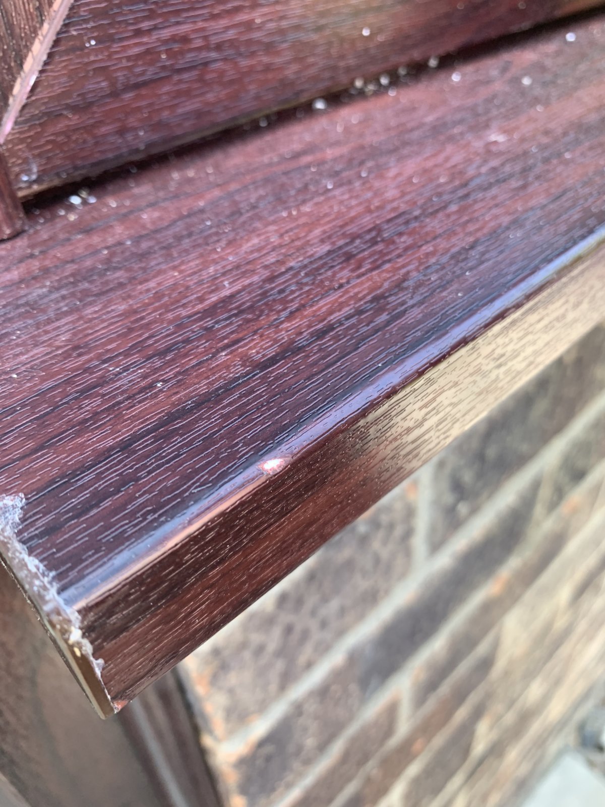

These chips are from the door frame and outside window. Every window has similar chips, installer has told me in a brief conversation this is normal manufacturing issue and you just touch it up with a pen and everything will be fine. My concerns are they will still be noticeable and would the spots need to be covered up again over time.

If they were touched up before you'd seen them then you'd probably never have seen them, now no matter what anyone says probably won't convince you. The touch up pens are specific and made for chips like these, there's even coloured waxes for larger chips, it's disappointing that they didn't touch them up before you came back but give them a chance, ones a cill and the other is the door frame, the cill could be replaced if needed without too much effort, frame not so
Chips like that on all 8 window frames and the door frame.

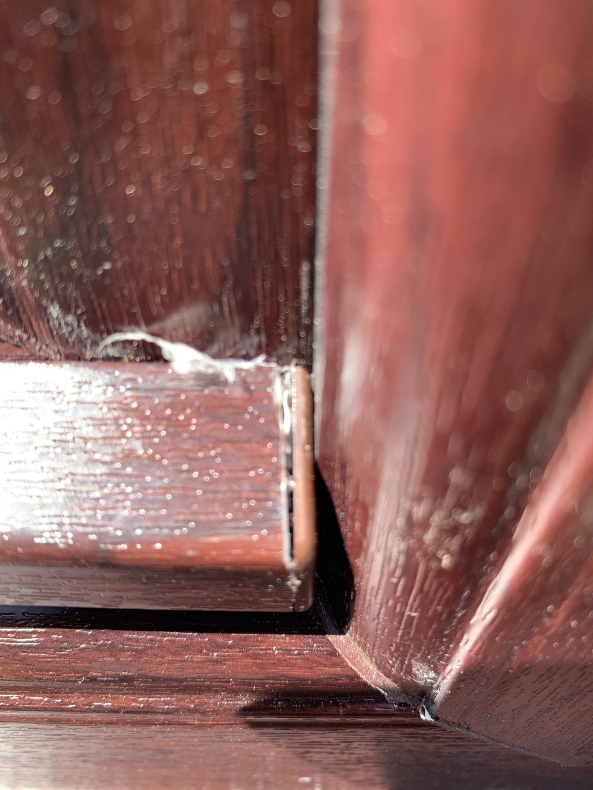

Onto the next problems.....

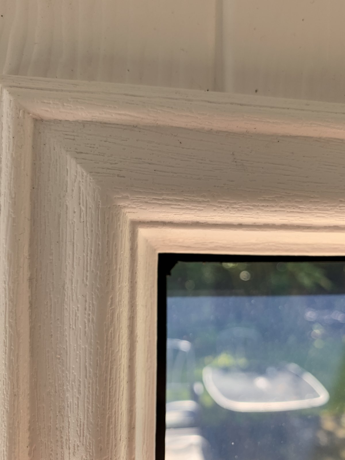

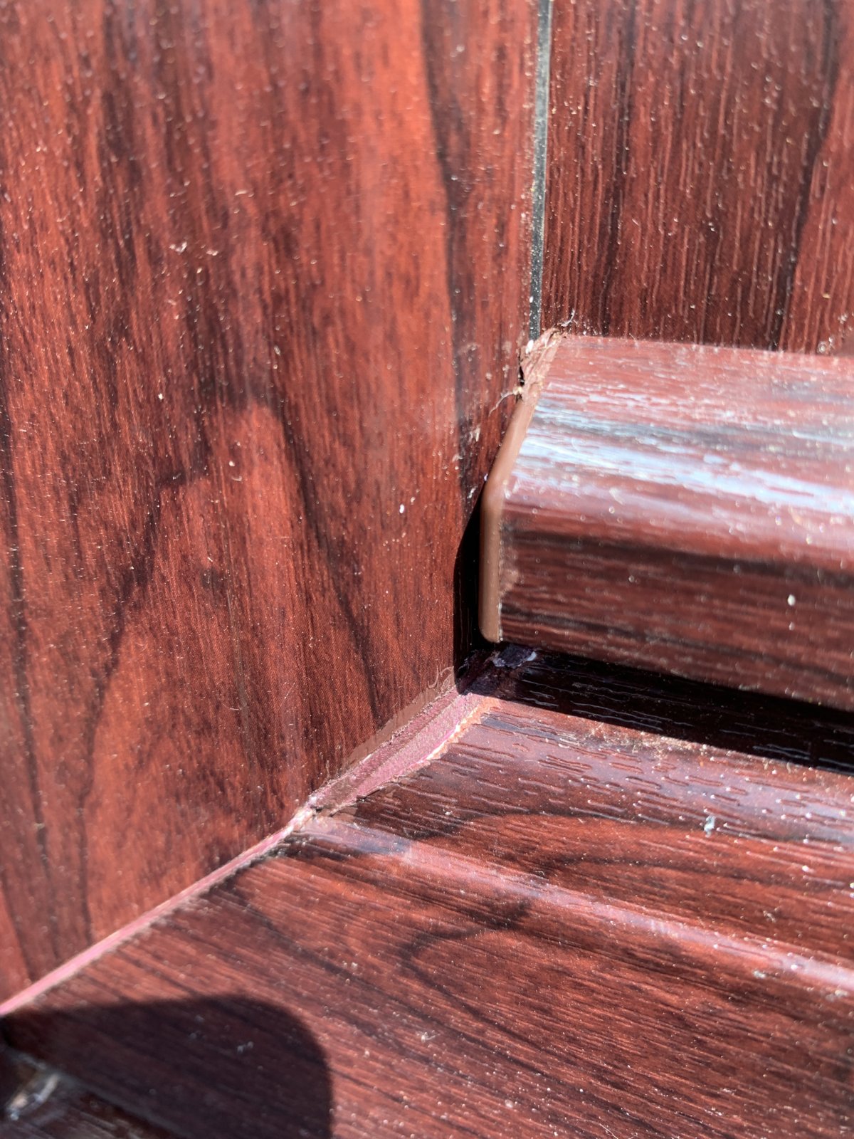

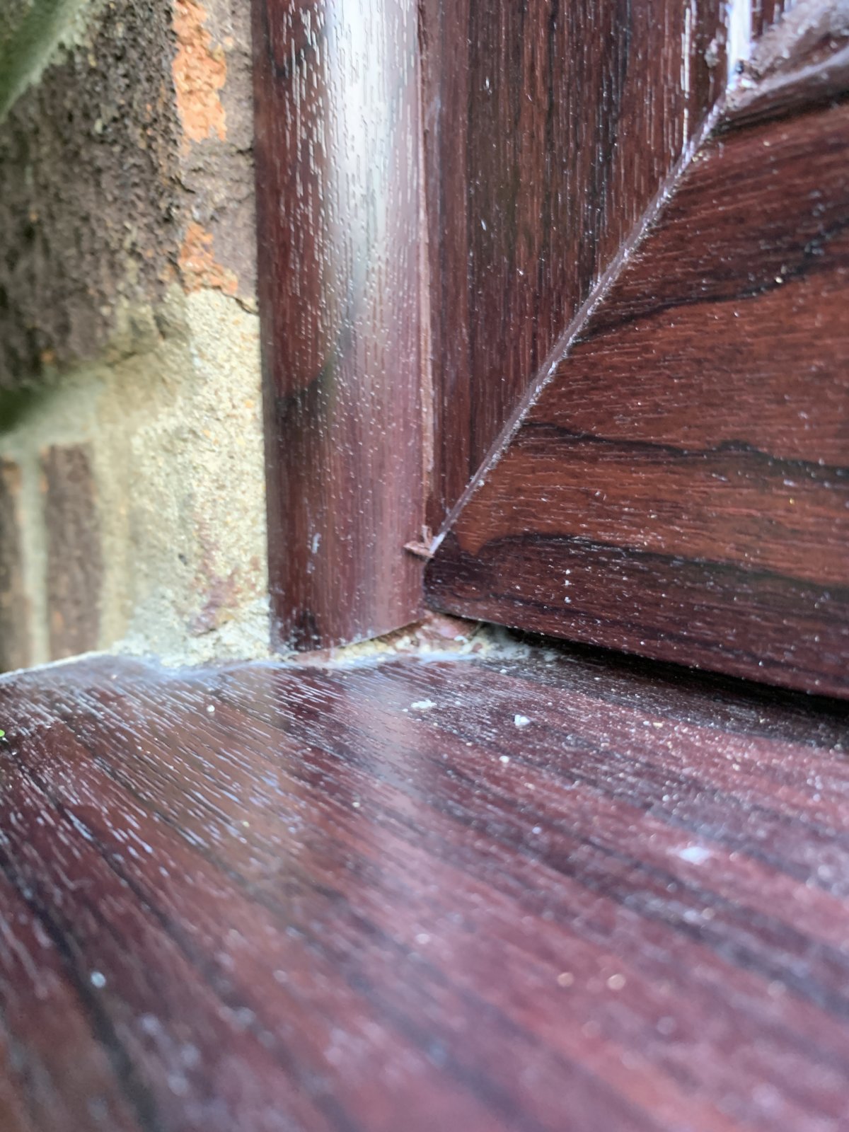

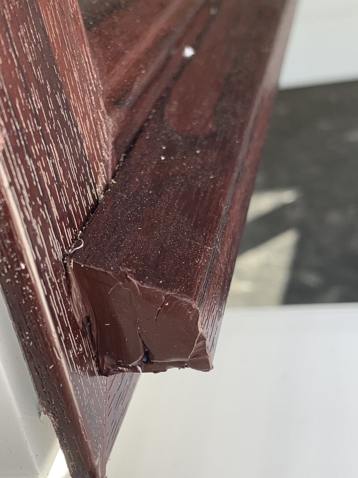

And couple of these have been cut with the ends not fitting squarely and 1 just filled with mastic. There seems to be no consistency with the fit of these trims, some are rubbing on the frame some are 10mm away from the frame

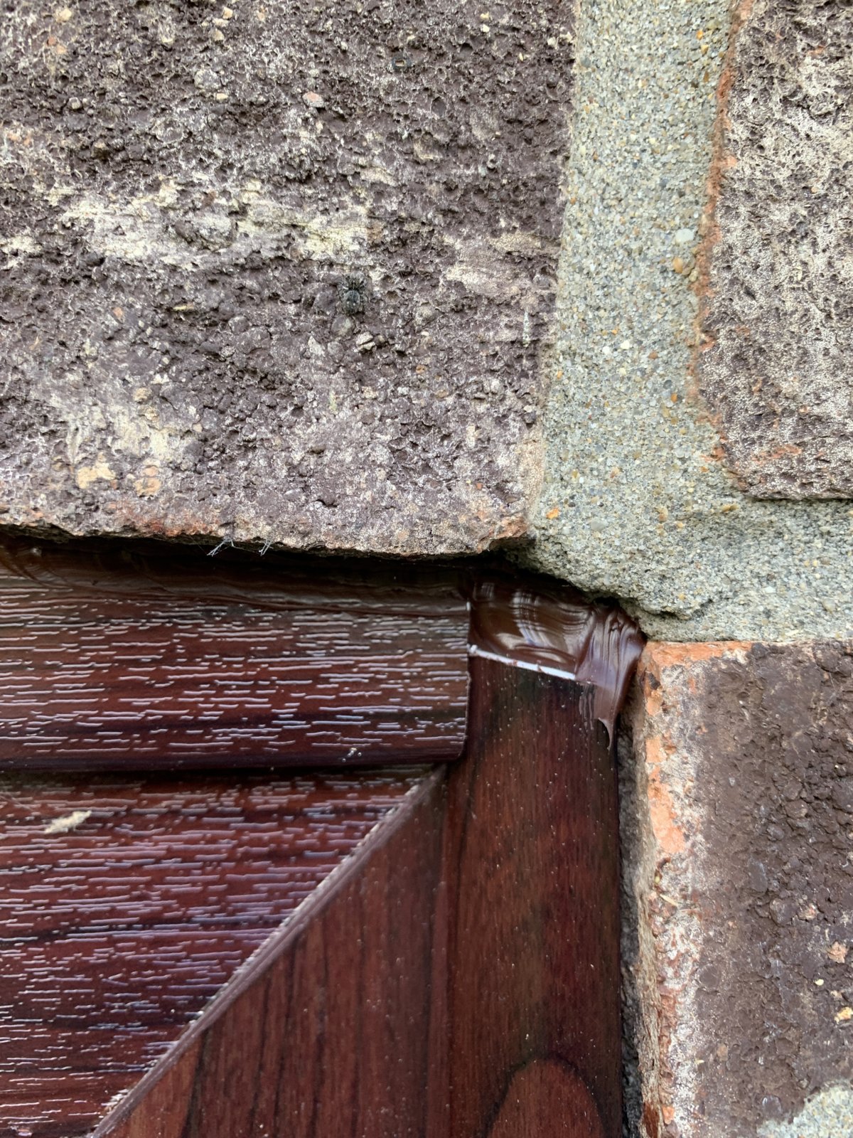

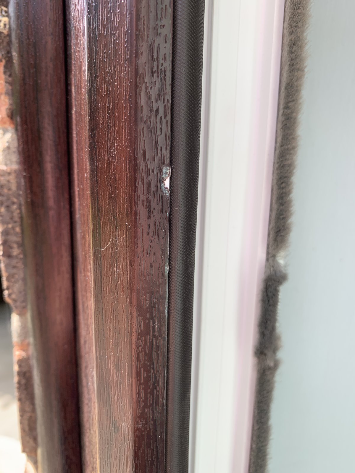

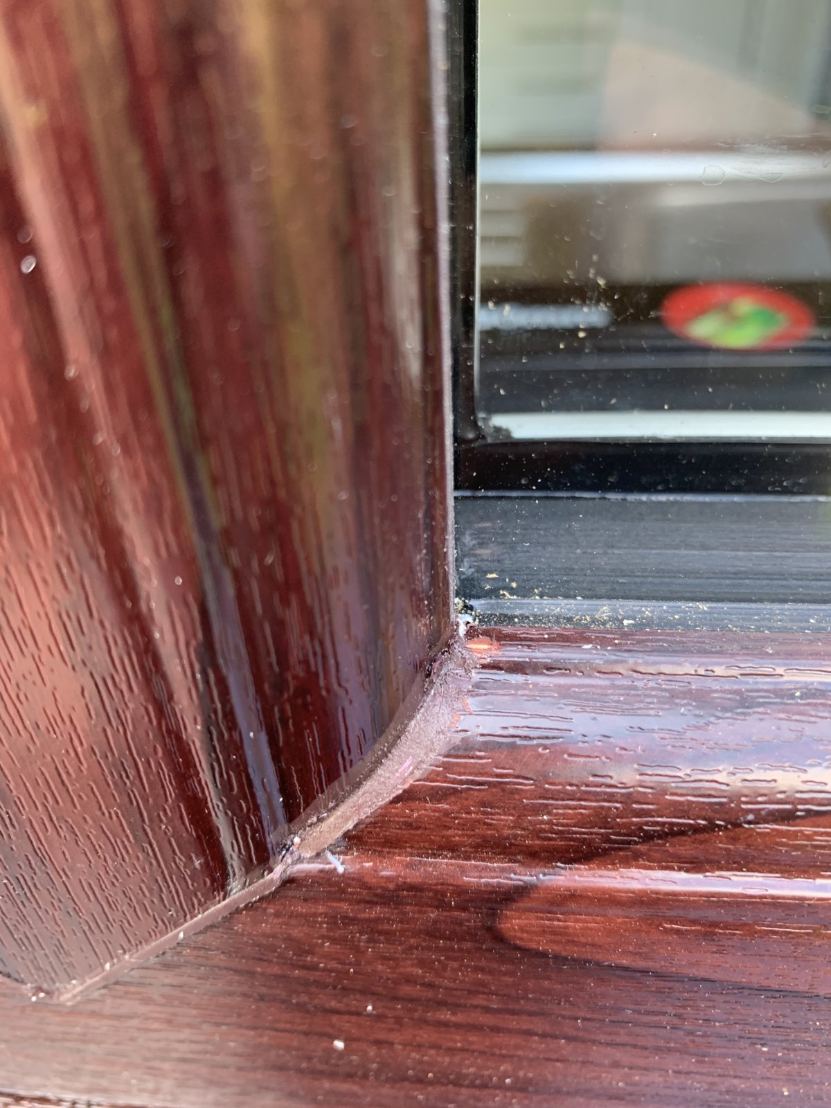

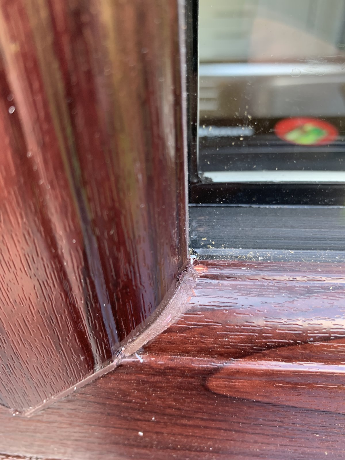

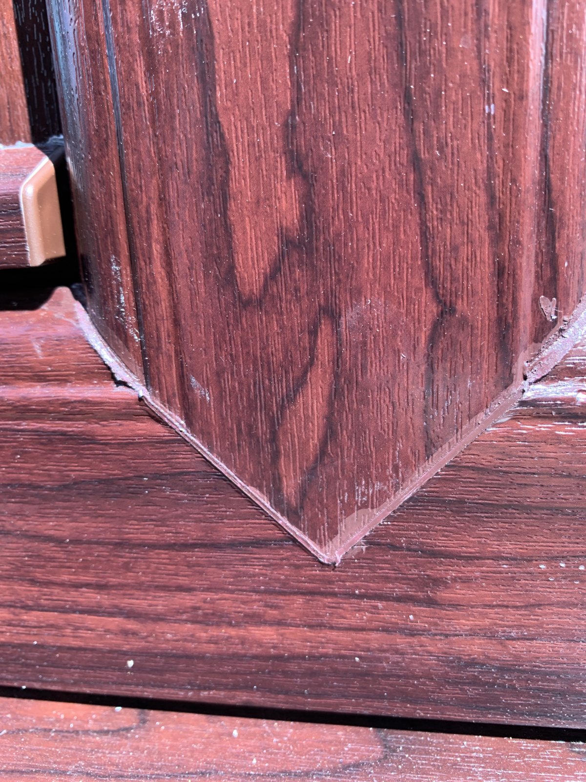

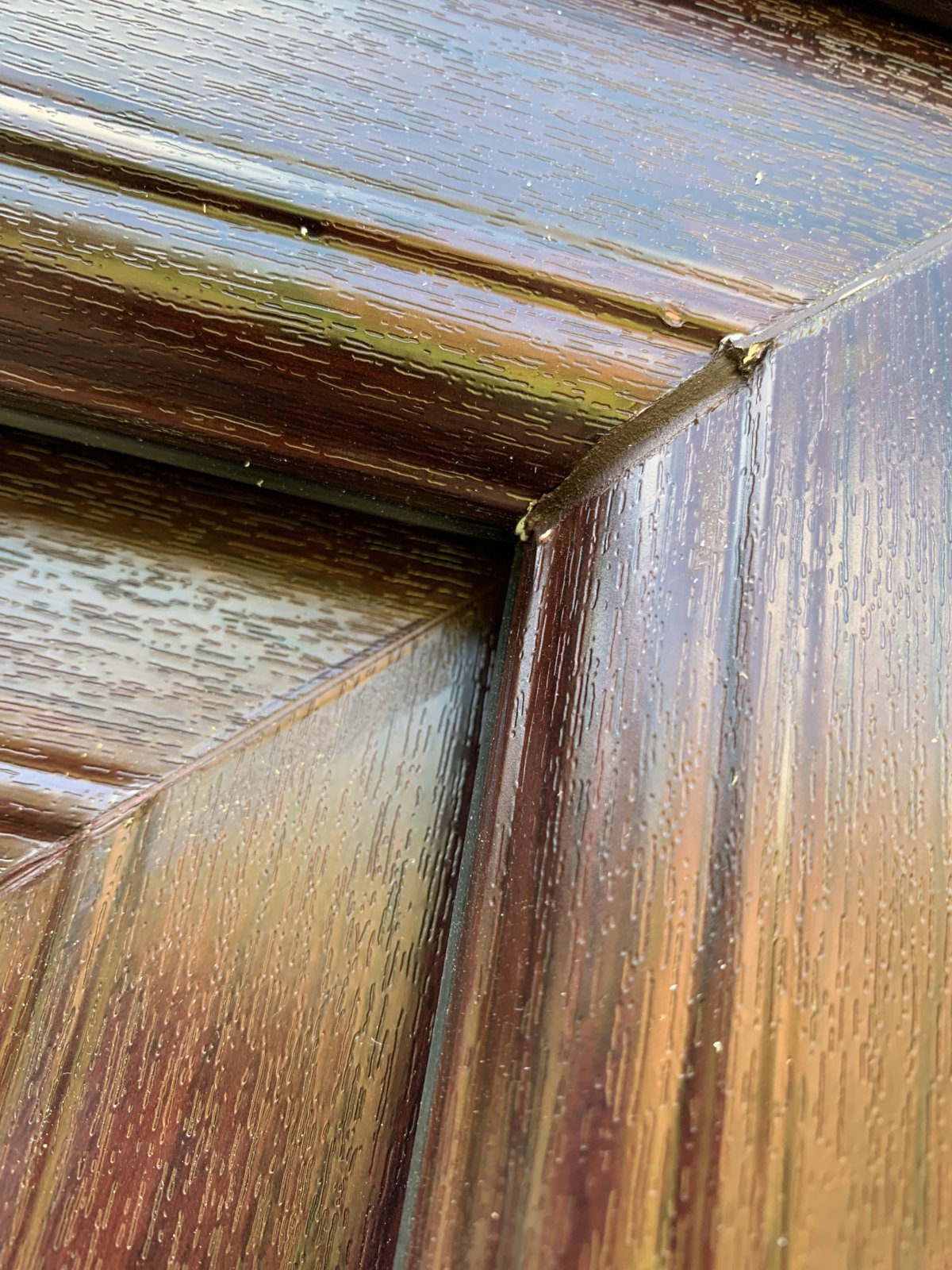

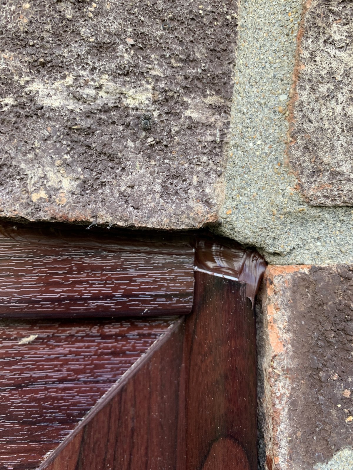

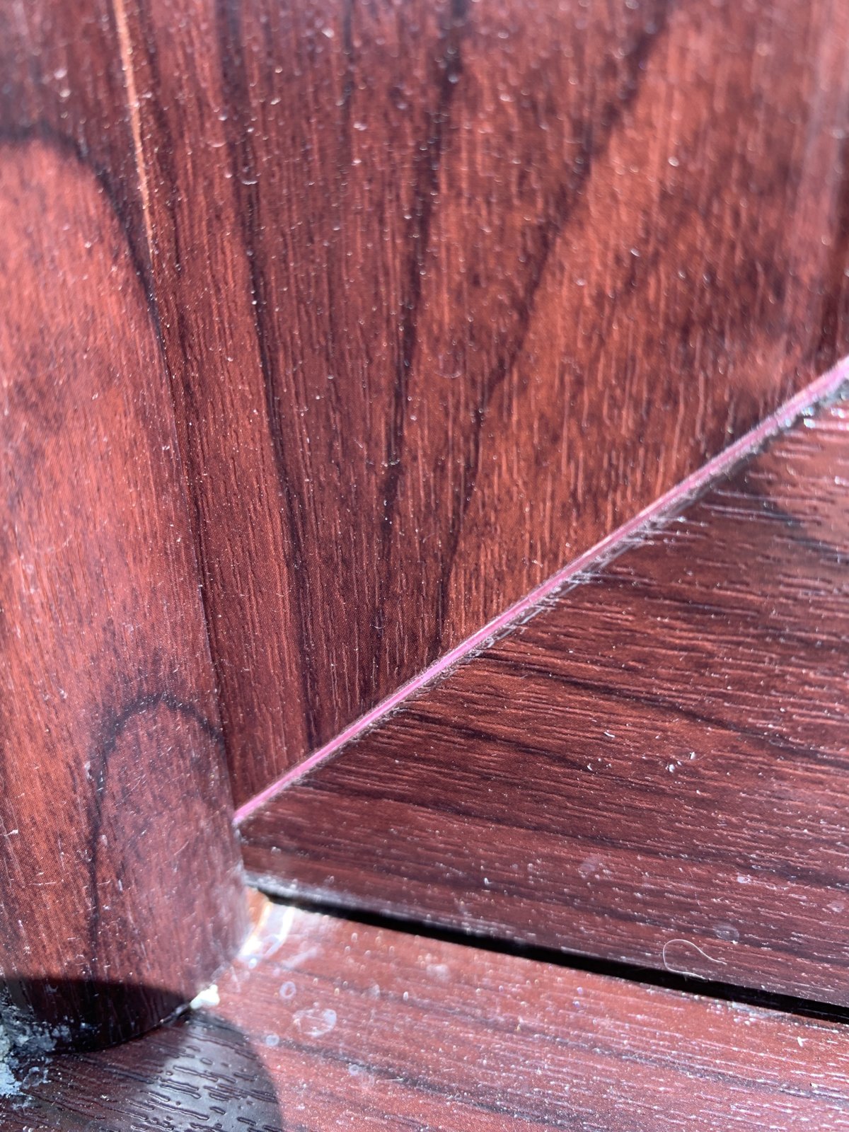

The exterior joins look horrible. It appears some have been painted already, some have what I assume is bad mitre joins and some have white bits showing. I have a 15 year old brown upvc conservatory and the joins all look perfect.

Poor touching up, think they may have even used a mahogany coloured pen not a rosewood one which is darker. One of the welds hasn't been cleaned up very well, the foil looks to have melted resulting in a thcker than normal pen line plus the chip next to it, theres a few fabricators on this board who might give an opinion but in my eyes they're poor quality

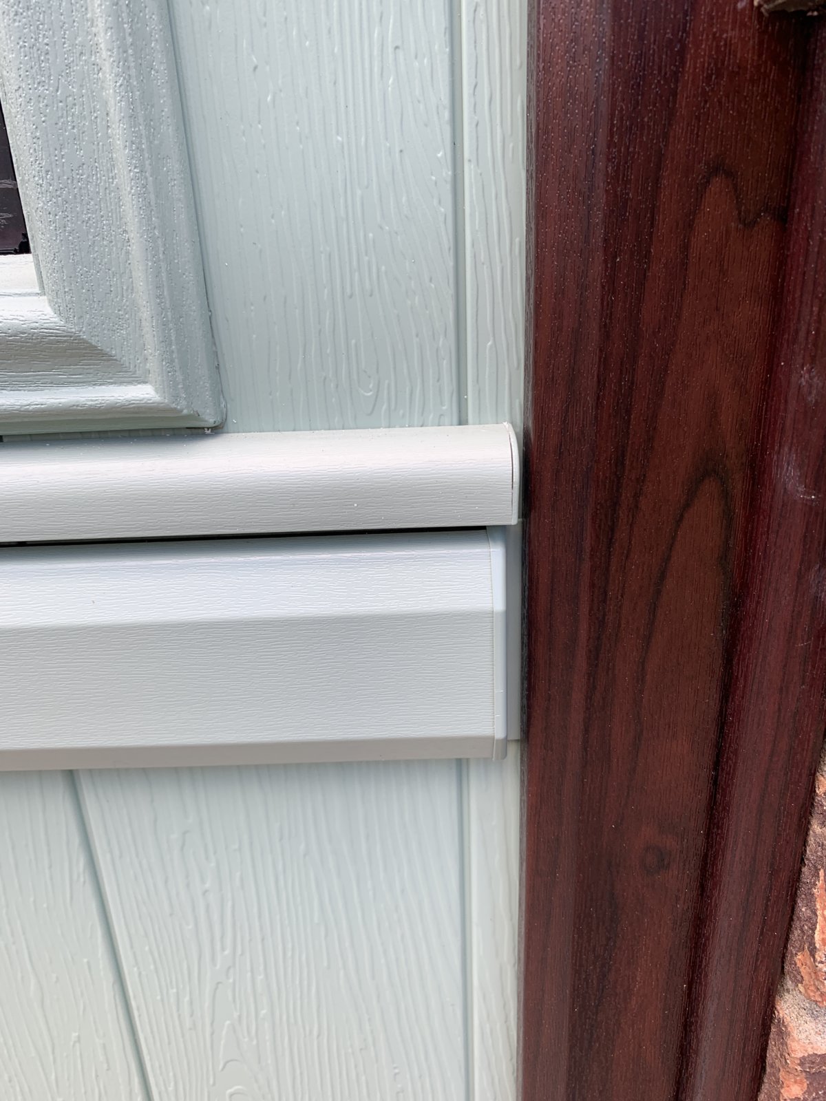

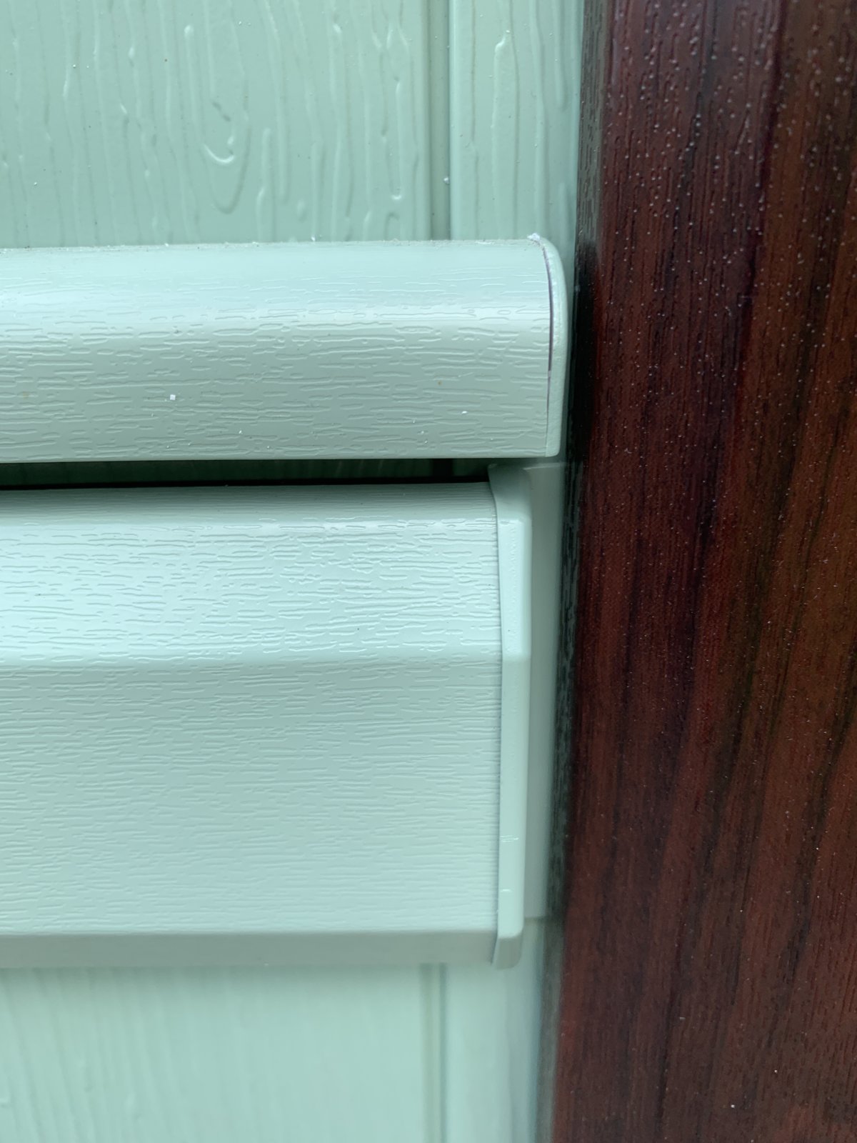

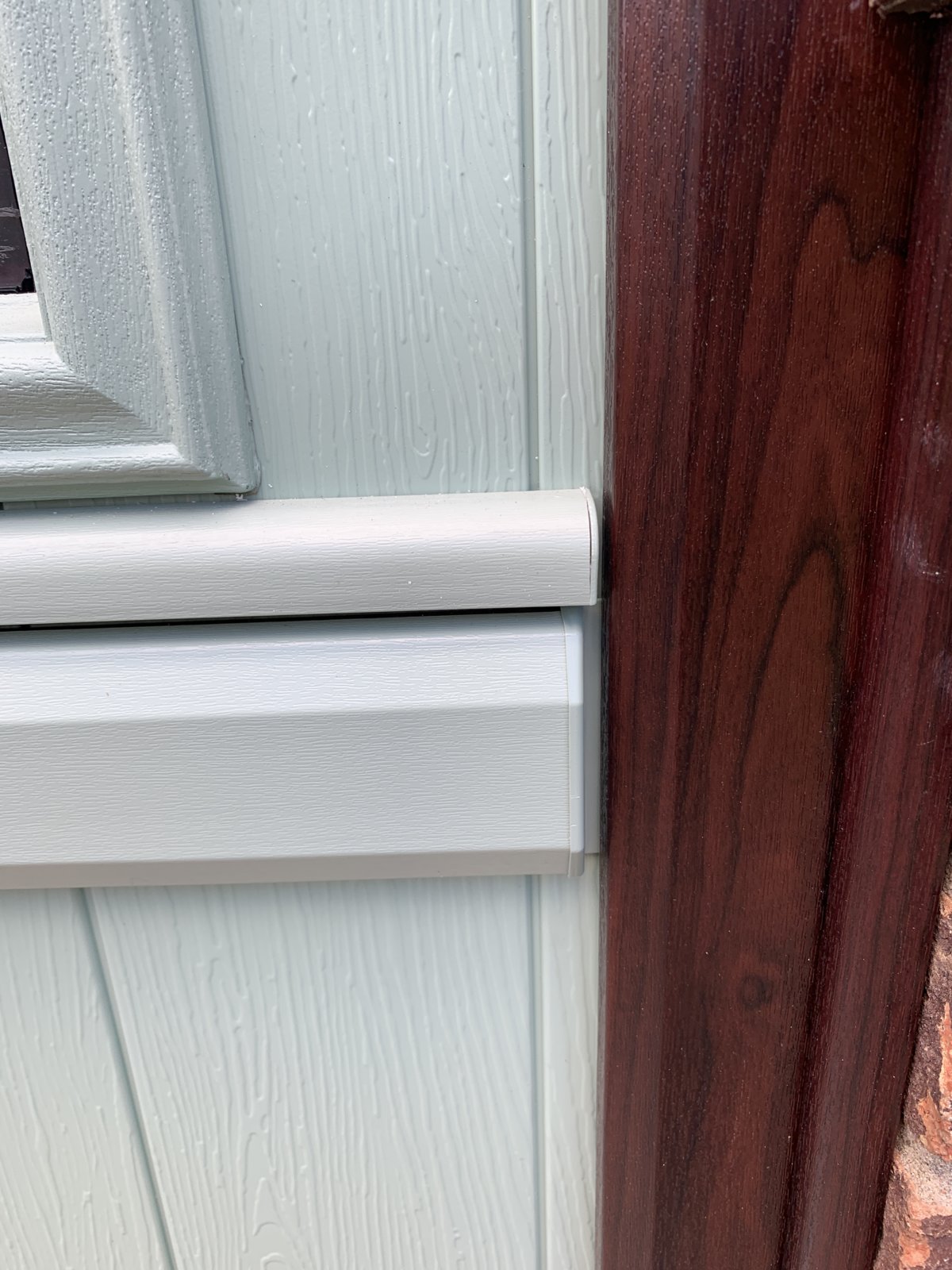

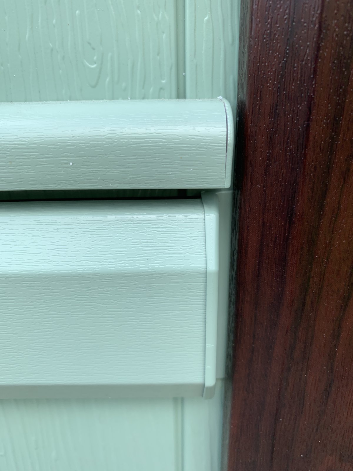

Onto the next some trim......
To me this is bad workmanship.

Back to the door.
Trim along the middle not lining up looks horrible.
Should I be able to see the inside of the plastic mesh/cover. Personally think it’s poor quality.

Not lining up, you mean the length is longer than the one below? What is the other end like, long as well or short, this 'trim' is a drip bar and clips onto button headed screws, it should be loose enough to tap over so long as theres room
The mesh/cover? Not sure what you mean
The top proscenium is longer than the top....bad quality again
You can see the inside if the grinding. It’s basically a plastic clip on cover
